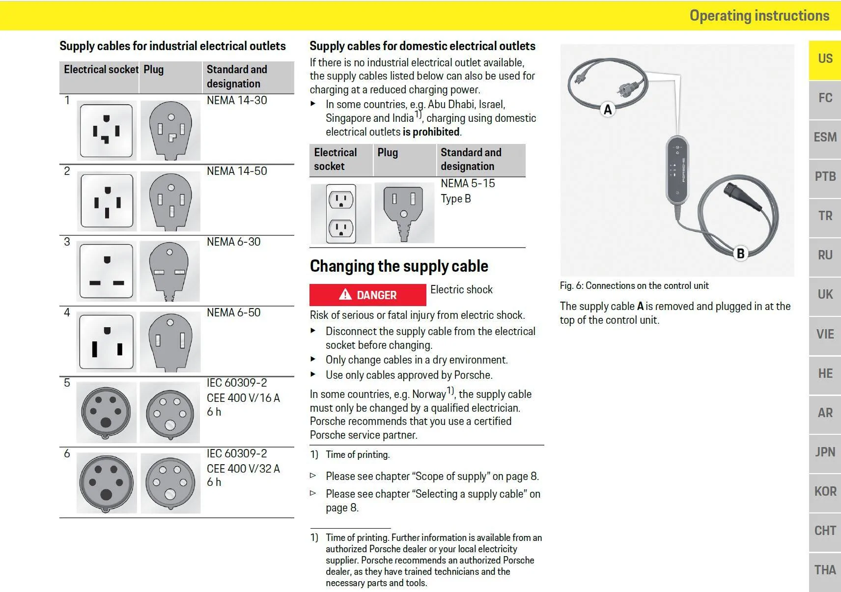

The other supply cable that came with the PMC is the one you need to focus on so that it can be connected to the PMC and the termination point of your 32A supply. If the socket to do this isn't compatible then that's what needs to be swapped out - by an electrician.
Some pictures of what you have - PMC, cables and where it would connect to your supply socket would help.
Also can you clarify if you have the Porsche Mobile Charger, Porsche Mobile Charger Plus or Porsche Mobile Charger Connect (my assumption is Porsche Mobile Charge Plus)?

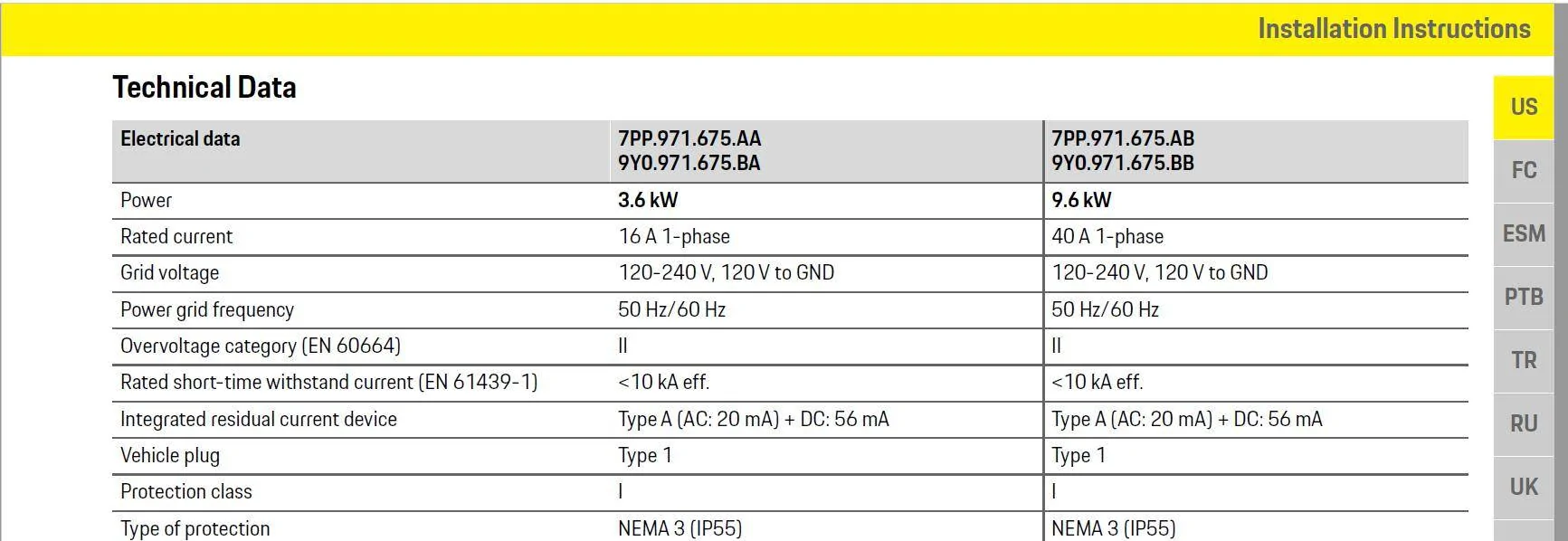

PMC+ - Supply Cable (A in the diagram) Options - you need 32A (6) - if feasible - if you use the 16A then you will be limited to 3.7kW regardless of charger.
Porsche Taycan Home charging issue 1628666399812

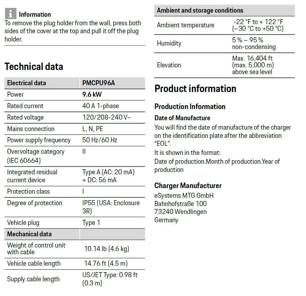

Technical Details (9.6kW - Single Phase)
Porsche Taycan Home charging issue 1628666633746
Porsche Mobile Charger - Specific Part Number (on back of device) for 9.6kW
Porsche Taycan Home charging issue 1628666613123
