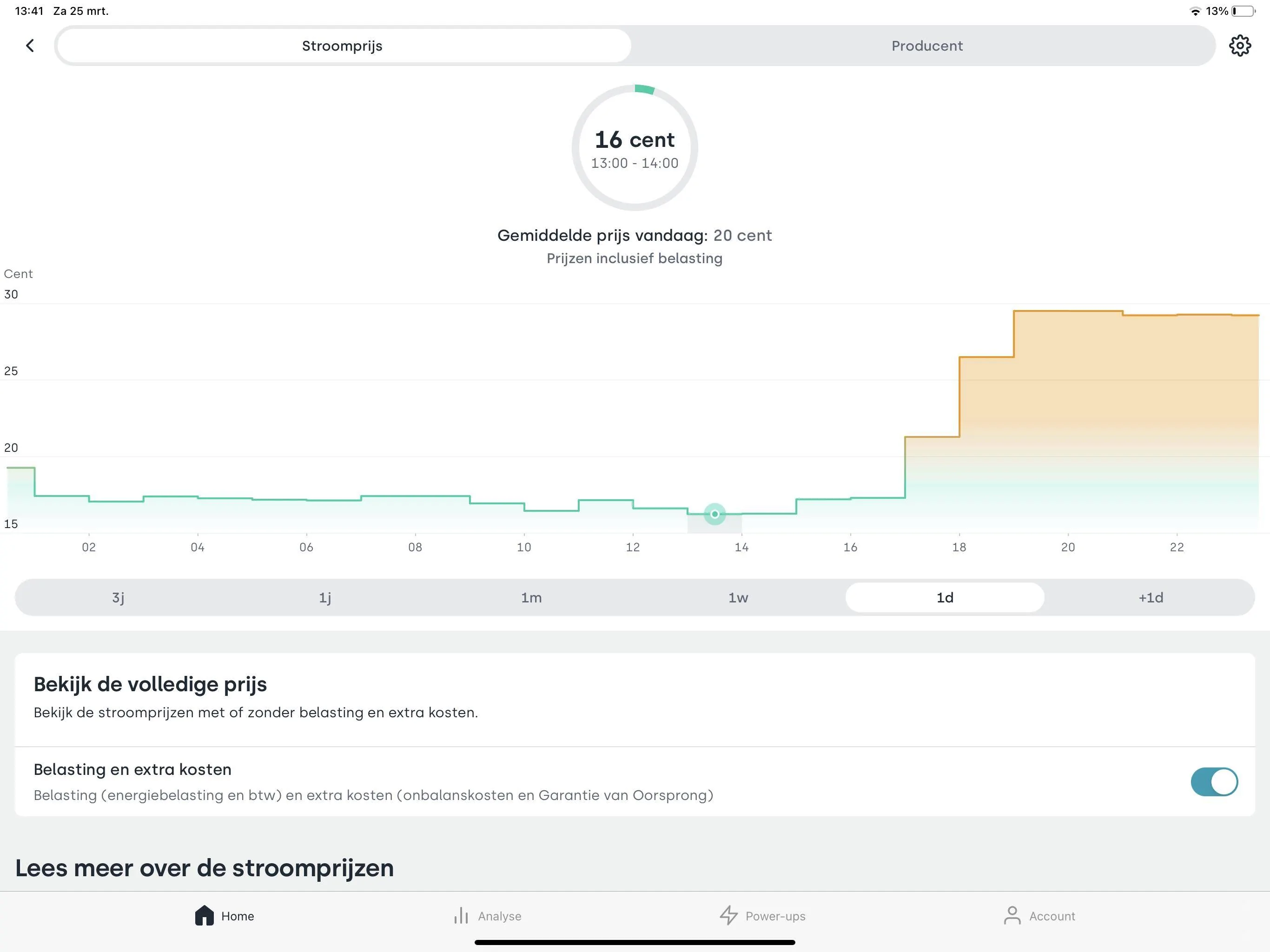

Some price by the hour….

The timing do indeed vary on a daily basis (within a set overnight window) based on grid demand and the subsequent wholesale spot rate. For that reason it is needed. Doing this manually would be unworkable. But this is really no different from the credential sharing that is prevalent within IOT apps.
I’d suggest that what’s happened in the OPs case is that the Bulb platform is still automating this because his credentials are still being shared with their platform. Should be a simple case of revoking them. Worst case scenario all he needs to is change his MyPorsche password so that their platform no longer has access.

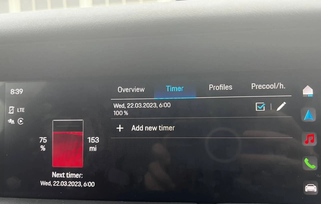

Olibel79
Mar 2, 2023
Porsche Taycan
This one has Porsche very confused.
This is a Porsche Taycan 4S Cross T

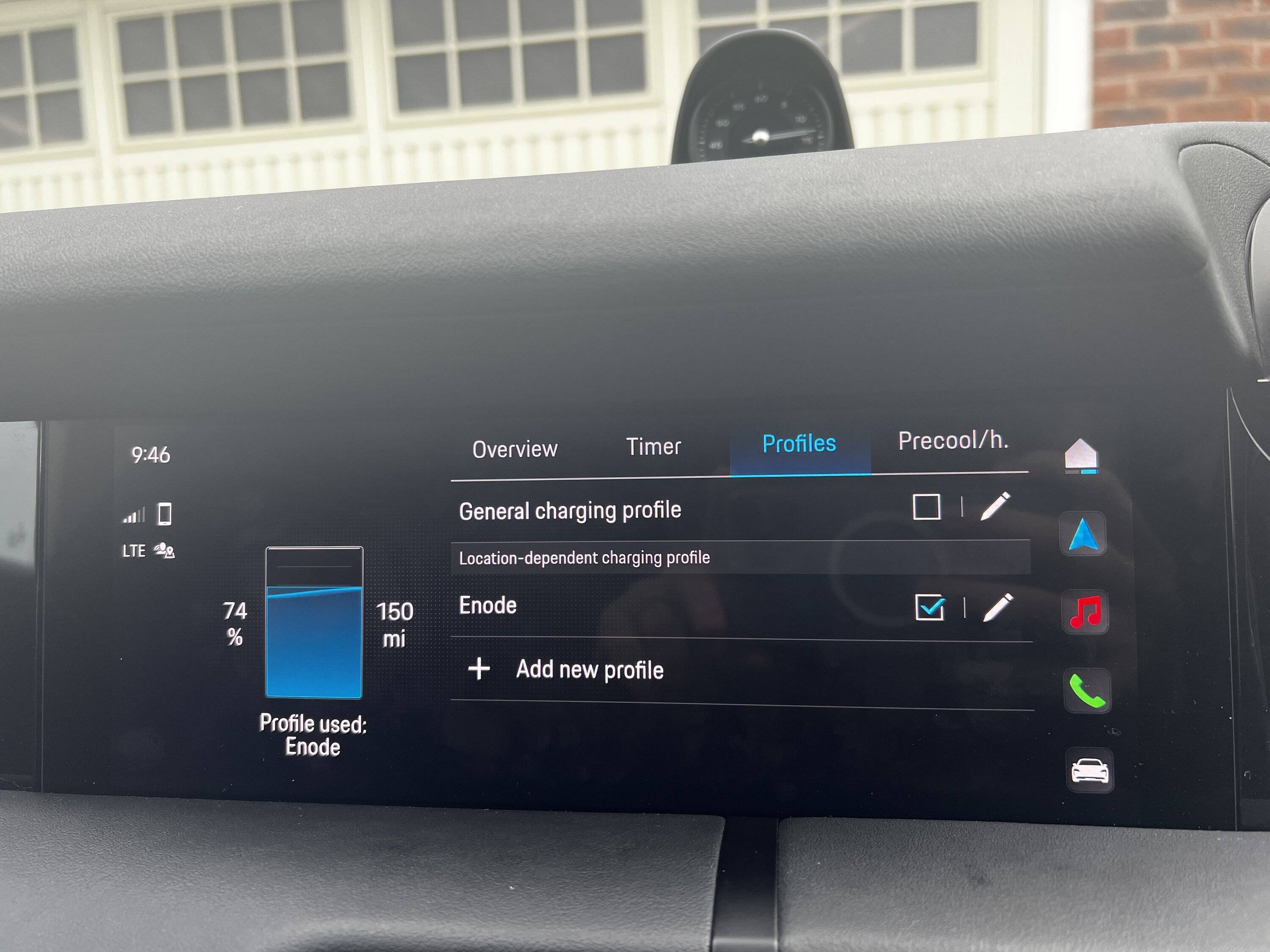

The problem seems to be location based timers and profiles. Even if I delete all timers and profiles as soon as I plug my car in at home and try and do Direct charging a new timer creates itself. Randomly a new profile also creates itself. The profile even gives itself a name and calls itself Enode.
The mystery timer: The timer that creates itself always sets itself to leave in 2 days time which then pauses charging in the car because car thinks I’m not going anywhere for 2 days.
The Phantom Profile: The profile always creates itself and always calls itself Enode which is a location based profile. Even if I try and delete the profile it will always comeback. Even more annoyingly even if I don’t delete the profile the preferred charging times on this profile are constantly changing themselves.

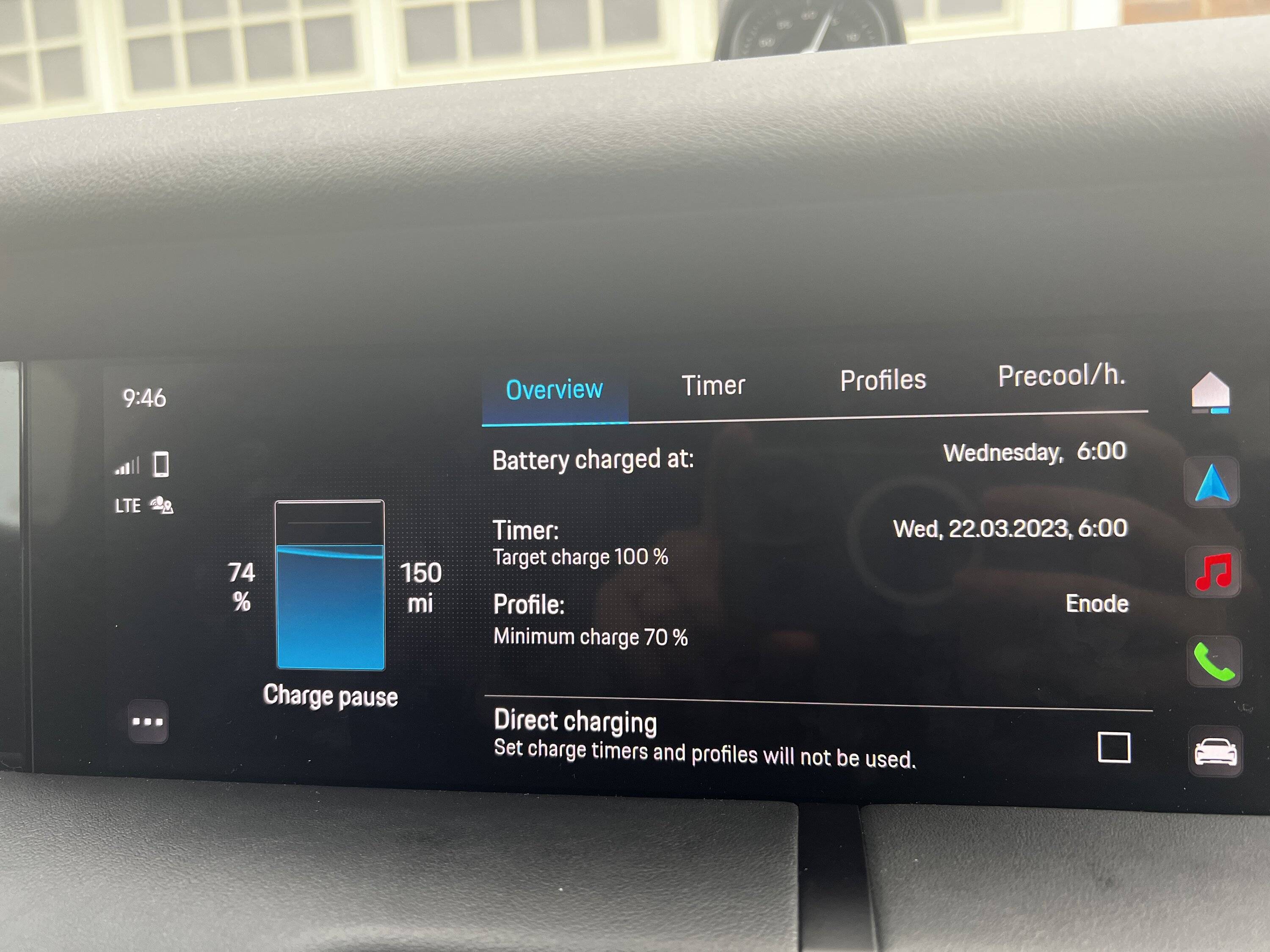

On the advice of Porsche I was told to do a complete factory reset of the vehicle which I have now done 3 times and the problem still exists. They also hoped that recent server updates would have fixed the problem but the issue still exists.
The only time I can get a charge at home seems to be in the early morning if I set my wall charger to charge 2am - 6am for example. If I set the schedule to come on during the day the timers and profiles kick in and pause charging.
When putting the car into direct charging mode I always thought this was supposed to override and timers and profiles? This car doesn’t override anything and is controlled by the mystery timer and the phantom profile Enode.
Any ideas?

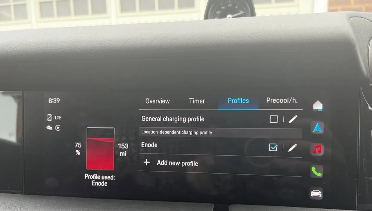

Timer and Profiles issue UPDATE!!!!
Good news the problem is now resolved and timers and profiles all working perfectly and not randomly creating its own anymore.
The resolution was to unlink the car from the Bulb EV app. As someone previously mentioned ref the OVO Energy app creates profiles and timers it seems Bulb must use the same platform and was causing the issues on my car.
Many thanks to those that replied and provided this solution its much appreciated as this was a bit stressful especially knowing I was having a big journey the next day while trying to charge.
