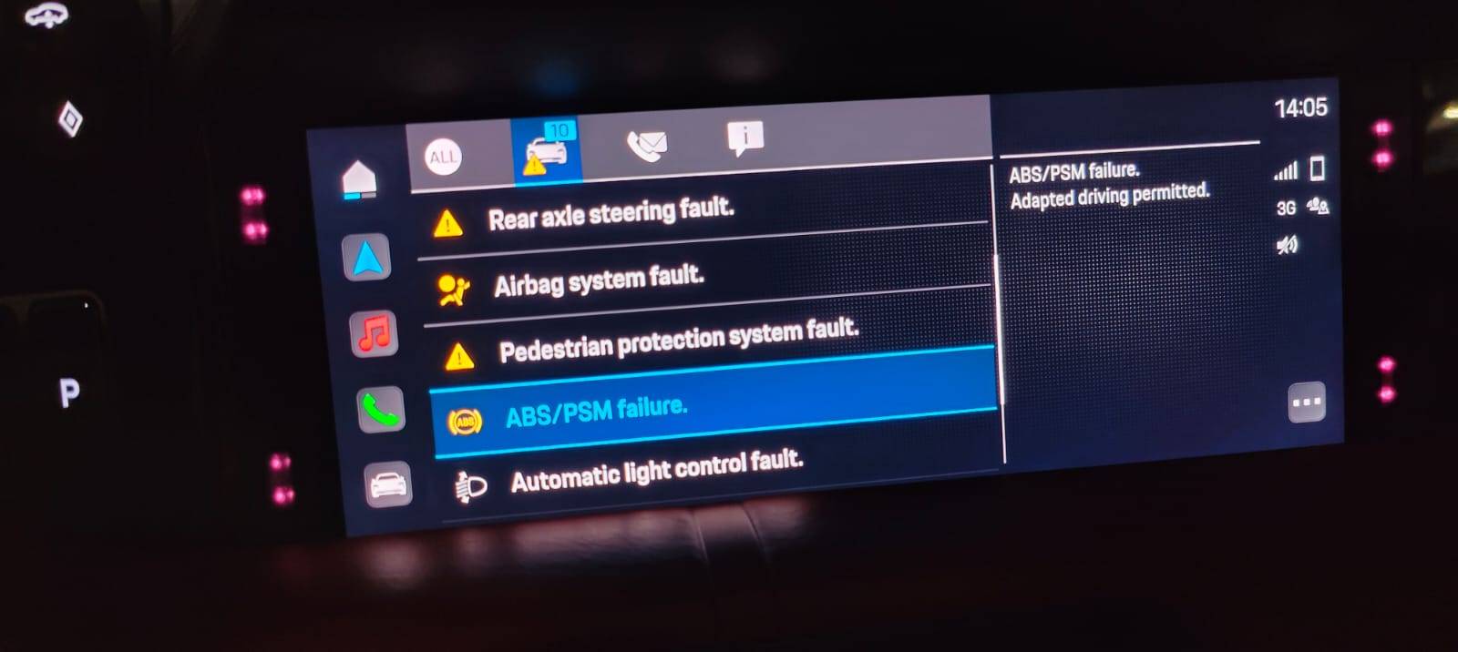

Hi,
How to delete pop-up warnings which started today before driving?
Warnings:
Automatic light control fault
WBA restricted
All-wheel system fault
Differential lock failure
Rear axle steering fault
Airbag system fault
Pedestrian protection system fault
ABS/PSM failure
Chassis fault

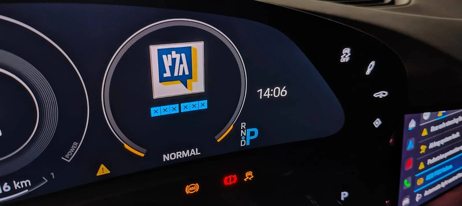

Thank you Dee.
I followed your advise, It deleted from the wheel dashboard, but still has a warning sign.
The warning list can't be deleted.
Do you know a method to delete all warnings?

Just ignore and sleep on it.
Check again tomorrow.
If you want to find out sooner: lock the car for 15 minutes, keep the key at least 10 meters away from the car and check again.
If those warnings arent't gone, you'll have to contact your dealer.
Good Luck!
