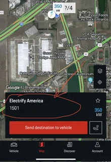

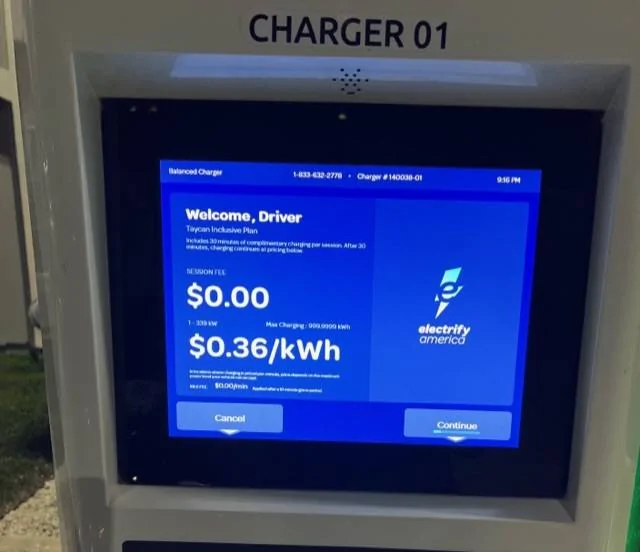

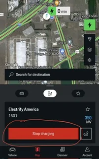

Couple of tips I have read either here or on youtube:Thanks! Its active and plug & charge is selected. They had me on a conference call and said it had to be a server error that wasn’t recognizing the Porsche plan as payment.
When you plug the cable into the car, hold the EA plug on your Taycan charge port so it doesn't droop during EA's "connecting to the vehicle", "payment processing", and "initiating charging" phases. Report for some EVs is that if the initial wired connections between charging plug and vehicle are intermittent or loose at the start, the session will not succeed.
If the issue is that you get "payment declined" message, or any other cannot start the session, try the other cable on same station, if the station has 2 cables. Sometimes just one cable is the problem.
If the above and/or switching charging stations do not work, deactivate plug and charge in the PCM and see if you can start the session with MyPorsche app.
If you cannot get either plug and charge or MyPorsche app to charge, see if you can use a credit card to pay for charging. (You must deactivate plug and charge to test this.) If the car charges with credit card as payment, then the problem is on Porsche's end.
