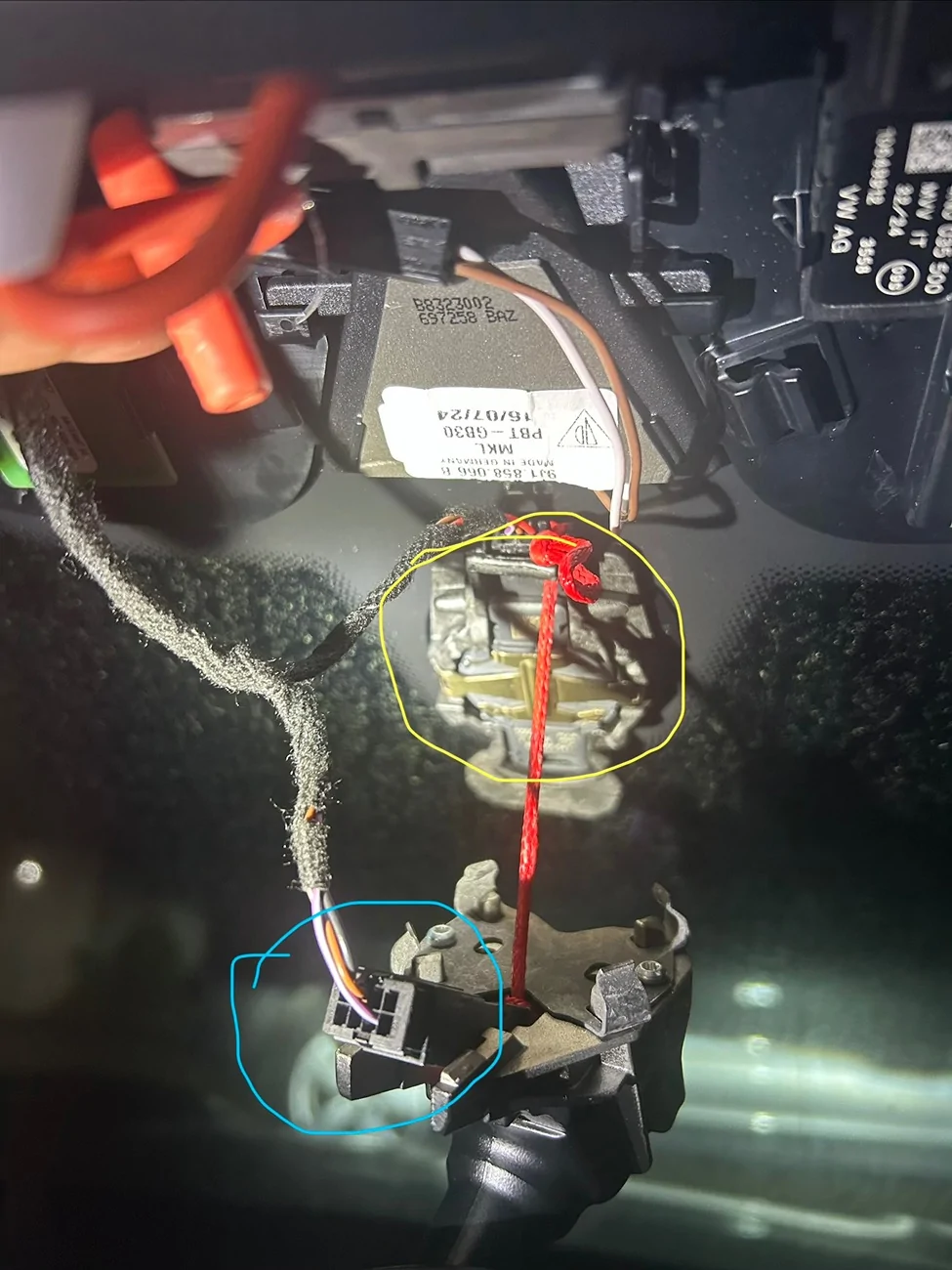

Hello again, your instructions worked well, NOW we have another issue , the wires that go into the connection at the top above this mounting , we have followed all instructions about pushing the wires upwards and then the male section of the 2 part plug will seperate , we have tried baby times and it will not move, we don’t want to pull at this by the wires, any ideas please

Hello again, your instructions worked well, NOW we have another issue , the wires that go into the connection at the top above this mounting , we have followed all instructions about pushing the wires upwards and then the male section of the 2 part plug will seperate , we have tried pulling at this many times and it will not move, we don’t want to pull at this by the wires, any ideas please

You have to support the wire with your left hand and pull out using your right hand (see video). This is to disconnect the mirror power plug - assume you are trying to do that.
