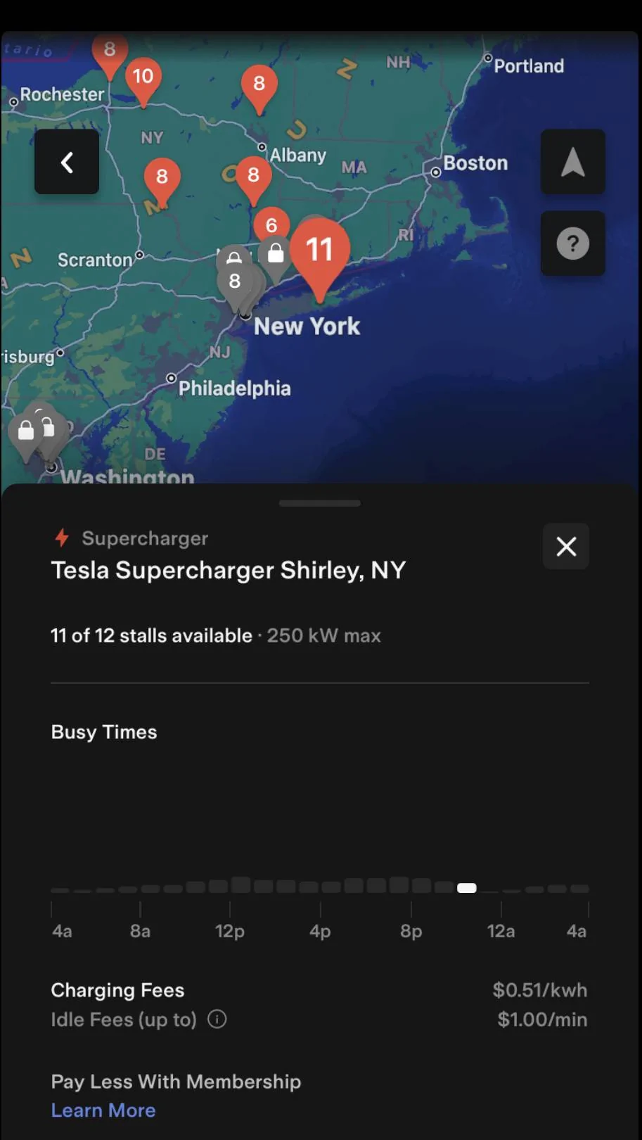

Any idea how to see which Tesla supercharge can charge other car using j1772 in the US?
I upload a few App but I can't see any option to filter it.
the Tesla app will show you Tesla Supercharger locations that curently have the required "magicdock" retrofit
tap - charge my non-Tesla EV
a map appears - and will show you Tesla Supercharger Locations that currently allow charging of your Taycan
the adapter they are providing is called the "magicdock" - and it must be physically installed by Tesla at a site for that site to support charging non-Tesla's
I personally would prefer the ability to purchase a magicDock adapter for me to carry in my vehicle - this would allow me to use any Supercharger location without the need for tesla to retrofit the stations - Tesla could still maintain control of which sites support non-Tesla's via the existing requirement to start a charging session via the app (i.e. they still have control if they do not allow charging at certain sites via their app)…
it is essentially a CCS adapter - which is the connector type your Taycan uses for FastCharging
J-1772 is used for North America AC "slow" L1/L2 charging - and is a separate "thing" from CCS and plays no role in fast charging
the Tesla app's built in map shows current locations you can use.
