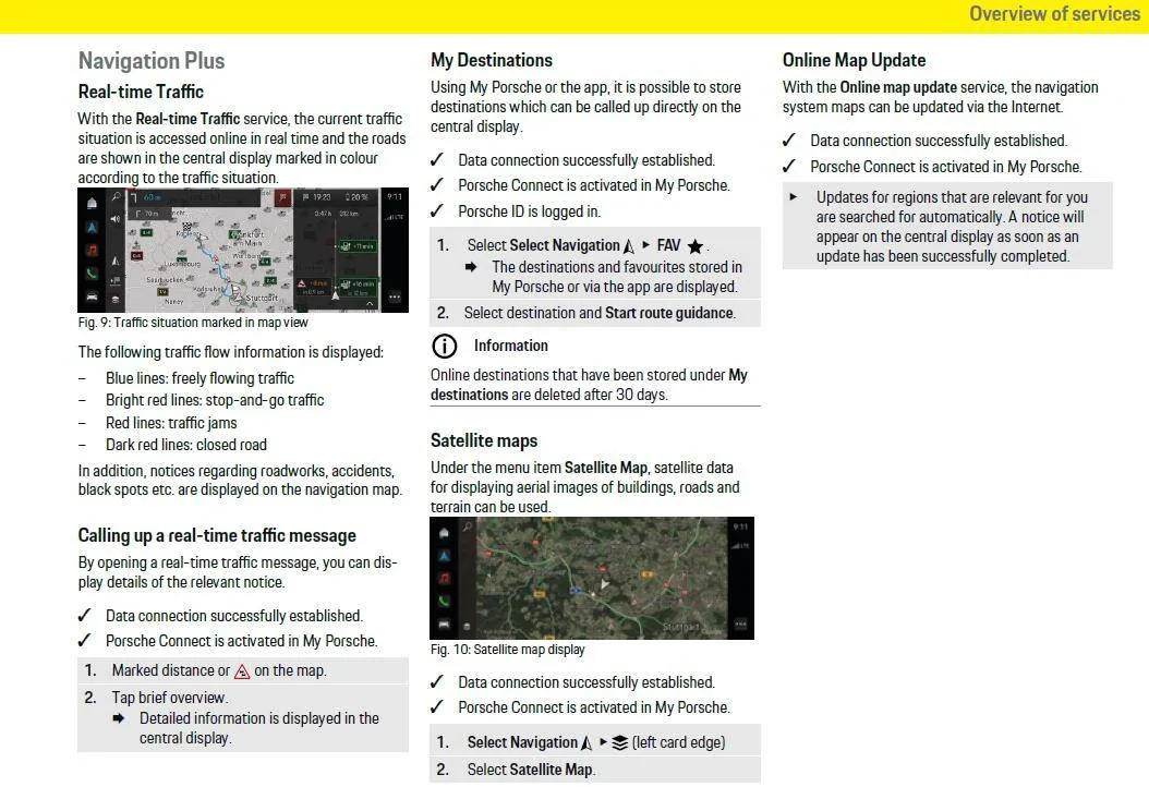

Have you checked your Porsche Connect Services (Web Site) to ensure all are active - specifically Navigation Plus -
Porsche Taycan Live traffic information on Navigation System stopped working 1680085363581
it should be active for 3 years I think but just in case.
Other things to check:
Porsche Taycan Live traffic information on Navigation System stopped working 1680085530846
