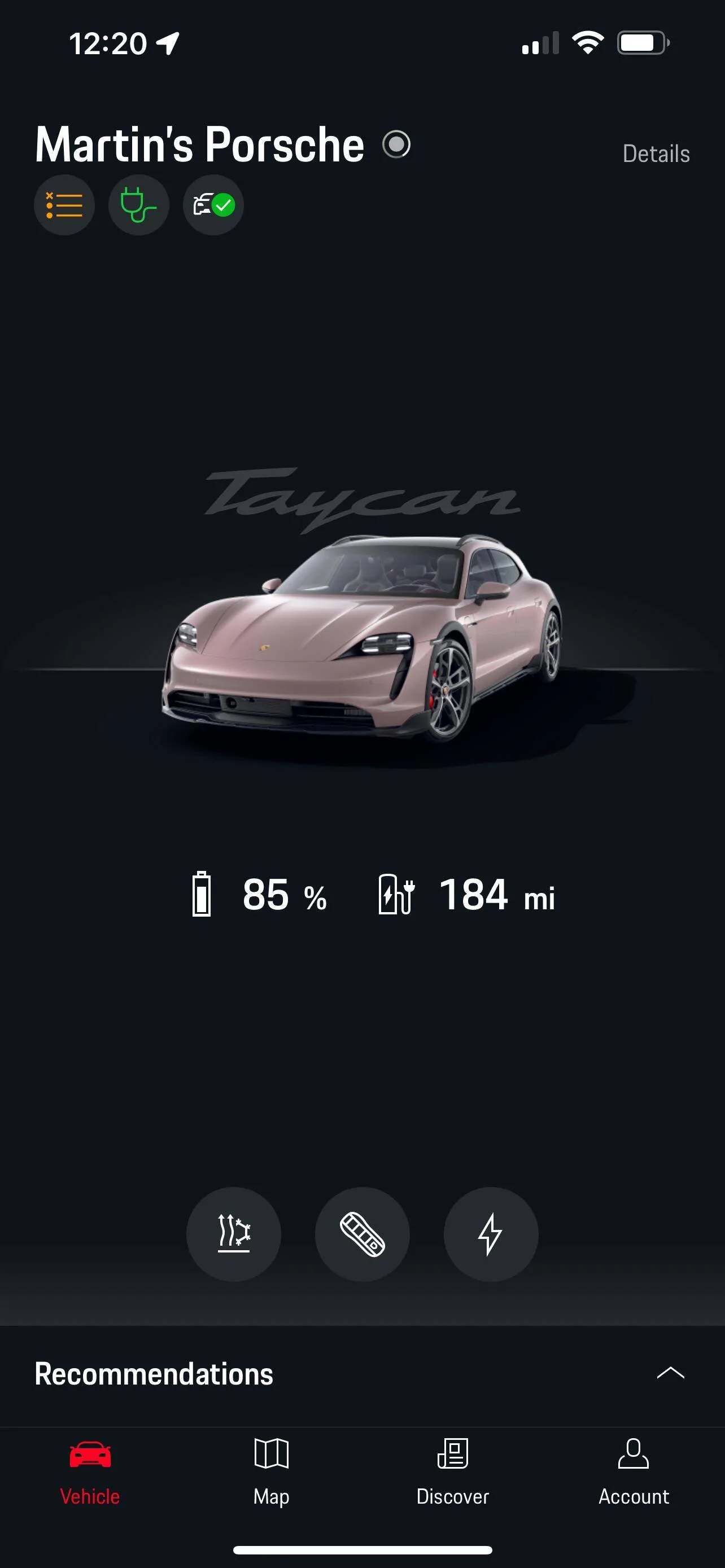

Edited.... Yep, achieved, it was only 3.5kW/mile. I think the furthest I did was something in the region of 50% at 160 something, I thej charged it overnight, and ended up doing two runs to my nearest dealer in Colchester. (I live in the countryside)
Don't get me wrong, most of my time was spent at 40mph, with very little braking, an regeneration turned off. No hard acceleration, heating switched off.
(It was before the cold snap!)
I took a video of the information thing after getting to Jardine Colchester, just because I knew people would doubt me! (It think it was a 23 plate.)
Don't get me wrong, the most I'm getting outboard my turbo is at the 260mile mark, but it's far too cold to be buggering about with no heating etc. And it's a turbo, so it's cruel not to drive it like one! (I was hitting 280 during the summer)
