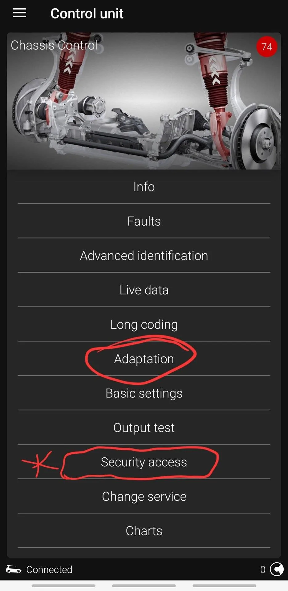

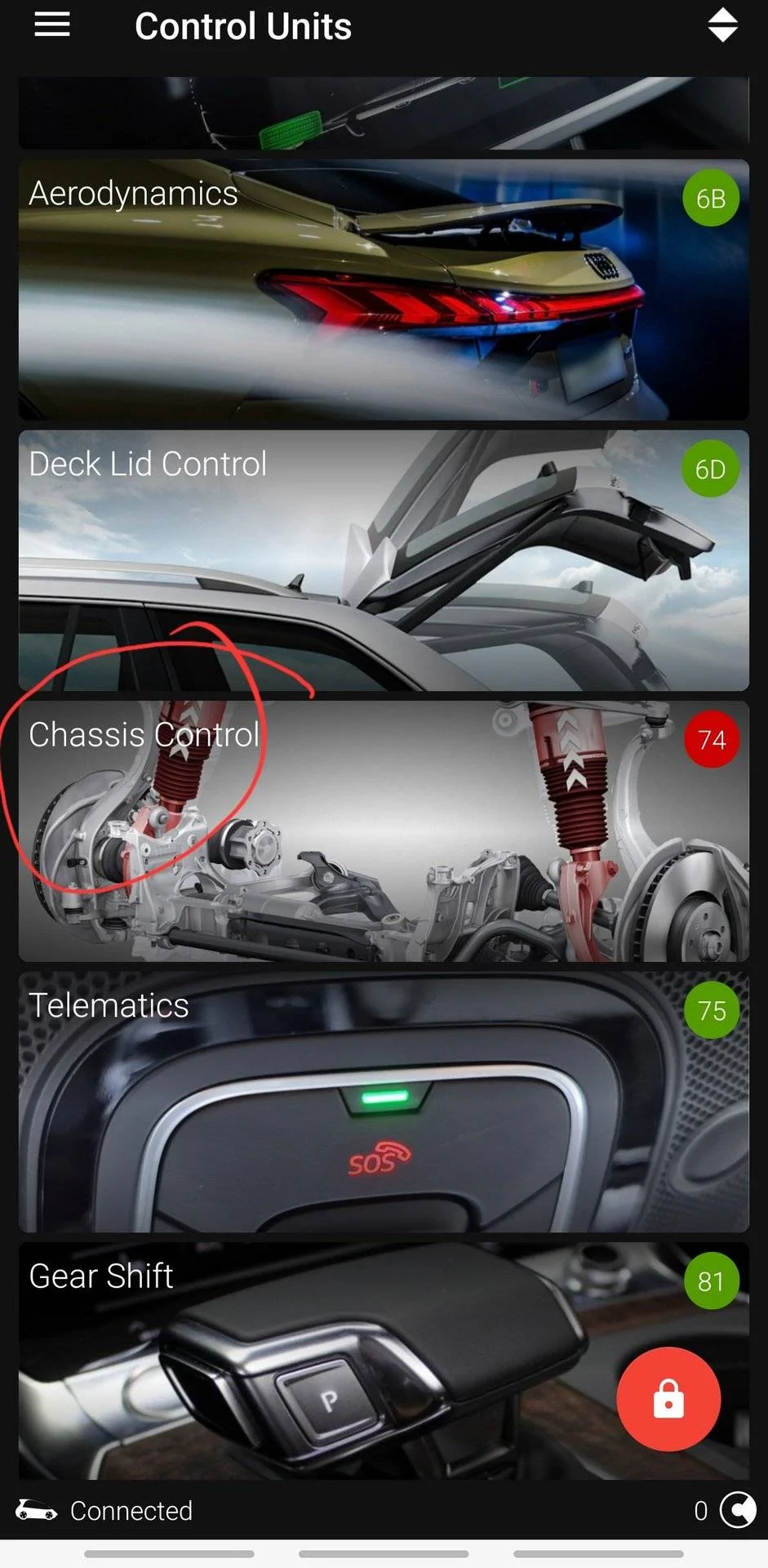

Once completed you can go to into different control units.
Find the Chassis Control then click on it.
Porsche Taycan Lowering the E-Tron GT with OBDeleven screenshot_20230707_182626_obdeleven-vag-jpg

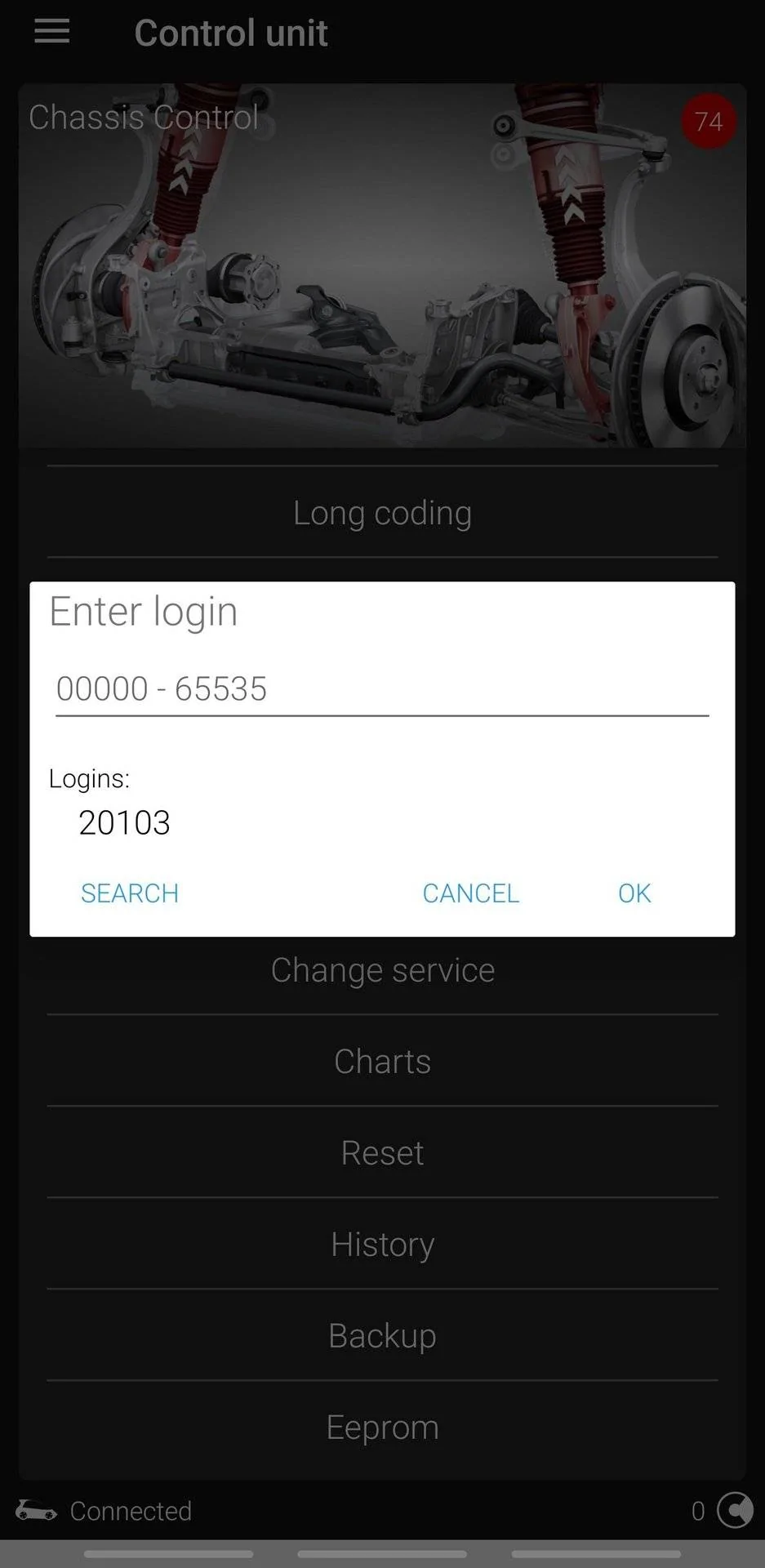

First click on Security Access before getting into the Adaptation section where you make your adjustments.
Porsche Taycan Lowering the E-Tron GT with OBDeleven screenshot_20230707_182639_obdeleven-vag-jpg
Put the code 20103 onto the Login.
If you don't do this step, you will get an error when making the adjustments.

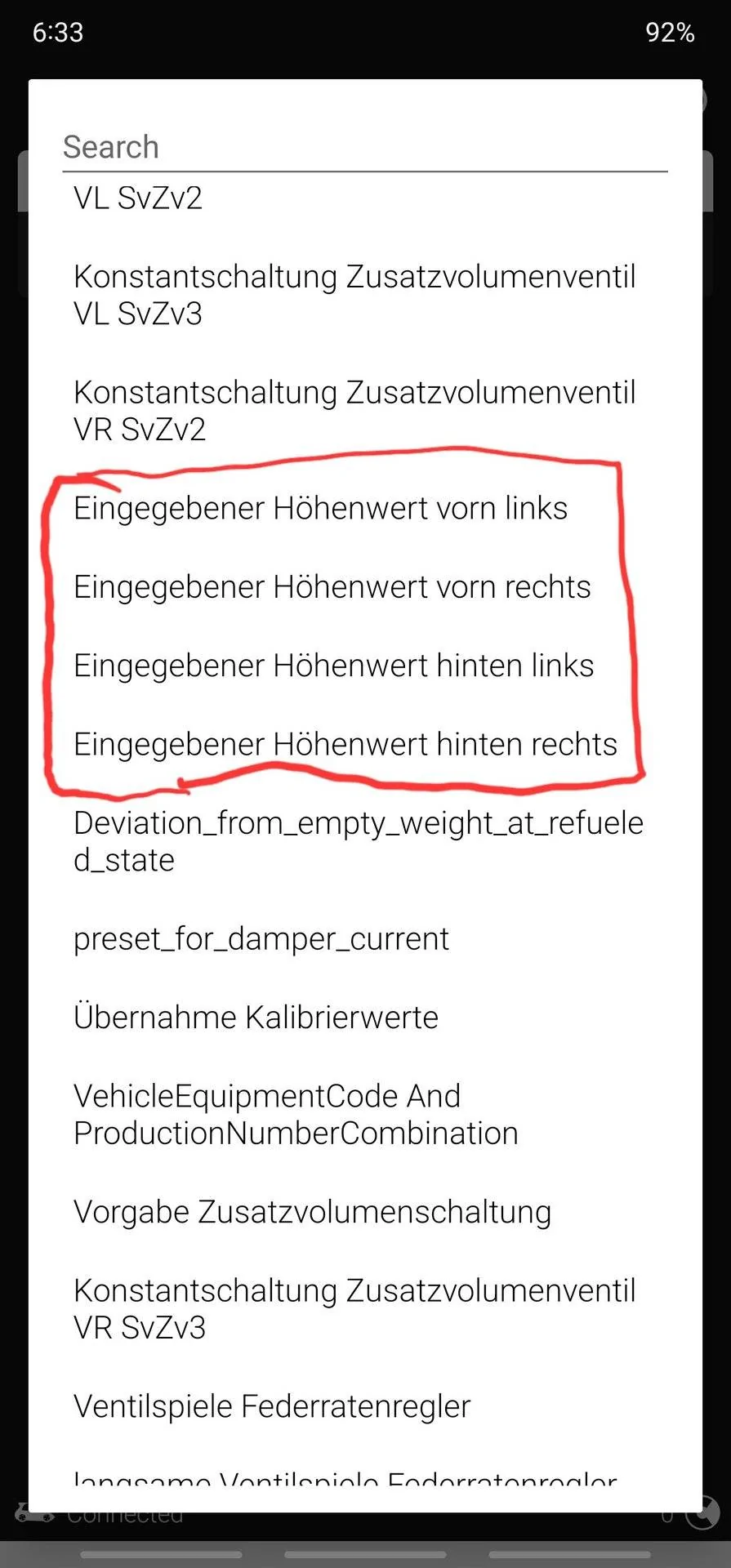

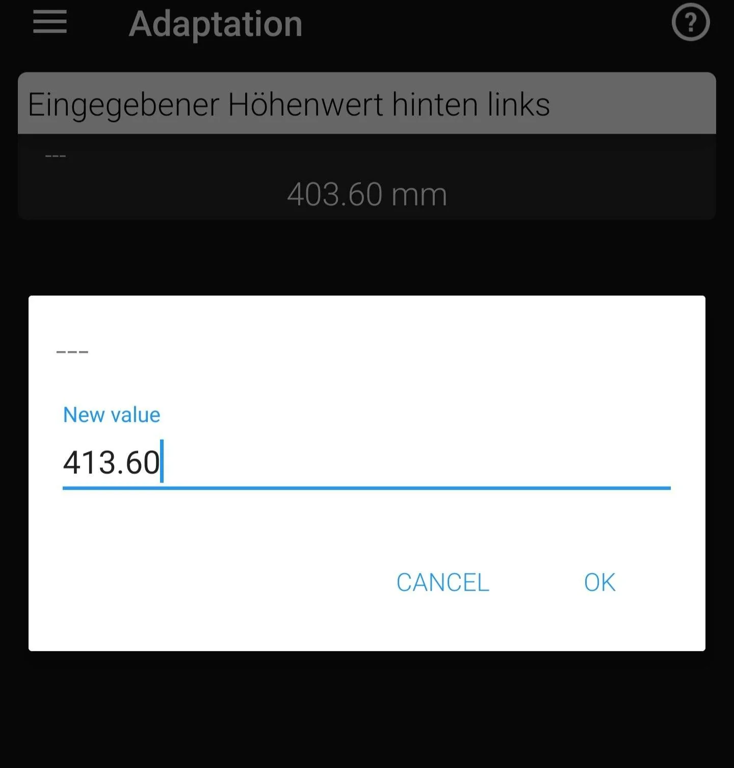

After the security login, now you can go into the adjustments for the suspension.
You adjust each wheel. Here is the translation
Eingegebener Höhenwert vorn links
Entered height value front left
Eingegebener Höhenwert vorn rechts
Entered height value front right
Eingegebener Höhenwert hinten links
Entered height value rear left
Eingegebener Höhenwert hinten rechts
Entered height value rear right
Porsche Taycan Lowering the E-Tron GT with OBDeleven screenshot_20230707_183328_obdeleven-vag-jpg

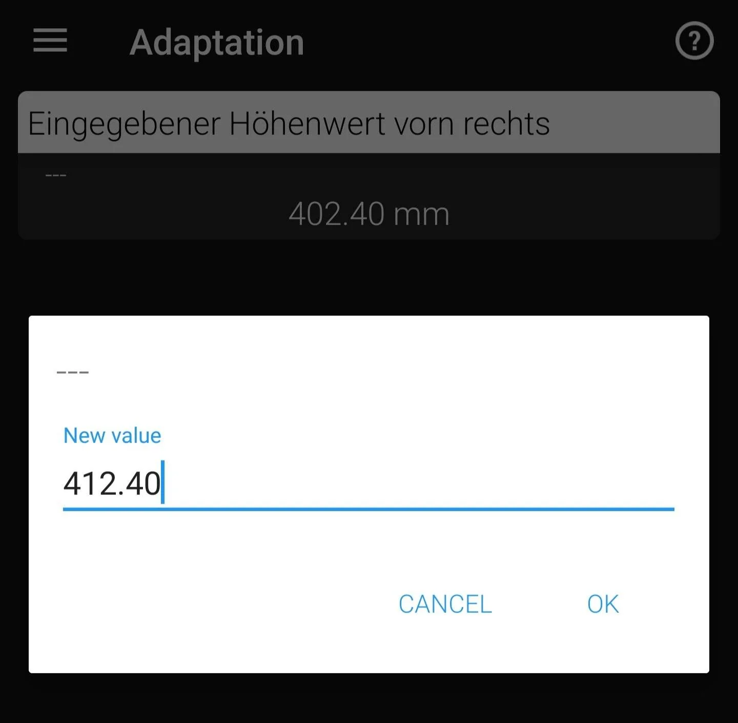

Each wheel has a different value which you must be adjusted up.
I wanted to lower by 10mm.
To complete you hold down the green check mark on each wheel.
Porsche Taycan Lowering the E-Tron GT with OBDeleven screenshot_20230709_074202_obdeleven-vag-jpg
Porsche Taycan Lowering the E-Tron GT with OBDeleven screenshot_20230709_081028_obdeleven-vag-jpg

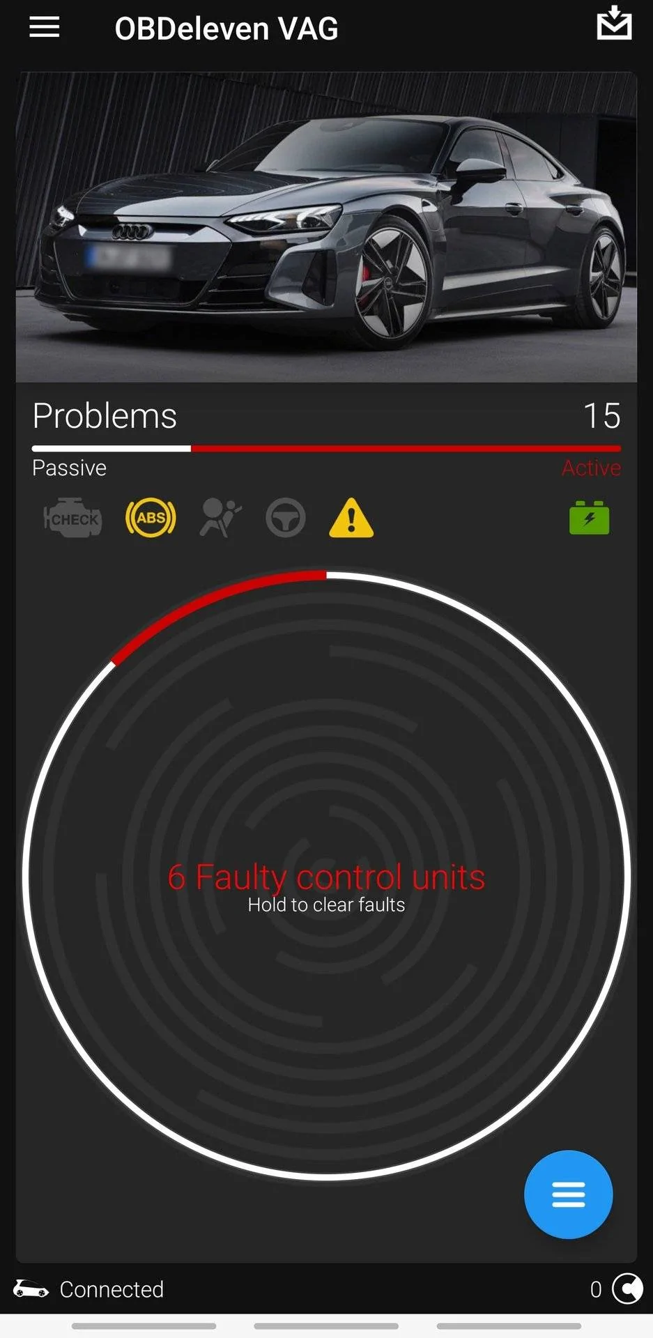

Once completed you go back to the main page and clear the Faults by holding down the ce ter button. This clears all the faults.
Porsche Taycan Lowering the E-Tron GT with OBDeleven screenshot_20230709_084430_obdeleven-vag-jpg
Once the faults have been cleared, turn off the car, remove the OBDeleven from the port, close the door.

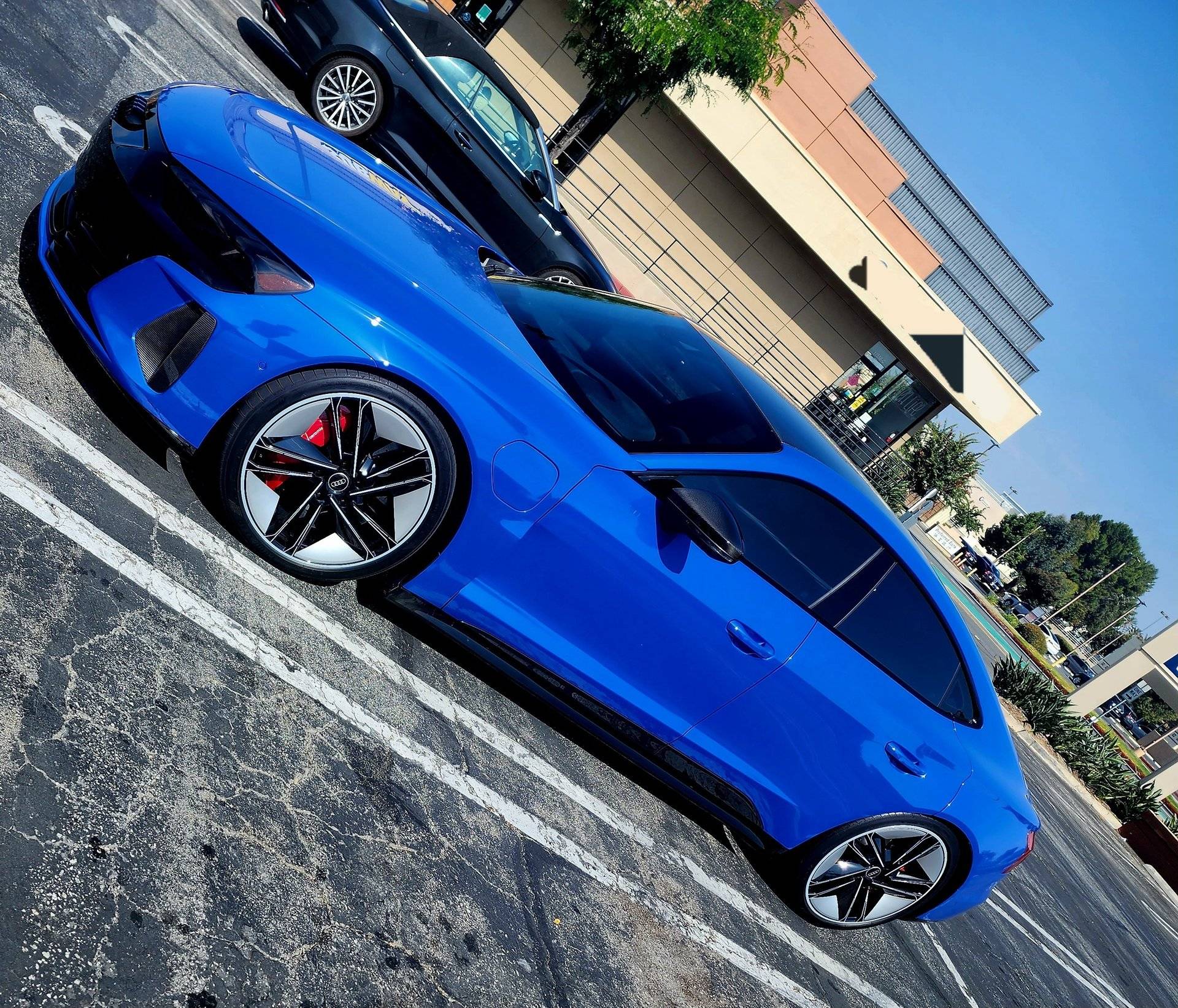

After a 10mm drop, this is what it looks like in Efficiency mode. No wheel gap
Porsche Taycan Lowering the E-Tron GT with OBDeleven 20230709_095555-
You feel the road a lot more. Compression is very noticeable, but the car is planted, less body roll, way better handling, more compliant.
Its less rough in Comfort mode, but in Efficiency you really hear tland feel the thumps in uneven roads.

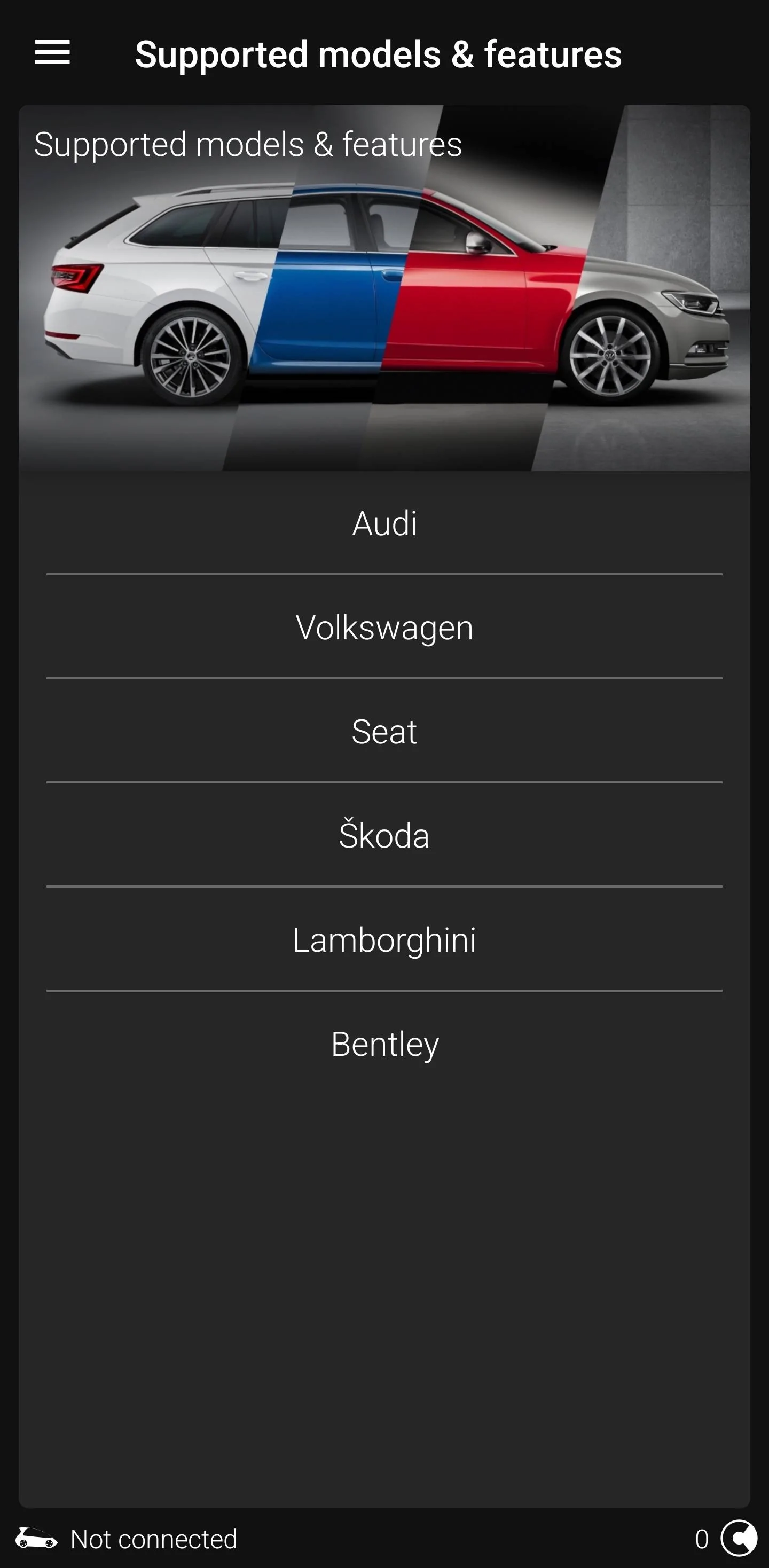

There are credits for other trivial settings that don't apply to me. Like the windows lowering more when you unlock the door.
I wanted to lower my car, nothing more.
I also looked before and it doesn't apply to Taycan
Here are the cars it does work on.
Porsche Taycan Lowering the E-Tron GT with OBDeleven Screenshot_20230712_141045_OBDeleven VAG
