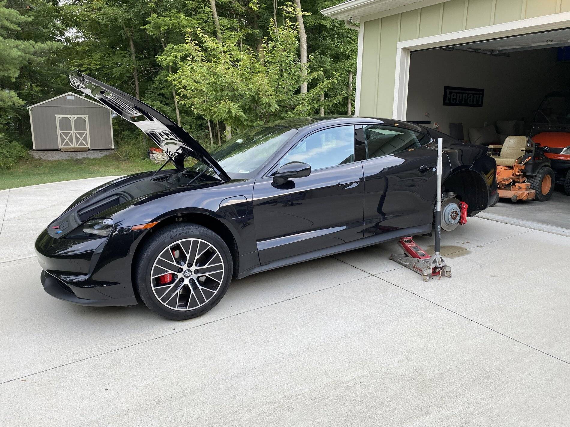

Silly things……picked up the car at 5:15 on Friday. Drove it home and then to the golf course. Got out of the car and heard a hissing noise…..nail in the tire. Here’s how it’s sitting now…..

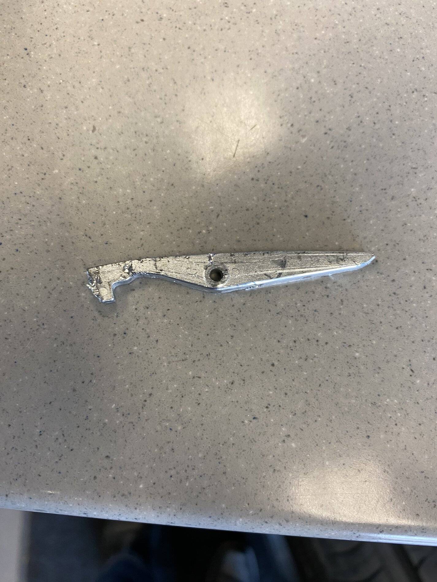

Well….here’s the culprit. Got it fixed. Now time for 2 days on the road and ~600 miles…..
