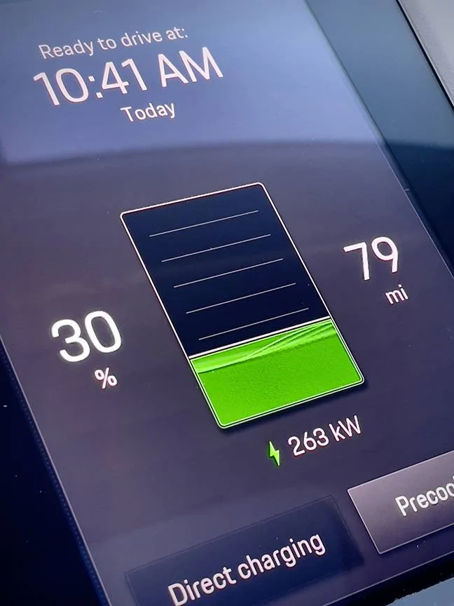

The fastest I've gotten at an EA 350kW Ultra Fast Charger was 263kW.
264kW here ?
Btw, do clear some confusion in this thread:
The standard battery will never get close to 270kW as it's limited to 3C charging rate just like the PB+ meaning 3C = 3x battery capacity max. On a pb+ that's 3x 93kwh (theoretical 274kW). On the PB it's theoretical 237kW I believe (79kWh battery?)
