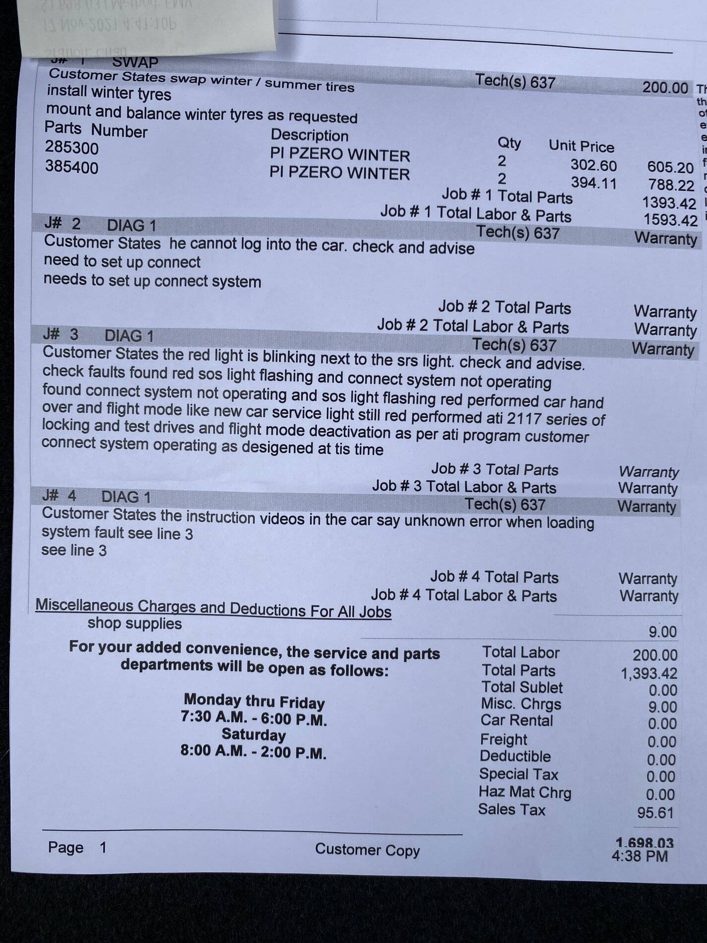

I returned to the dealer to have Winter tires mounted on 17-Nov. After 4 days, I was still unable to login. When writing up the work order to mount the tires, I asked that they check into the reason that a small red light next to the SOS button was blinking. It turns out that the red blinking light and the failed login attempts were related. The tech executed a complex series of steps that required the car to be parked outdoors (not in the service building). The entire process took several hours. Once the blinking red light changed to a steady green light I was able to login. You are given a choice to require a login every time the car is started or just do the login once during the initial set up. I chose the one-time login option. However, I am still required to enter the 4-digit PIN that I had entered into the My Porsche app every time I start the car. Although sometimes I am just asked to press a "Confirm" button instead of entering the PIN.

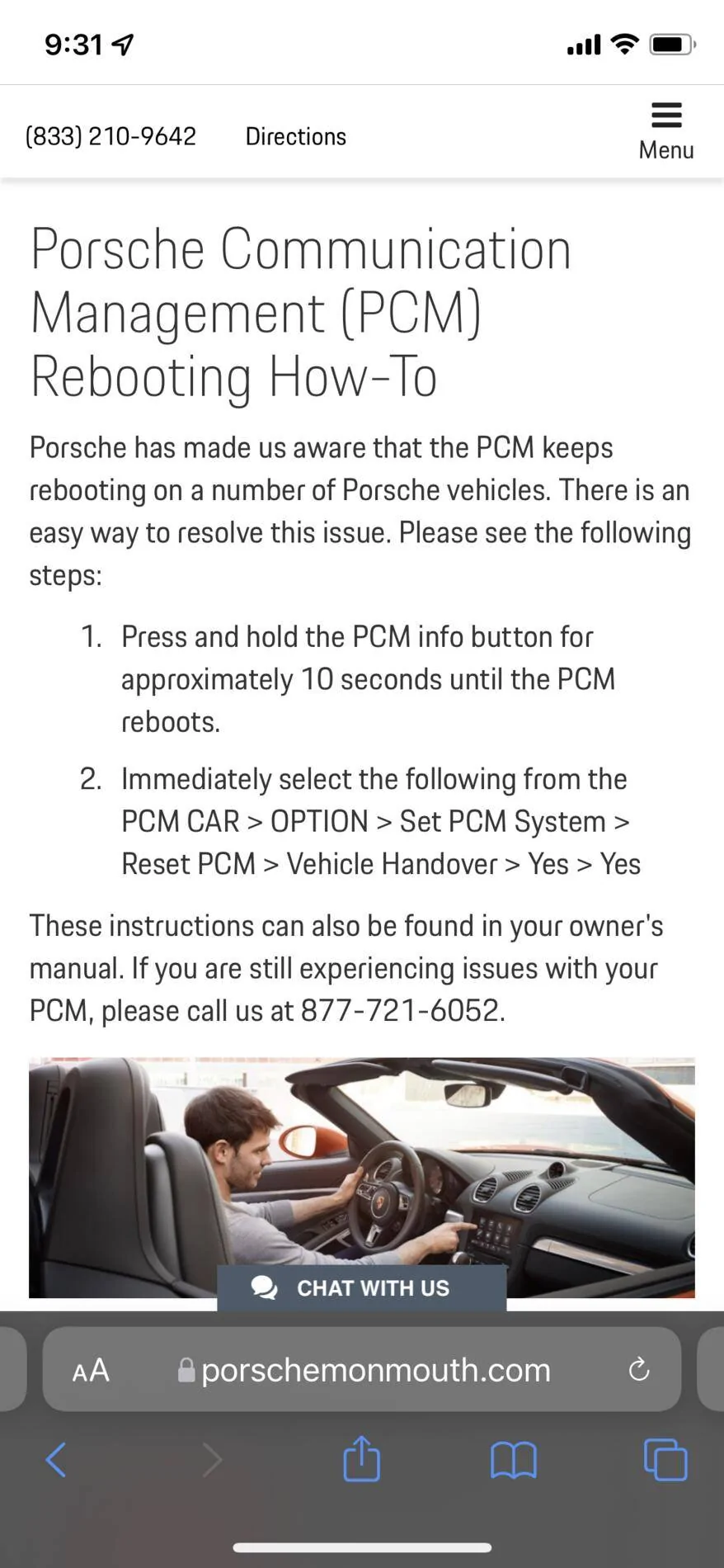

No updates on my end. I will likely try the approach below today and take it in next week if this doesn't work tonight and there are no PCNA updates by Monday.

I doubt if these instructions work on the Taycan - different PCM to the one described.

When I get a chance, I will check the service receipt to see if it provides any more details as to how the blinking red light was fixed.
Here’s a copy of the service ticket. Perhaps someone who understands what was done can explain it to the rest of us.
