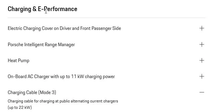

Which model year (MY) is your car as I think you are being spun a yarn (not unusual from a Porsche dealership)?
I had to pay for it on my MY21 4S and then it was standard on my MY23 GTS ST - so I know they're not being honest here.
If you are not the first owner, not an MY20 / MY21 car then it may not have been optioned or "found" it's way to another person.
This is the standard E-Performance equipment on any Taycan since 2022

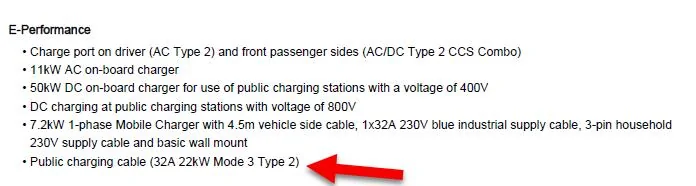

and this is the list for MY25 (new model)
