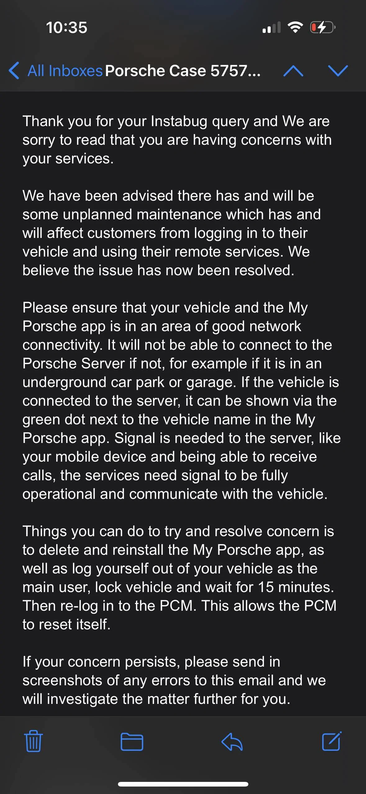

LTE is now showing on the car so I toggled privacy mode and locked the car… let’s hope it resets as it shows the car in the same location as Weds night and not outside my house…
Deleted member 7514
Guest
Looks like Porsche had issues as I got this email.
