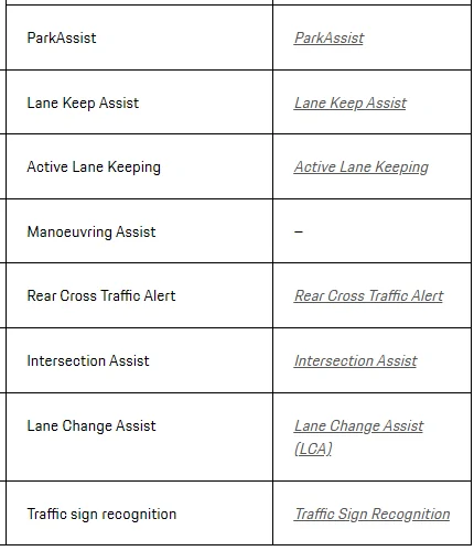

It's probably related to one of the assistance systems depending on what options you may have on your car. I get the tone on a steep incline but nothing else (I don't have additional assistance systems other than 360 park assist). Unlikely to be Manoeuvring Assist (only works in Reverse Drive Mode).

But the display will be as a result of one of the other options.
Either way not by Porsche design...rather a side effect of parking sensors and excitable software.

There is no proximity sensor under the car. The parking sensors are aimed very low to facilitate curb detection in auto park.
You can disable manoeuvre assistant to prevent the car from slamming on the brakes or set up an auto lift point in front of your ramp.
