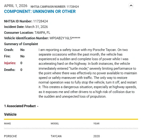

NHTSA Complaint - Loss of power while accelerating - turtle mode - March 31, 2026

I wonder if this person was monitoring battery temp.
I turtled like that once in my first base Taycan.
It was a very hot day, 110F if I recall.
The car was sitting in direct sunlight for 2 hrs.
I had the AC preconditioning running.
Then I drove it like I stole it with full launches.
I didn't realize it was a thing at the time, but the issue was very obviously battery overheat.
Once it cooled it was fine.
As critical as I am of Porsche and their many failings with this car, I genuinely think the issue here is instrumentation and driver education rather than a fault on the car.
The car should simply put a legible warning up explaining the situation.
What I'd do:
Yellow: "Battery approaching overheat condition, moderate driving permitted"
Red: "Battery overheated, pull over to a safe place and allow cooldown"
