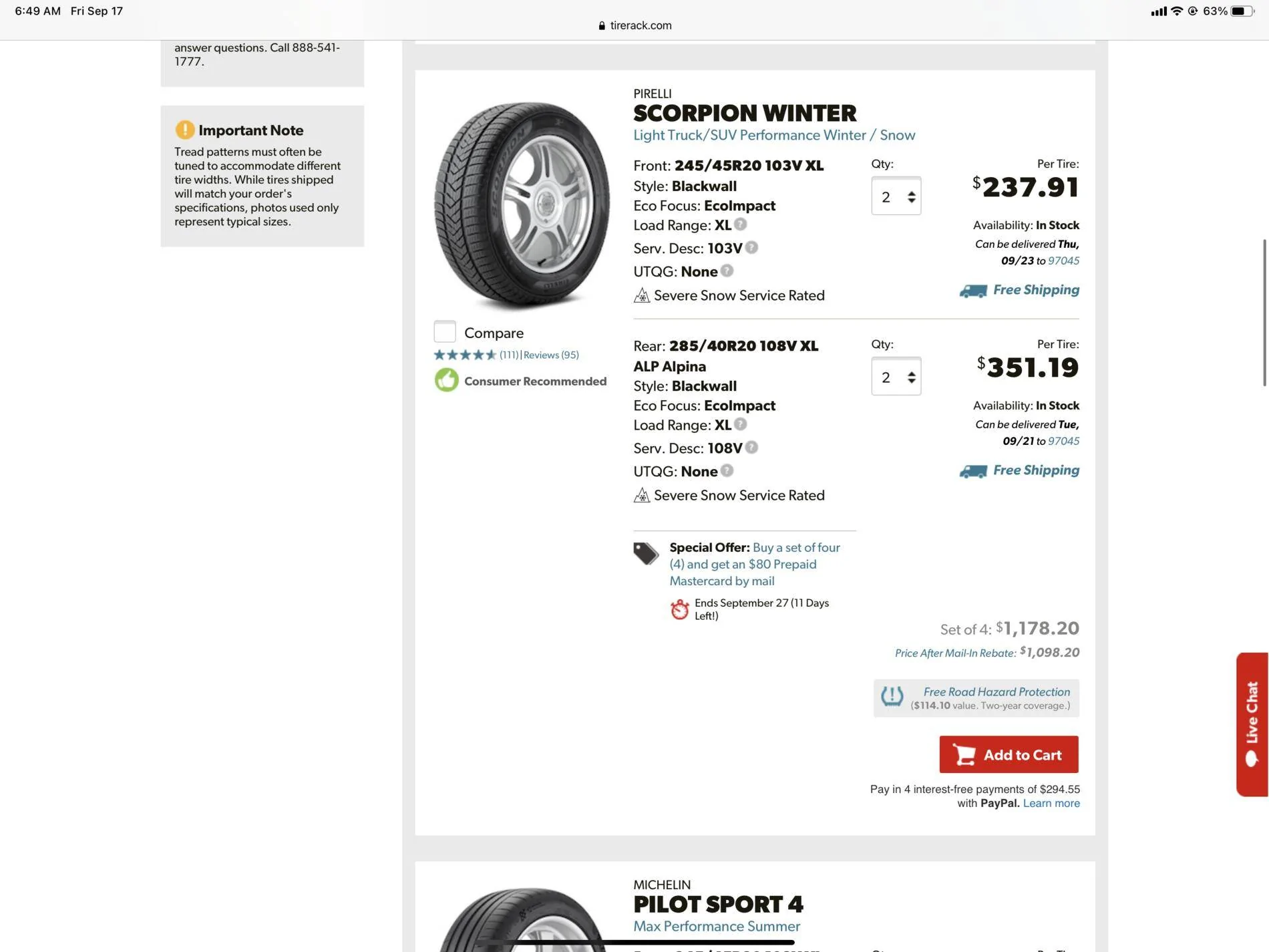

Tire Rack recommends non NFO tires:
They must differentiate between NFO and tires for electric vehicles. These are ecoimpact which are fuel saving/good for the environment. These do not appear to be designed for electric vehicles.
