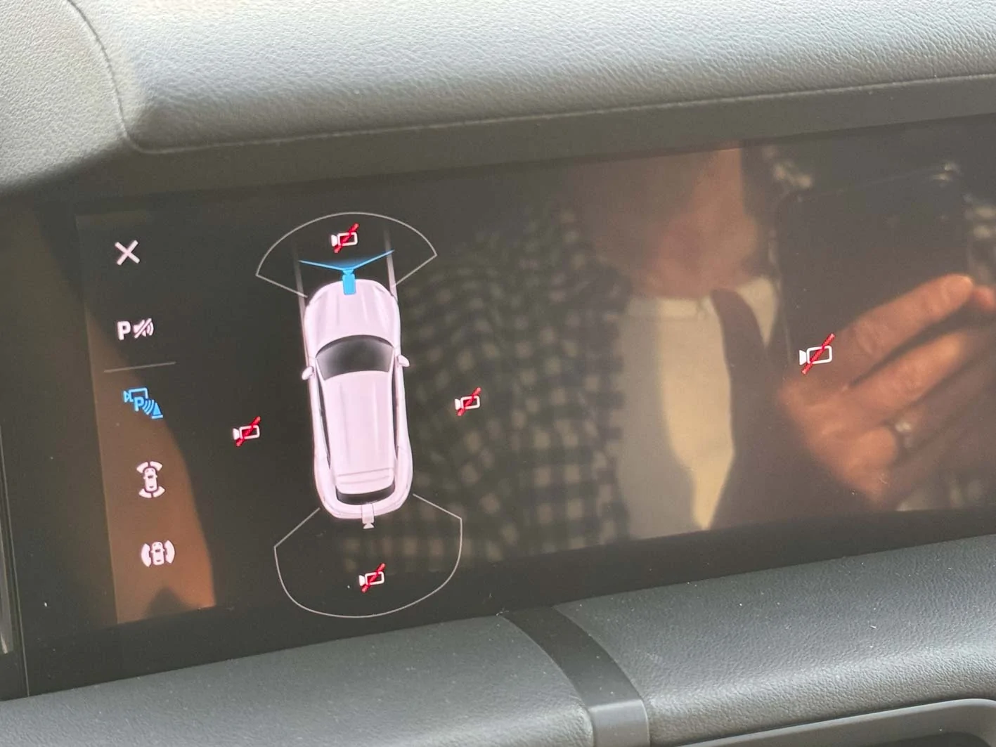

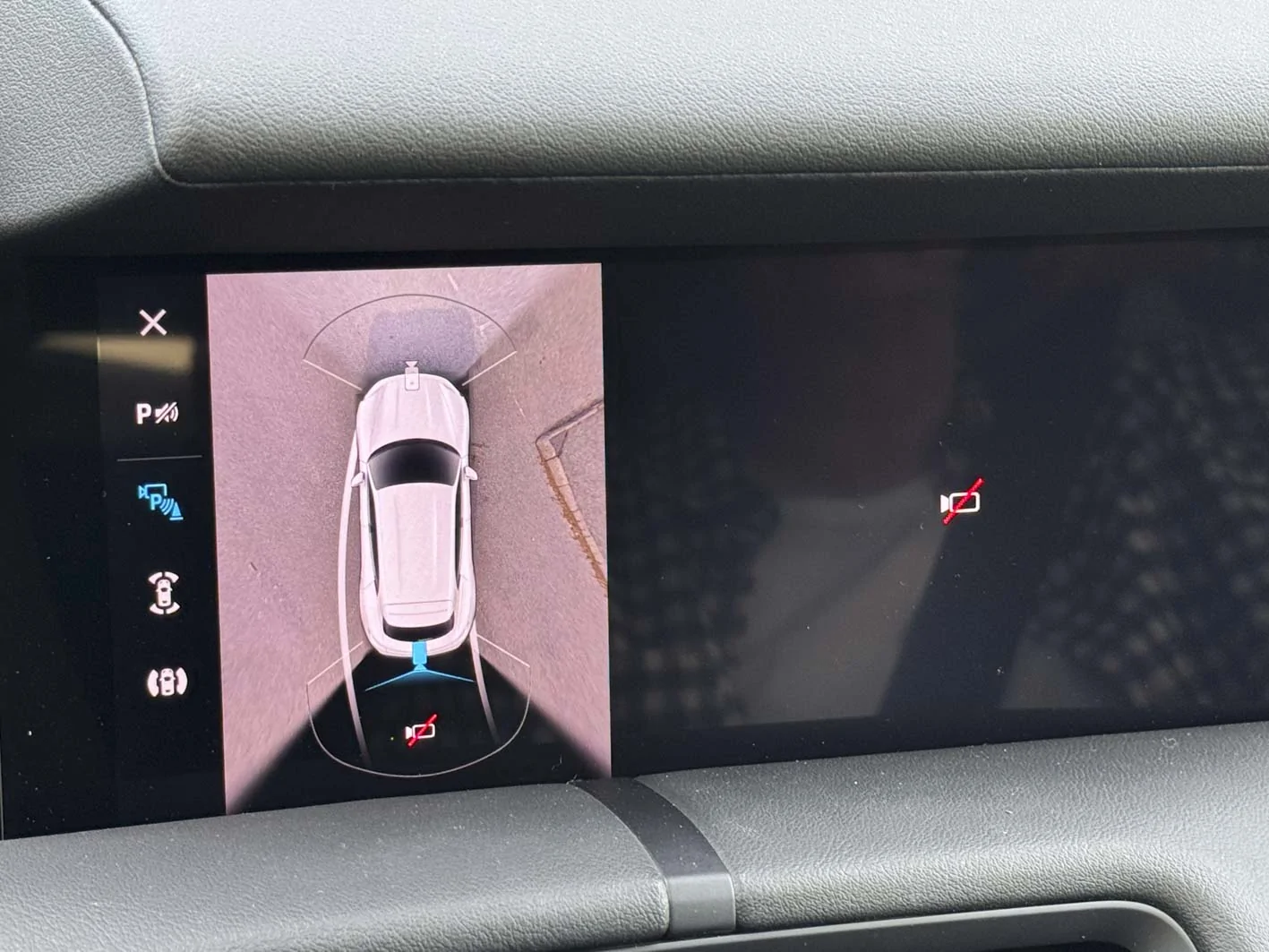

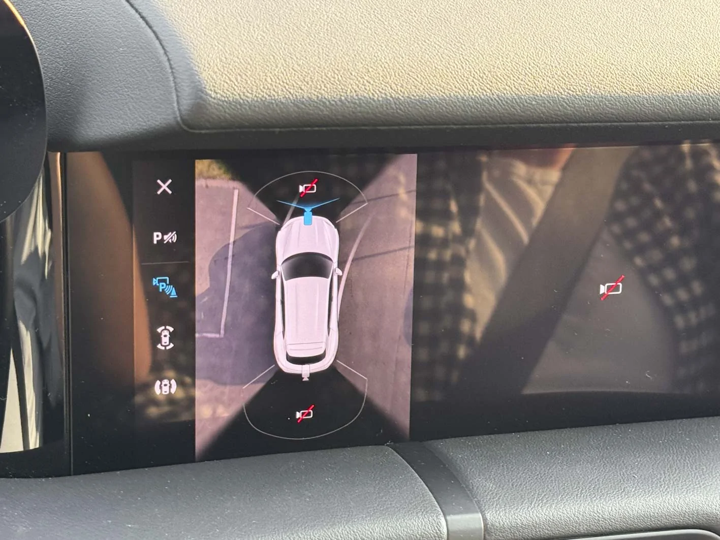

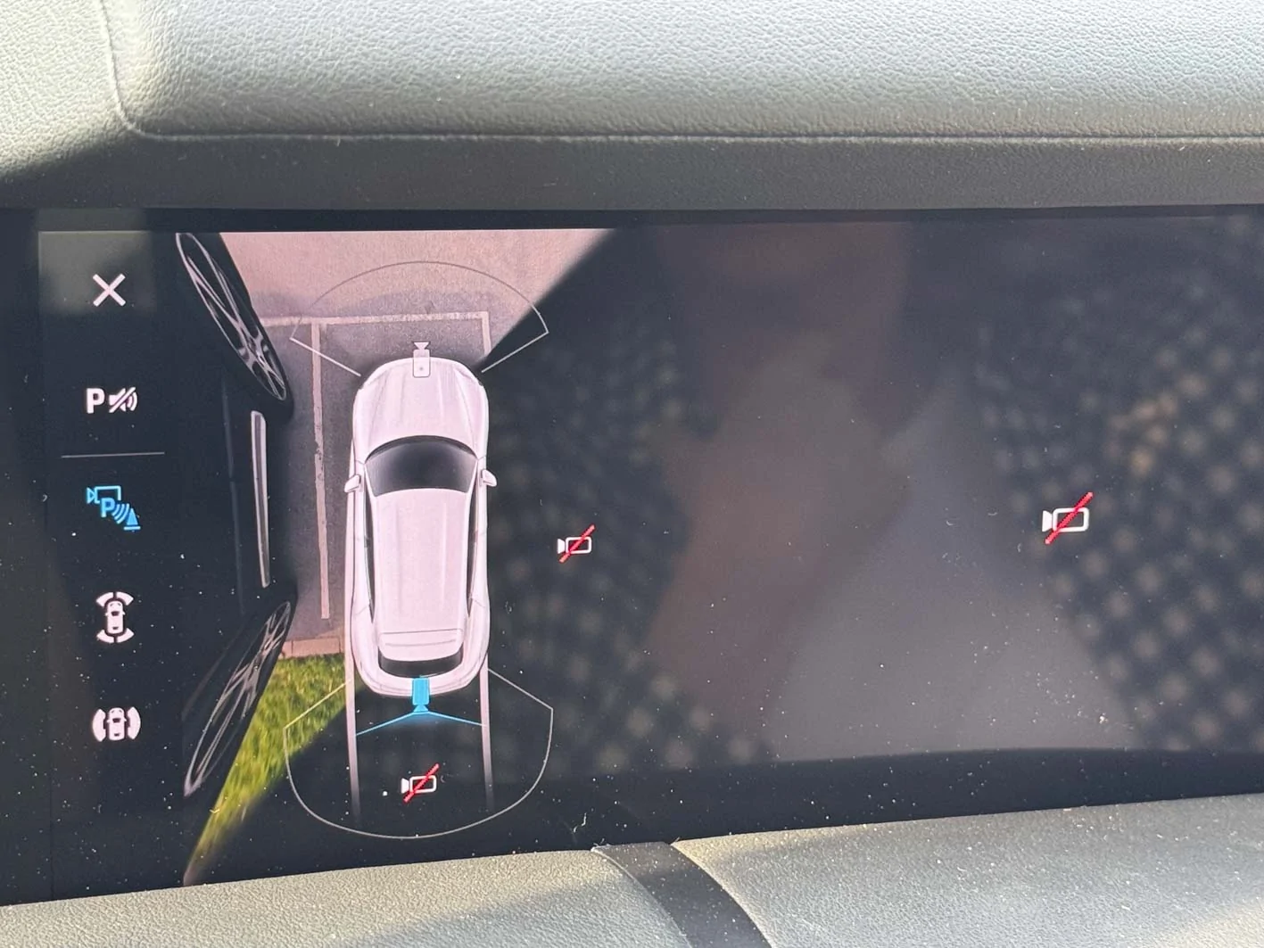

I have these annoying errors on the ParkAssist cameras where they are randomly blacked out and work again the day after. Today it looked like the pictures below during just one hour when shopping and stopping at different warehouses. It will probably be gone tomorrow as it has before but it's still annoying. Anyone else having these issues and will Porsche do anything about it on the warranty? Anyone have any experience?

this is an known issue. Covered under warranty.
https://www.taycanforum.com/forum/threads/all-external-cameras-failed.9216/
there are 2 fixes. They will first replace the harness. If issue is persistent, they will then replace a control module and upgrade the car to 2025 cameras. My car received both fixes.
I have just been in contact with Porsche Sweden where they are very well aware of this problem. I was informed that when cameras go out randomly like mine, this is not a hardware problem but instead a software issue that Porsche is working on and are planning a update for during Q3 or Q4 this year. (If only one camera is constantly affected, it is still a hardware issue.) There are other issues that the coming update will sort and also other models such as Macan that are affected.
