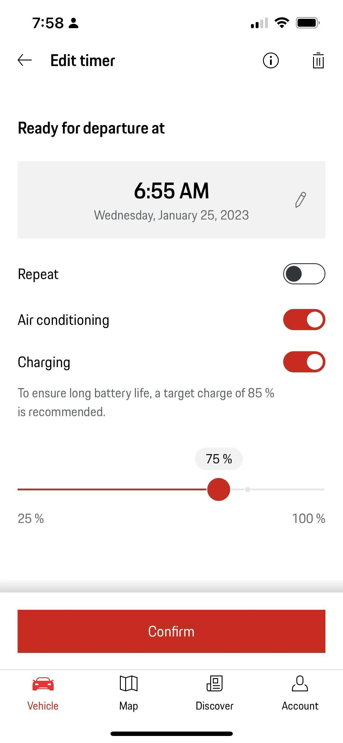

Trying to use the PCM app to set the timer function for charging and limit the charging to 75% of the battery capacity.
Woke up today and the battery charged to 80 something percent. So it went past the set limit…
I’m not using anything fancy. Just the standard Porsche connecter they give you with the car plugged into normal 110 volt 15 amp US socket (slow drip charging).
Is there something I’m missing and not doing correctly?

I think it is because you don't have it as a repeating timer or that there is no next timer event. In such scenarios if you don't disconnect the EVSE it will start charging again until 100% or you unplug.
Set the timer to repeat (doesn't matter that you don't charge daily (or whatever frequency) and try again.
