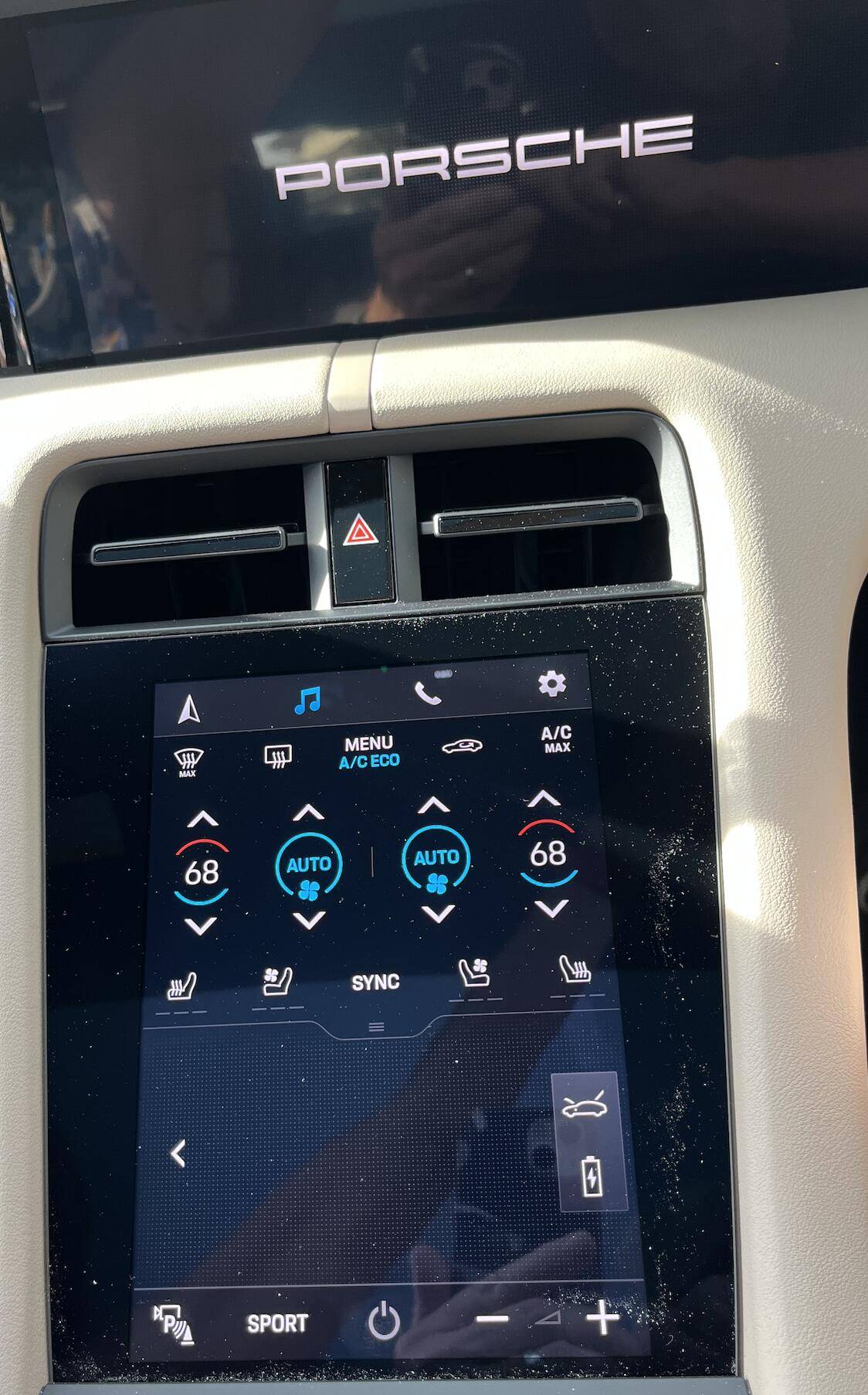

Touch with two fingers next to each other in the top right corner of the main display. That reboots into the engineer menu. From that menu, just select 'reboot to normal mode', confirm it, and wait for the system to reboot. That's the only way to actually fully reboot the PCM without messing with the 12V battery / fuses.
This video also shows you how to do it. It works on any screen.
under a week of ownership. Got touch screen not responding issue. I guess the two finger reboot takes practice. Will try again when i get back to car tonight.

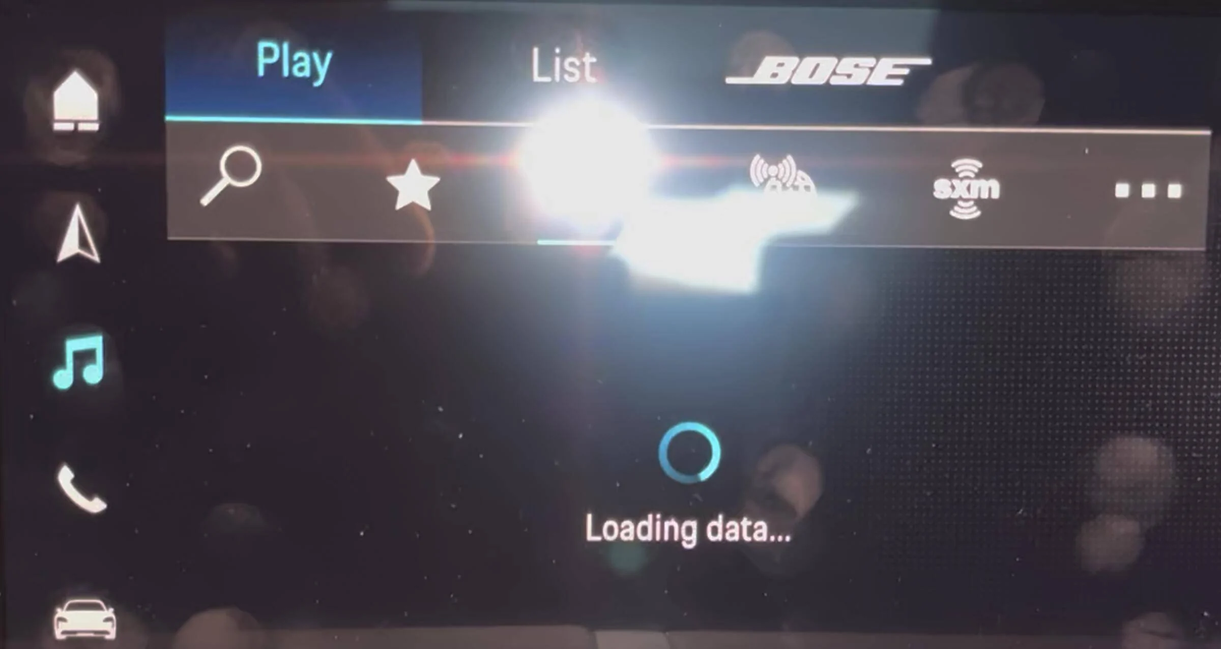

Unfortunately even after the upgraded software version the PCM fails to load about 10-15 percent of the time so the two finger reboot is the only way I have found to get the PCM to reload. Not sure what I will do with this car when my lease is up. I like the driving aspect but the software is garbage.
