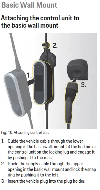

PMCC Dimensions when mounted in the wall bracket please. Thanks

My Taycan should be delivered around Feb/Mar. I passed my freeze date. So planning in where to install the PMCC in the wall bracket.
Can someone give me the dimensions please? Mainly the depth. I have a sideways sliding door to the garage so wondering if the door will clear the PMCC on the side wall.
Thanks

https://tequipment-finder.porsche.com/gb/J1/Taycan/&ac=product&pr=418E4BE0C59AF682C125856E00280F43#:~:text=The Porsche Mobile Charger Connect,and used via your WiFi.&text=- Dimensions: Length: 38.5 cm,; height: 6.5 cm).
Standard mount provided with it will be fairly low profile - perhaps 2.5 cm
Porsche Taycan PMCC Dimensions when mounted in the wall bracket please. Thanks 1673520934131
https://tequipment-finder.porsche.c...file/Bedienungsanleitung_Operating Manual.pdf

So around 9 cm depth, thanks.
Would be useful if someone could give me the actual size please as the sliding door is close to the wall. I also need to think how much space the charge lead needs.

Mine is in the Porsche Dock.
Cable is medium thickness and heavy (depending on length). It won't look great and may appear untidy with any mount other than the dock if that matters (reason I went with the dock).
I won't be able to open the sliding door with the dock for certain. I'm actually installing 2 x 3 Phase sockets so I can move the PMCC near the front door so I can pass the charge cable through the gap in the door and charge the car when it's outside. The Taycan has to go into the garage forward so the other 3 phase socket will be on the back wall for usual overnight charging when the Taycan is in the garage.
