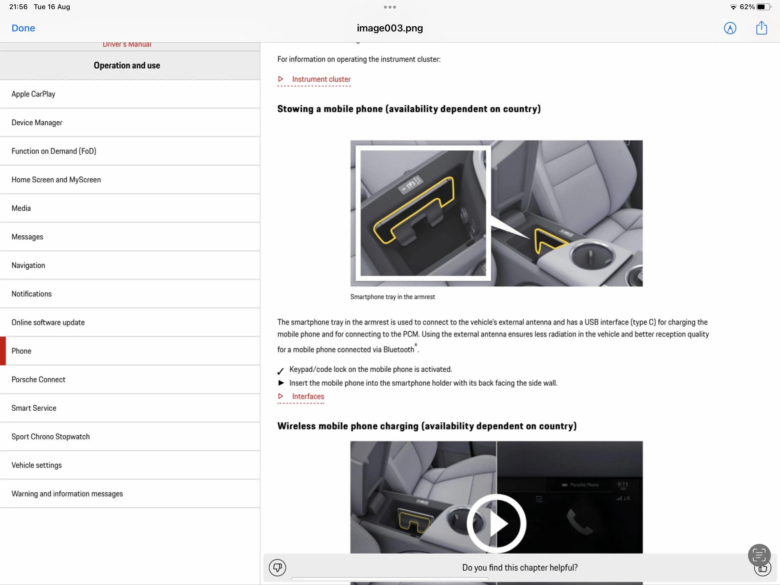

I’m in the UK too and do have wireless charging. I’m intrigued to find out what method they are using to boost the GSM signal to your phone. In the old days, your phone placed into a suitable car kit created a direct, physical connection between your car’s external antenna and your phone. If using Bluetooth, this is something quite different, which is interesting.
It's not using Bluetooth but will be the antenna within the cradle extended by hidden wire to the PCM I would guess.

presumably though Porsche had a reason to put a phone signal booster in the car. My dealer said it was definitely in the car build but were not able to tell if it was operating and putting the phone in the cradle seems to make no difference..
