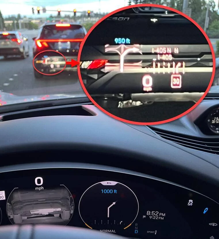

It is a little frustrating that Apple Maps won’t connect to the HUD which I really like and very good on Taycan, it’s crisp adjustable and configurable.

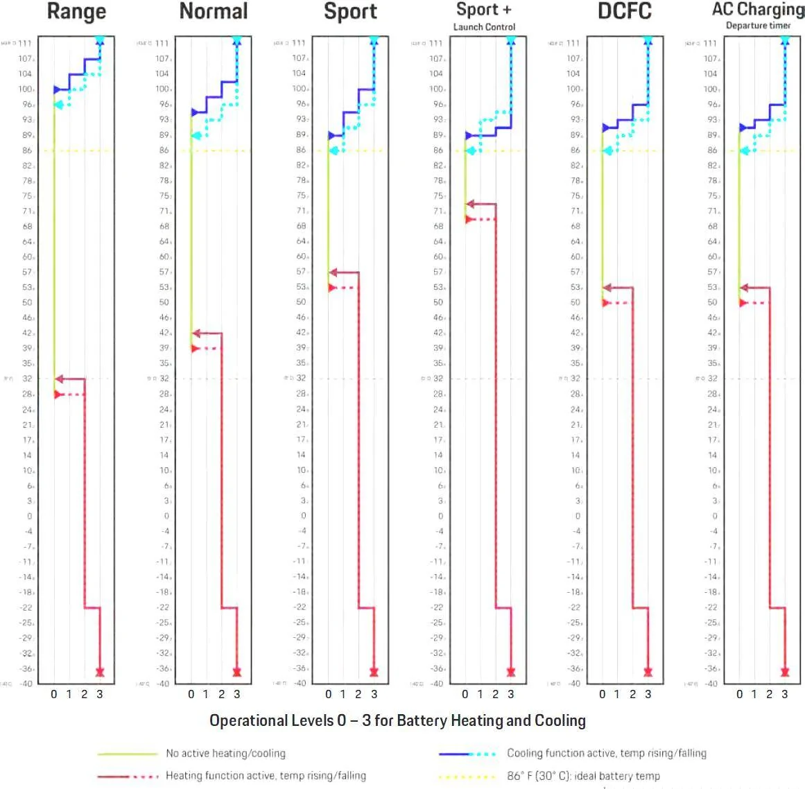

Another "sort of" workaround is to drive in "Sport Plus", which ups the battery target temperature. Unfortunately I have not paid attention to what temperature the car preheats the battery to charge, anyone out there note it down? We could compare against the Sport Plus target temp zone (which I will need to dig up, but I know I have it somewhere).
Based on posts from others, the battery pre-conditioning temp targets about 105 degrees F, or about 40 C. So gets pretty hot. I don't know if this varies based on factors like the outdoor temperature. I can't image the battery tries to heat that much during winter for example.
Ok, I dug up something I found a while back, temperature ranges for different modes.
Porsche Taycan Porsche Navigation vs ABRP vs Apple Maps EV Routing -- Pros and Cons 1690966580433
From this, it seems driving in sport will give you a similar profile as charging, Sport Plus should get the battery at the upper half of the charging range - so starting charging nice and toasty.
