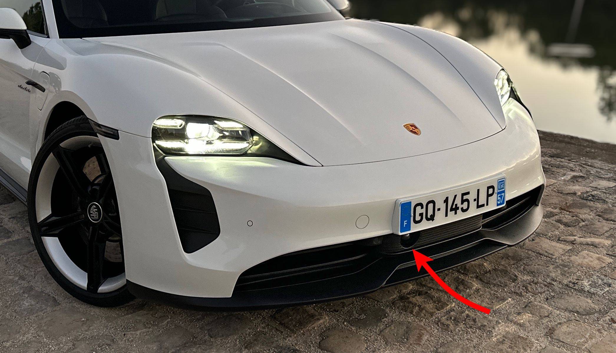

5- Two easy ways to tell; the first was already shown in post above and fastest way to tell when shopping online is look for that black bulbous thing. Second way to tell: look at the lower left stalk on steering column. If it has the "distance" adjuster up/down then it has ACC/PID features. Note that if you have ACC you can FoD (feature on demand) add PID, but most of us think wasteful to bother.

ACC - radar dome on the front as others have mentioned but also the build sheet for the car will list.
