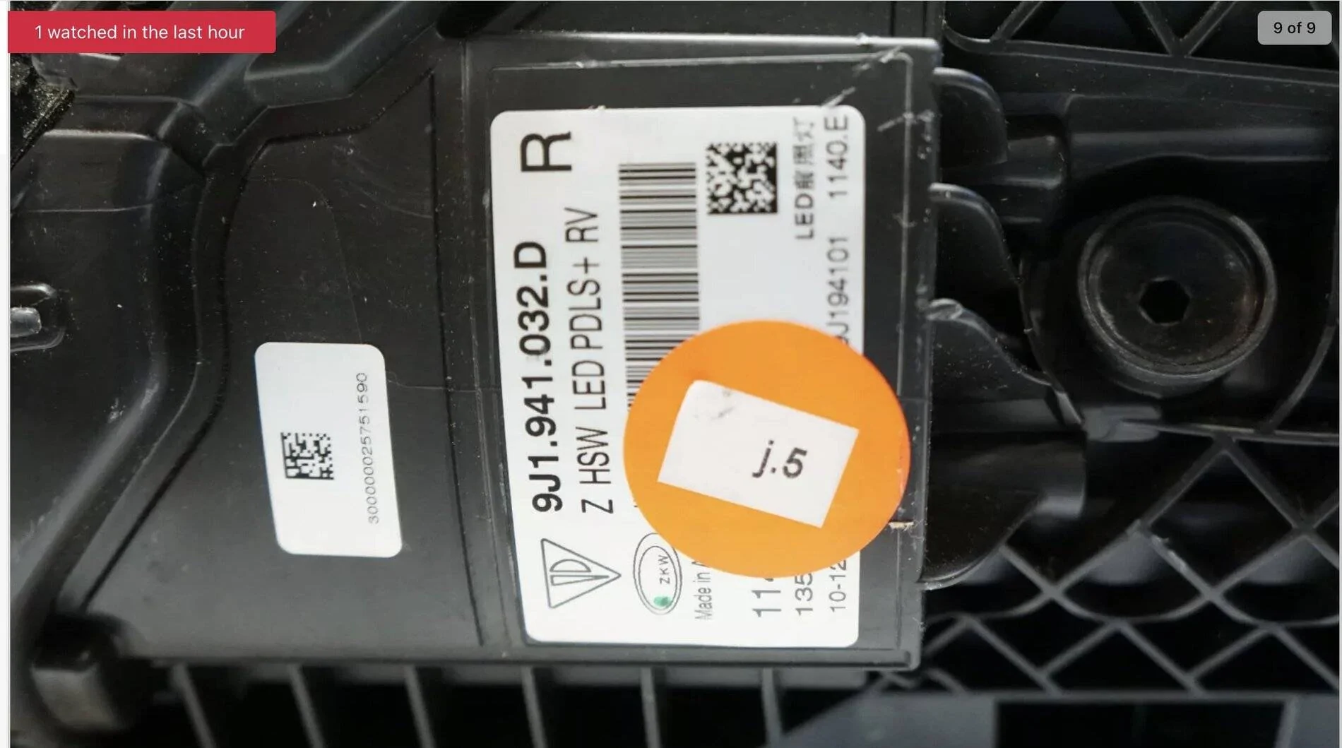

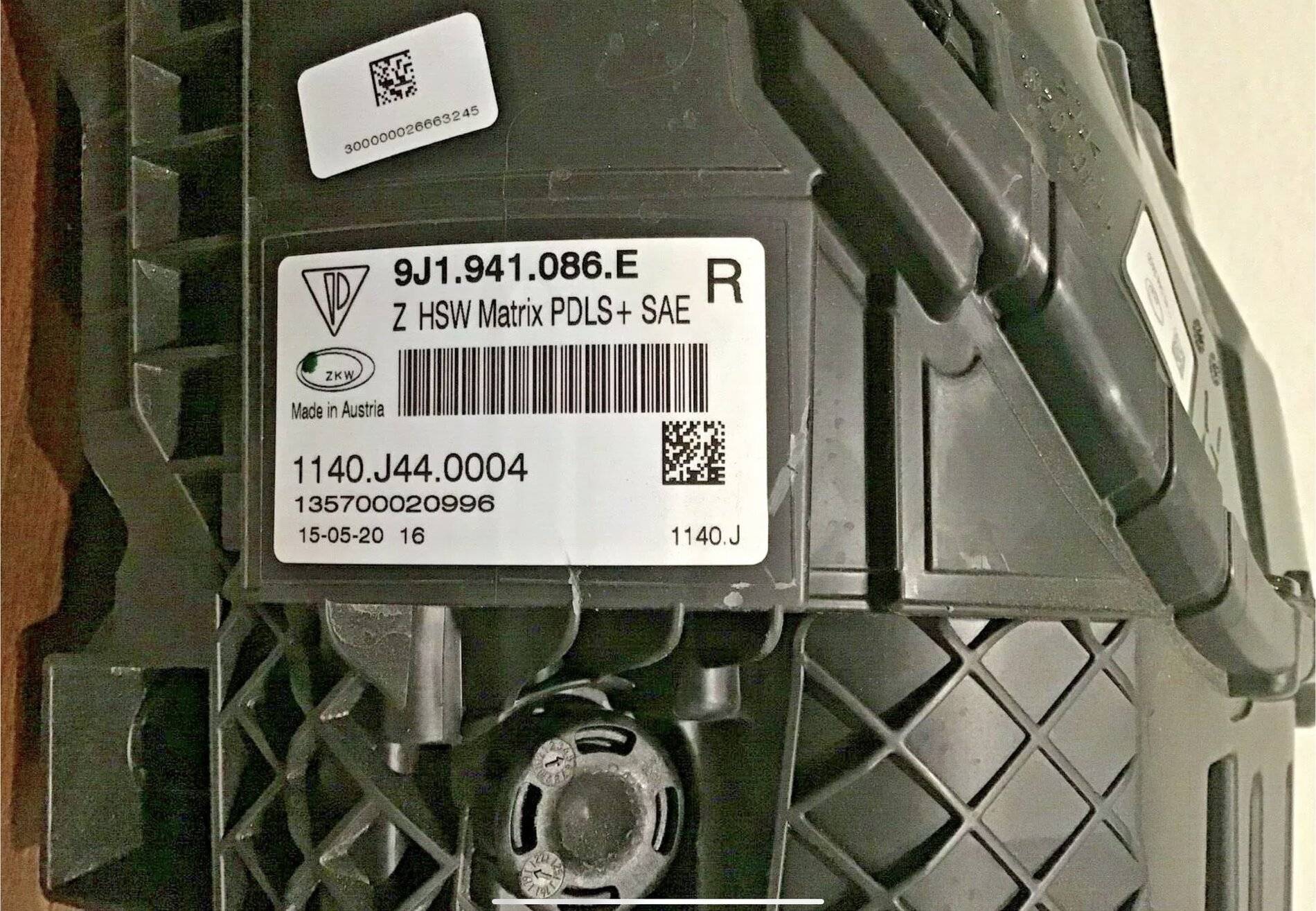

From quick research on eBay, the headlights are different between USA and Europe. I do not think a software update will do It. USA headlights have PDLS+SAE. Headlights from German EBay have PDLS+RV. Admittedly one is matrix, one is not, but I believe SAE description is what matters. Whether it is just programming is beyond my pay grade.

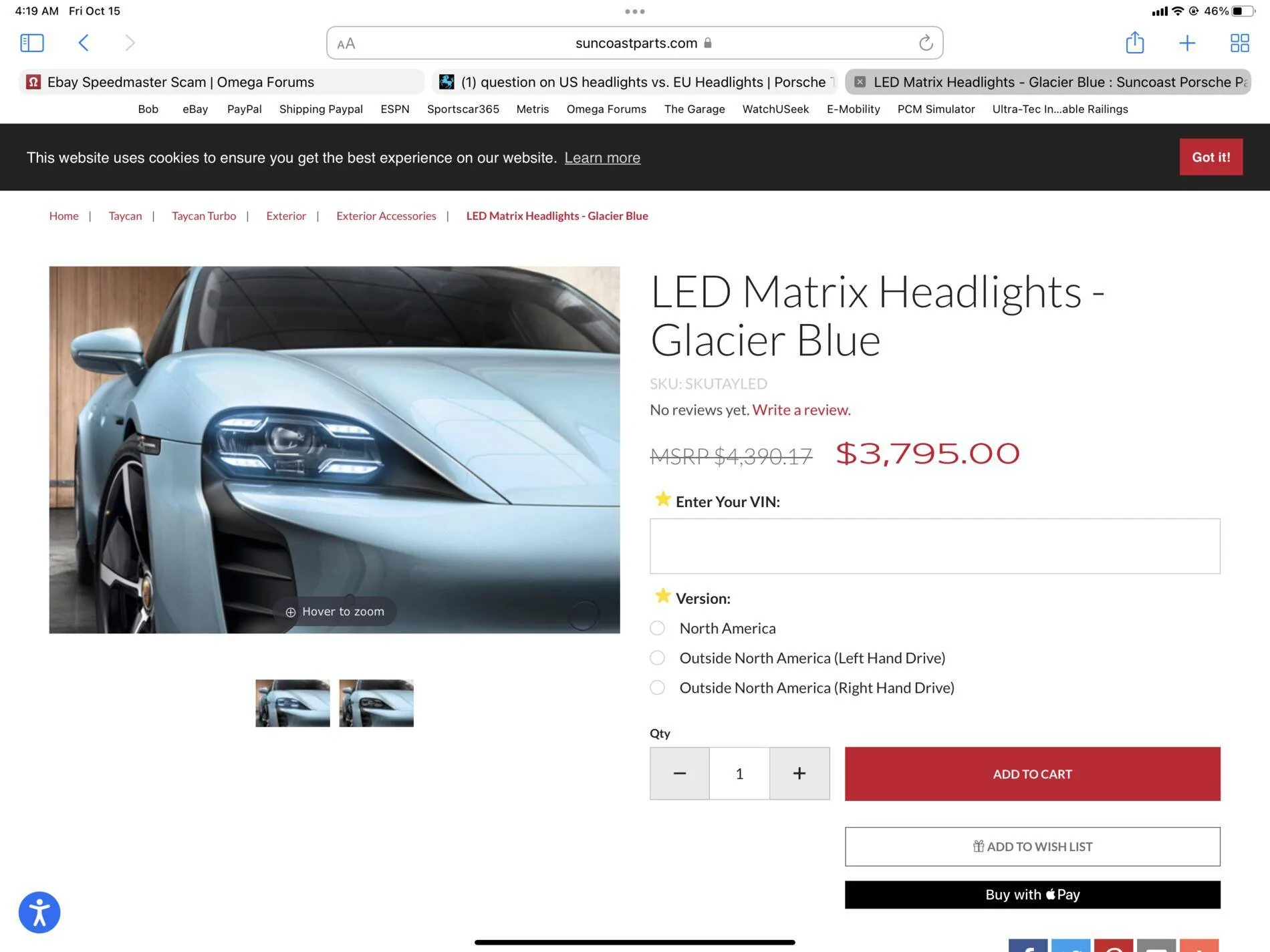

Suncoast Porsche parts seems to show 3 different versions of the Glacier Blue headlights. My VIN allowed me to order any of the three I wanted. $3800 for a new pair.
