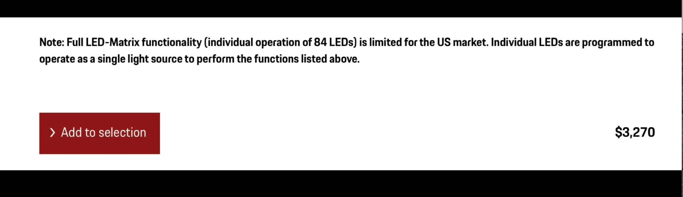

I never said it was anything revolutionary, but proof that matrix LEDs in USA are not all-or-nothing (i.e. acting as one LED).
This is true. Our U.S handicapped matrix LEDs are NOT all or nothing, they do "virtually swivel" as another member calls it. This is evident if you're pulling into a neighborhood and see the beam against a garage door or something while moving the steering wheel. The rate at which the beam slides to the left or right (individually shutting on/off LEDs in left or right unit) is also dependent on speed and someone fact me on this, drive mode as well.

To address your second point first. Yes, you are correct. It's simply software. PDLS+ matrix LED optioned Taycans have the same hardware, regardless of region. I've mentioned it before, but sooner or later, someone smarter than me will be able to reprogram the ECU that enables North American Taycans to have full matrix functionality.
Will Porsche issue another recall to update older Taycans? Depends on who you talk to about it. I've read that Porsche would need to go through the process of testing and re-certifying older models in order to get DOT approval. That's a lot of time and money, so most likely a no. I don't think it's easy as DOT says, ok this functionality is approved now so bring your car in for service to get the update. Maybe this job is a job for a class action lawyer? :p

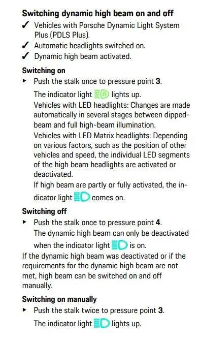

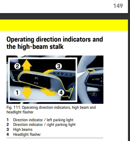

Where is this
Also, check the headlight unit to determine if matrix or not - it will have a matrix legend and the design of the headlight interior is different.
All Taycans have led headlights.
Also check that PDLS+ Iis enabled via the lighting stalk.
Can anyone tell me where this lighting stalk is? I have no idea what it is.
Porsche Taycan Question about PDLS+ headlights 1682559930643
Porsche Taycan Question about PDLS+ headlights 1682559983988
Source: Owner's Manual (aka TFM), chapter "Lights".
Note there is also this: Settings -> Vehicle -> Light and visibility -> Exterior lights -> Dynamic high beam (it may not be accessible if the car is moving).

Where is this
Really?
It's on the steering column where you would manually operate the lights - flash, high and low beam. Push it forward to engage PDLS. and an 'A' will appear in the light icon on the main instrument display.
Review operation in the owner's manual.

This is what I was able to learn through my SA who has his sources.
The regulations in the US are now allow Matix lights.
However, Porsche has to go through time consuming and highly bureaucratic certification.
Certification will only apply to a model year and type of light (Matrix) unless it is a different one (HD). Therefore, all of us in the US with Matrix (84 leds work as one unit) and even new HD on the Cayenne (description says whatever 16k leds work as one unit and looks butt ugly to me vs. basic LED units) are SOL, to get full intended functionality, as there is no chance it could be programmed after the factory as our model years were not the ones that went through the certification.

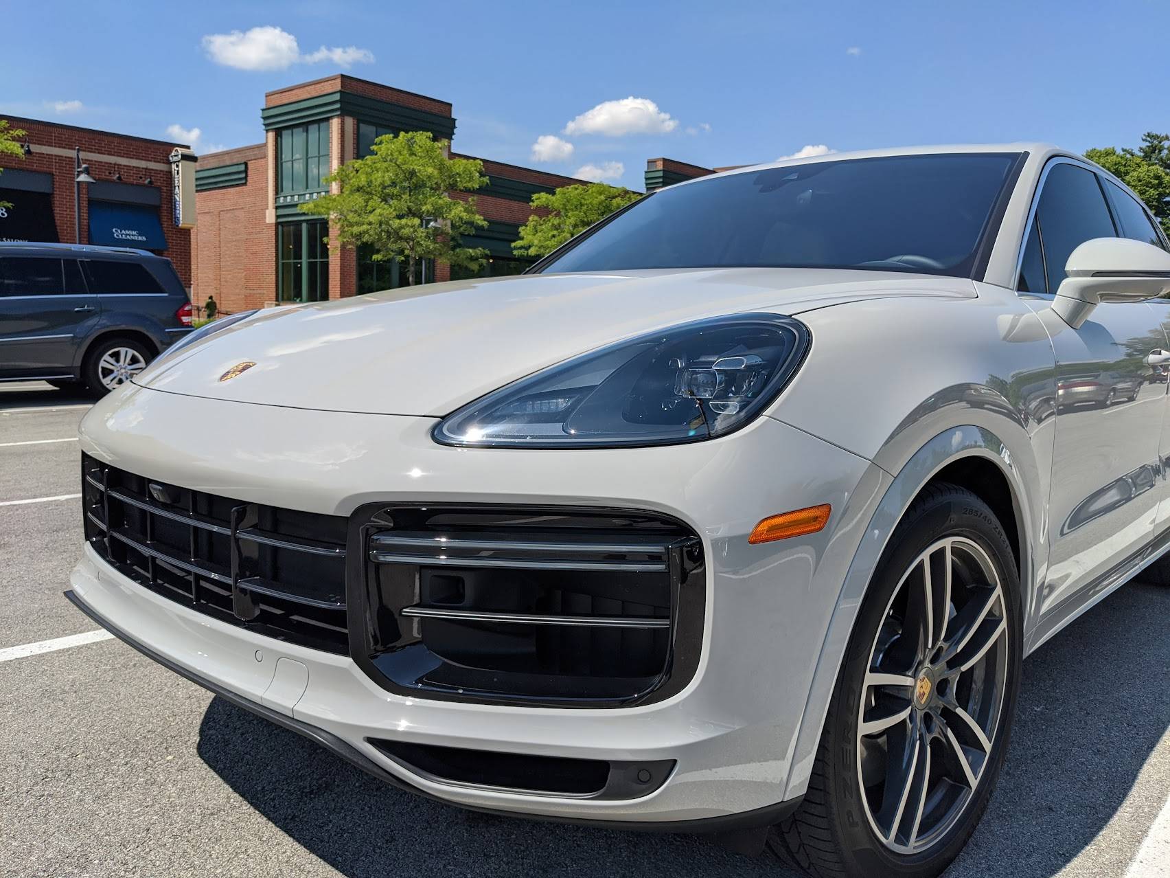

My only question as I could not avoid Matrix on my MY23 build, are they at least brighter than the standard LED units. I was able to escape getting Matrix on my 2020 Cayenne, but it cost me more and the PDLS+ feature, as I had to forego the Package to do it, however, they look so much better (in Black) to me when off or on, vs. too busy who knows what Matrix lights. There is no in your face difference on the Taycan, so that is not a big deal.
Porsche Taycan Question about PDLS+ headlights LED in Black
