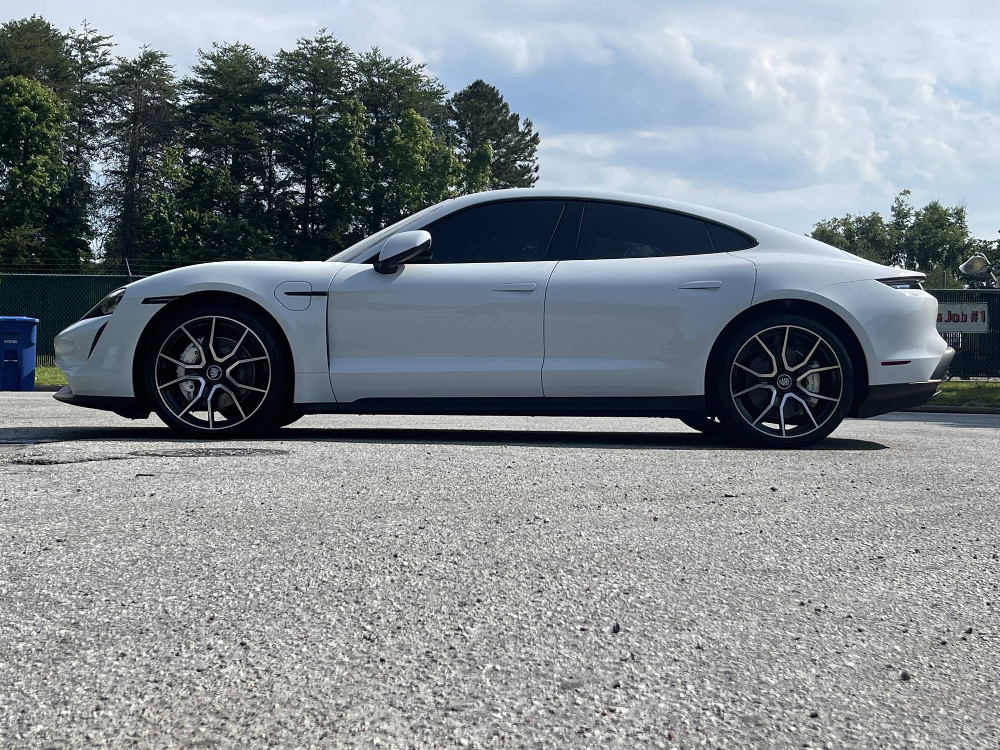

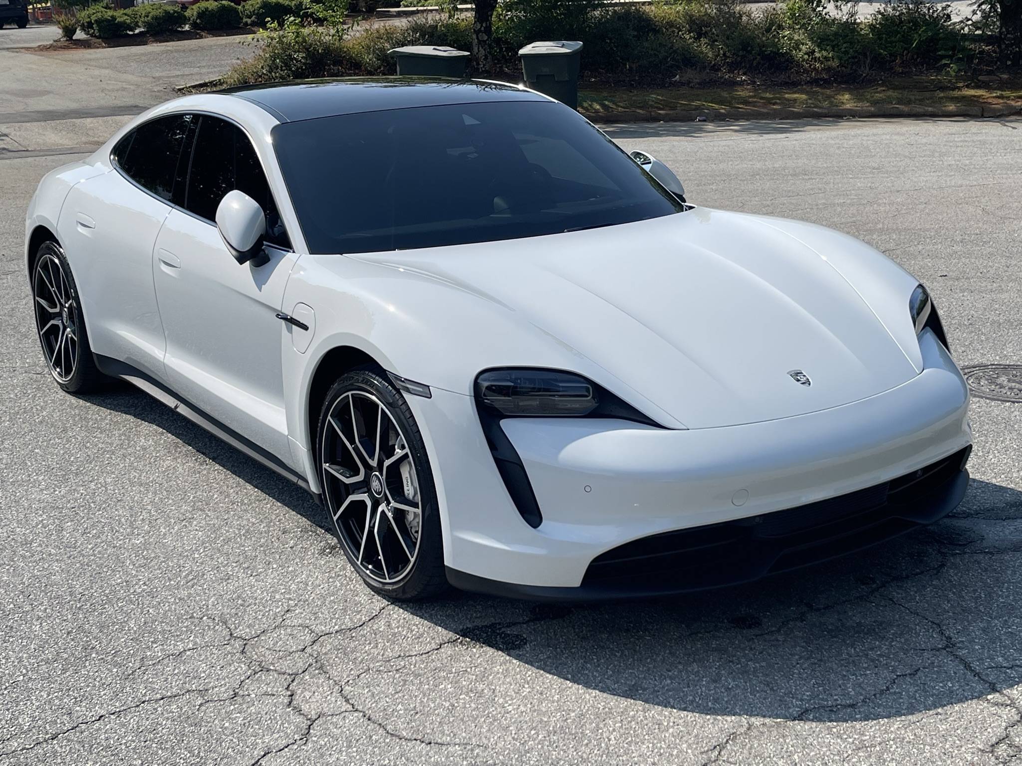

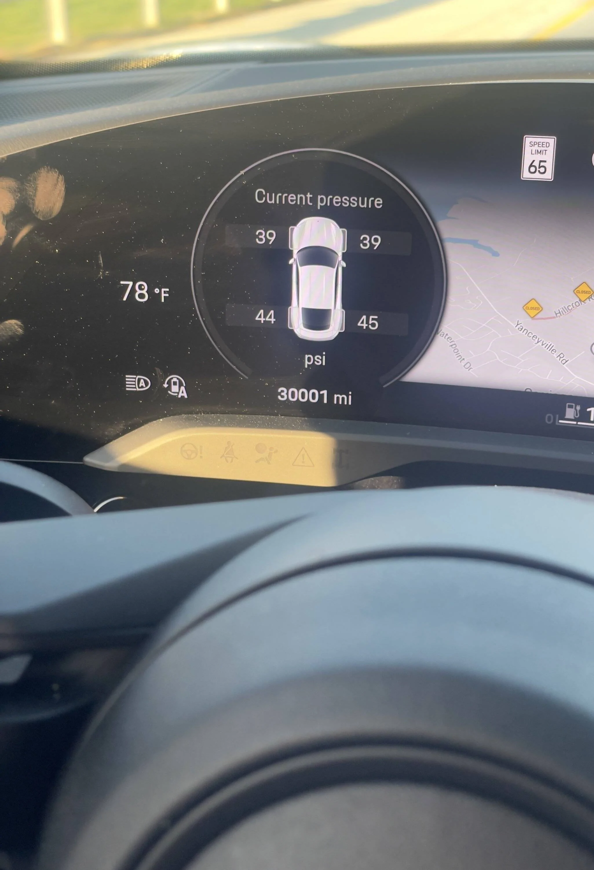

In a few days it will be officially one year since taking delivery of my 2022 RWD Taycan. Many miles (24 miles on delivery day, 30k as of yesterday ?) driven in this car with no regrets, I purchased it to be my daily driver and it hasn’t disappointed. There are a couple questions I think of but never ask, I look forward to your insights.
1. Is there a difference between Sport vs. Sport Plus Chassis when I don’t have air suspension? If so, what’s the best one and why? (I mainly drive in individual mode - Sport Plus, Sport Chassis, Regen Auto, Electric sport sound on)
2. Best summer tires? I have the RS Spider wheels and currently using Continental All Season tires (Had Pirelli P-Zeros summer tires upon delivery and they went fast but loved the stickiness)
3. Suggestions on how to minimize wear on the drivers side B-Pillar? I’m 6’3 and have plenty of room when inside the car, but with how low the car sits my body tends to rub alongside the B pillar when getting in and out occasionally and now starting to see the wear on it.
