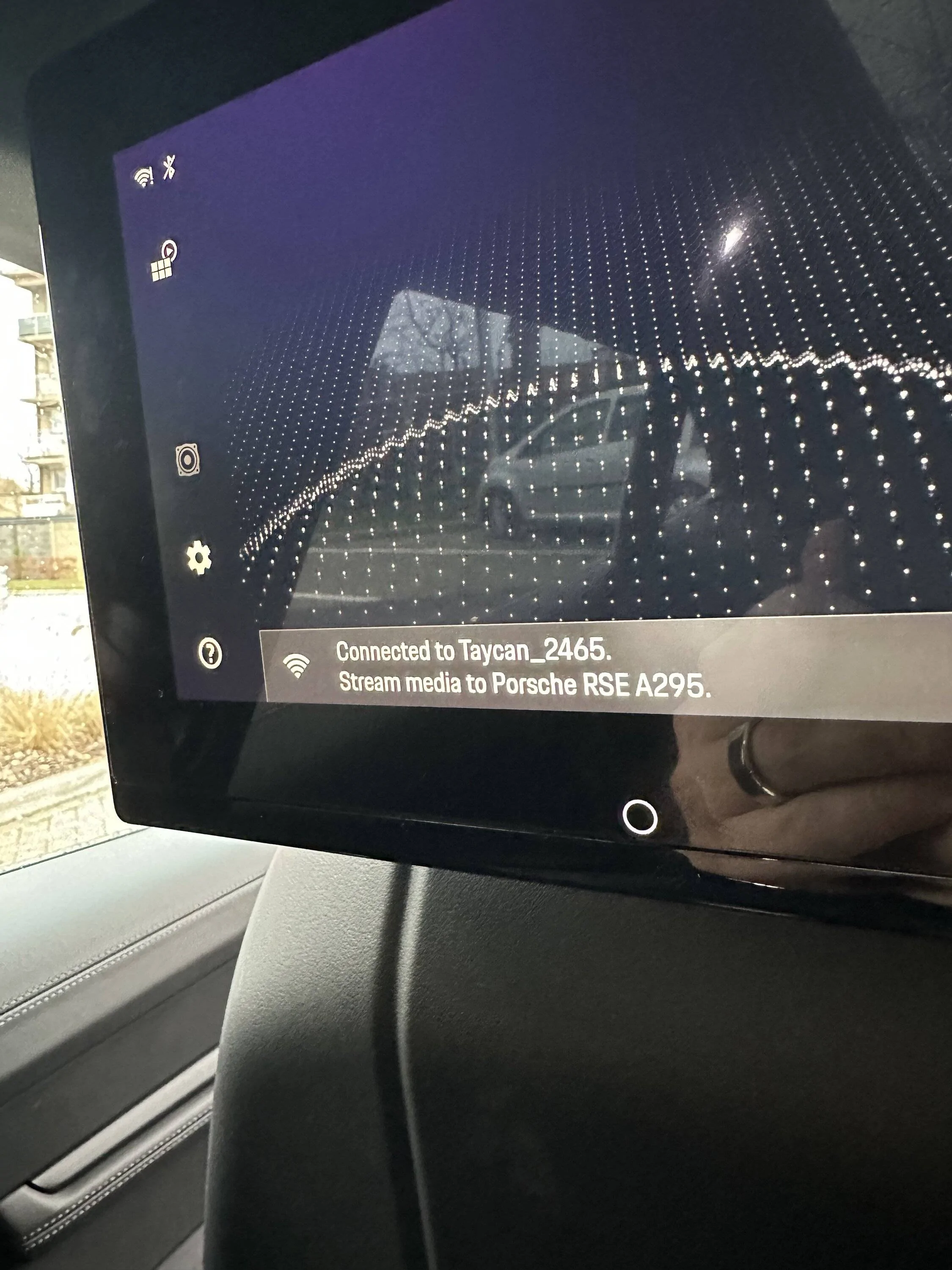

I can connect to the in car WiFi hotspot. But the Netflix icon stays grayed out. No idea why.

I have it too, got the car mid December. You do need the data add on for it to work easily. The problem is the 7gb runs out quite easily, especially if other devices are being used on the network. At the point it runs out the car is offline apart from charger info in the nav until the data renews a month later, tomorrow in my case.
in the couple of days it was working we had it all functioning in terms of Netflix and so on but the number of idiotic problems I encountered were ridiculous. More to do with the wifI/data than the screens but even they need some updating for things like crosslink or web browsing, adding YouTube and other apps.
My final gripe is the lack of anywhere to store the headphones. My Cayenne had a simple clip that kept them neatly tucked away in the door. The only place we can find to store them in the Taycan is in the glovebox.
Basically there is a great RSE there but Porsche need to actually make it work and provide it with data. If they haven’t sorted it out in 3 months, my dialogue has been going since Dec 17, I will probably start going legal over misselling as I think it’s that badly thought through in its current guise and it might help make them take some action.
