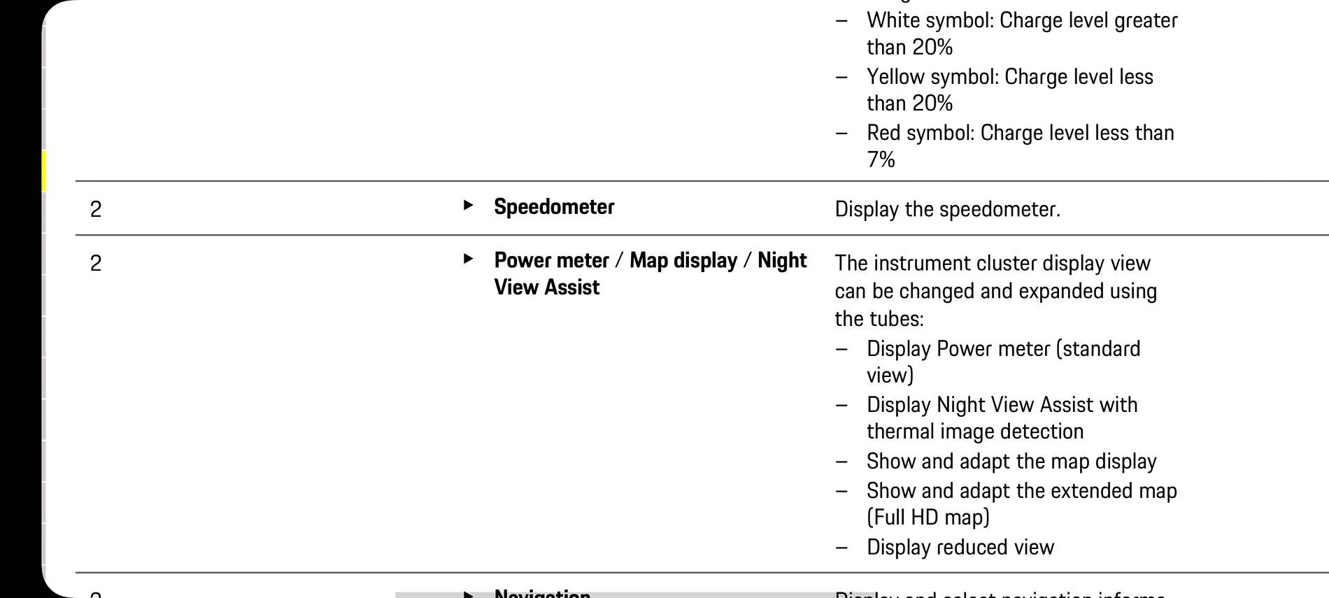

When I first had my CT4S in 2023 the speedo surround showed an indicator line of blue when accelerating or green when putting power back in the battery. I have realised it no longer does so and don’t know why. I am driving in normal mode with regen on. Any ideas?

I'm not near my car but I think there is an option to change the view in tube 2 and you may have accidentally switched to the alternate view.

I verified this fix for you today. Set tube 2 on Power Meter, then push the wheel button for the submenu and make sure Power Meter is checked.
