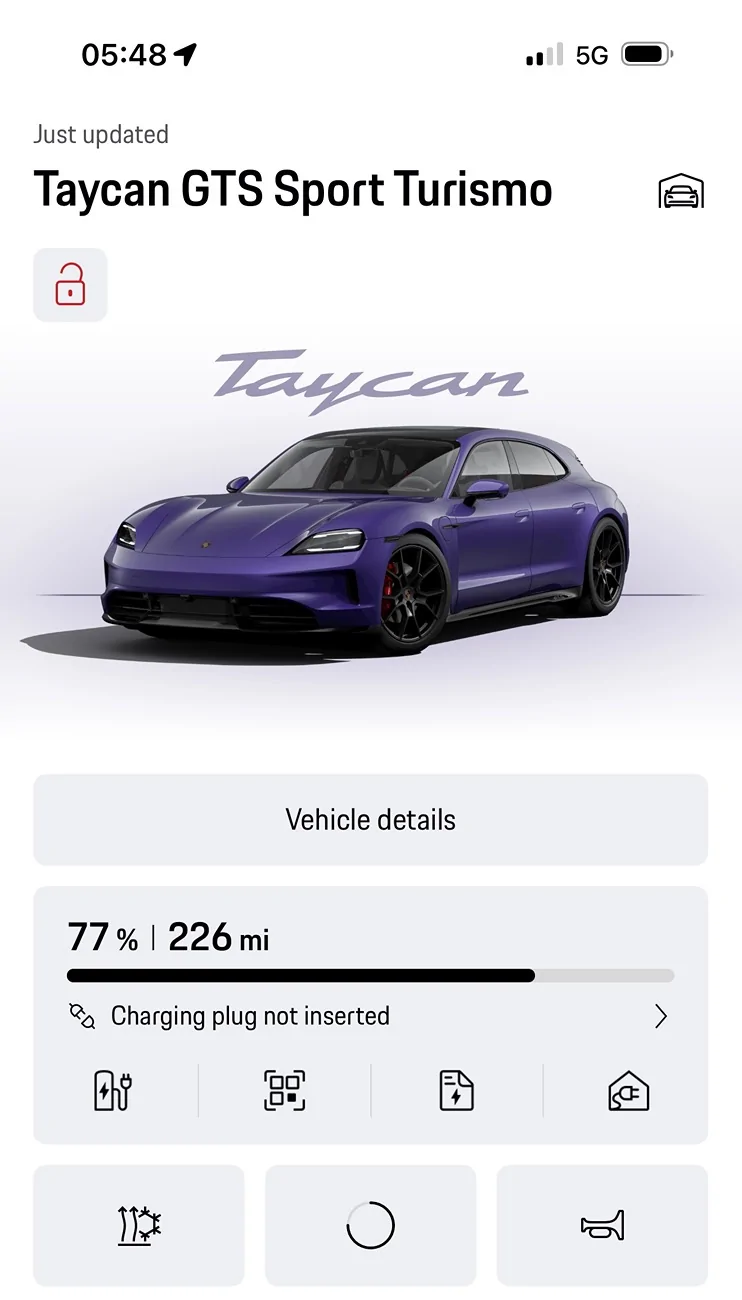

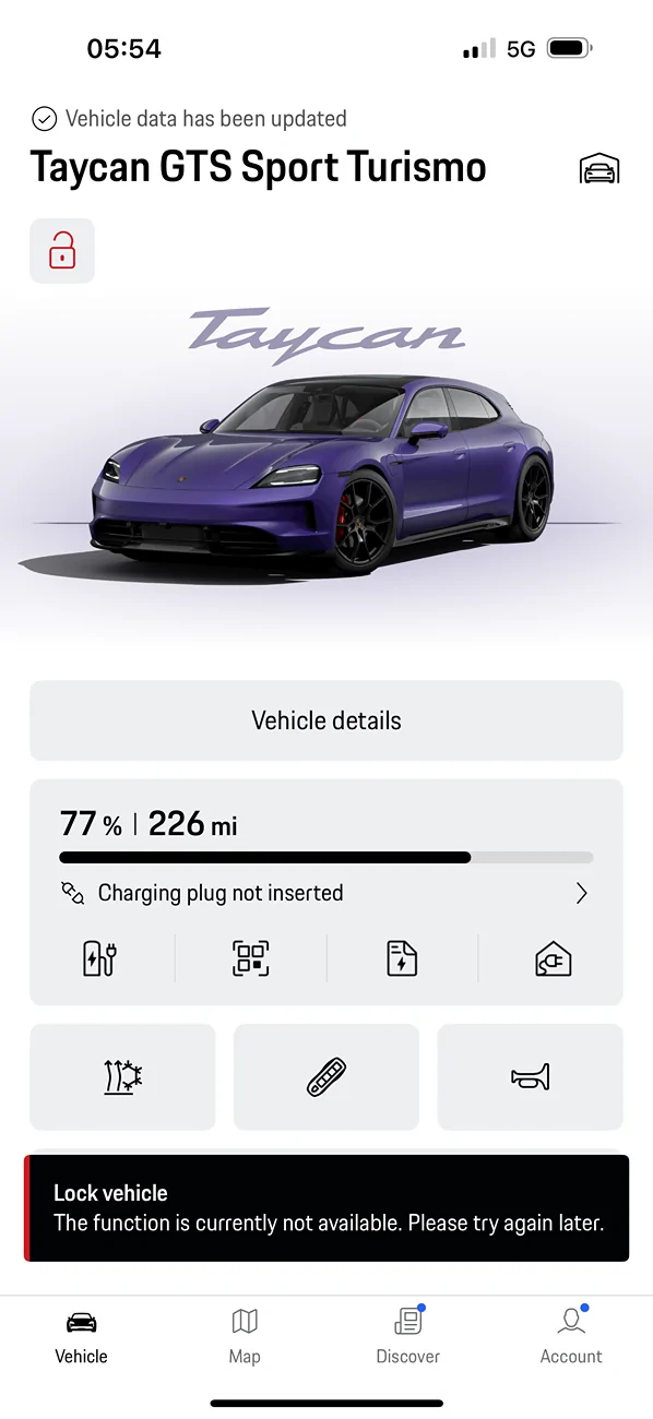

Left my car at the airport car park only to find I’ve left it unlocked. The app keeps failing to lock it so I was hoping someone may have a solution or idea in which I may be able get some relief from having the car locked.
The lock button on the app hangs for a very long time with a loading bar before giving an error. Images below.
Other functions seem to operate fine suggesting the car has acceptable connection to the online world.

That has happened to me when there’s a bad signal, which also could mean that it’s locked but just hasn’t updated your app. Has the SOC and guessometer been updated yet or are they stale as well?

Sadly, Porsche implementation of the MyPorsche app and the car status is a lot of smoke and mirrors - it actually shows you the status of your car's "digital twin", a virtual car representation of your car in the cloud, not your real car (when the app says the status is "just updated", it means it synced up with the virtual car in the cloud, not that the virtual car in the cloud is in fact in sync with the real car). :( I've had a number of problems over the last couple of years of ownership with the app reporting false "open window" or "unlocked car", or in some cases falsely reporting "locked car", or on some occasions telling me the car has HVAC/pre-conditioning going forever (always starting at some number, like 45 minutes, then when I restart the app, we're back to 45 minutes remaining), occasionally telling me my car is in some location I know it's not (usually it's location the car was maybe an hour before where it really is - there was definite cellular coverage during that hour as I was using Spotify, but yet the "digital twin" missed an hour worth of updates from the car).
In short, I don't trust MyPorsche to show real status of the car. If the car would have let you "lock" it, I would probably trust that a little more, as that action require an acknowledge from the car, so if the app says it was locked (after you told it to lock the car, not the "locked" status). If you're really worried, send one of your friends to the airport to check on your car, buy them dinner or something as a recompense when you get back.
EDIT: does your car location show the where you left it?
EDIT2: even if the car is unlocked, the door handles should still retract after some short time, so someone would have to come up to the car and put their hands on the handle to see if it's unlocked (and in my car's case, if they are trying the driver's door, 25% of the time they'd have to actually force the handle up because the handle is not signaling reliably since new, even though I had it replace twice).

Thanks for the responses. Much of which are correct, the app suggests just updated each time however I then realised that the location of the car and the battery percentage are inaccurate. Confirming that the car clearly is not updated at all!
Fortunately I’ve managed to retrieve an image of the car after it was parked up with the mirrors in and therefore can relax abroad with a bit more comfort.
It would therefore appear that this could have been avoided had the app simply advised me it was not updated or unable to update.
