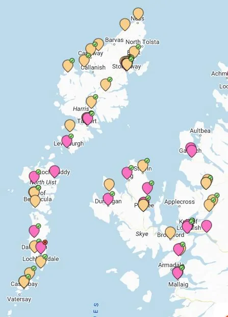

There might be a queue.
Watchout for overstay fees (45 - 90 mins might be your max charging session).
Looks to be around 16 fast (11kW - 22kW - beige) EVSEs across the western isles and a reasonable amount of rapid (50kW - Pink)
Porsche Taycan Roadtrip in Scotland - Looking for tips 1741168278484-eu
If things are as 'tight' as they appear then make sure you have a 3-pin plug capable mobile evse - 0.1 mile / minute - plenty of time therefore to take in the views...
