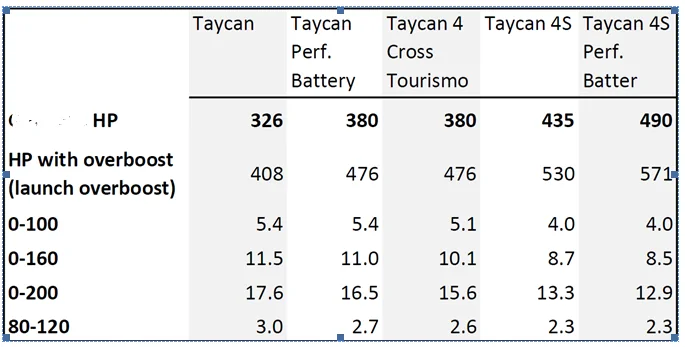

The real world driving difference is notable. I have just looked at the stats which show the 80-120kmh figures as follows:
RWD = 3.0s
RWD PB+ = 2.7s
4S (either battery) = 2.3s
If correct this would make 'overtaking' for the RWD PB in between the RWD and 4S.
That said, the RWD will be the lightest and may corner and handle better and be the purists choice.
Ideally someone would do a track test on two similarly specced RWD with each battery.
Porsche Taycan RWD Power/Weight vs Accel Anomoly 1651862655911
This is something I put together with data I got from german website. In case it helps. I could not see all this on the same table previously.
