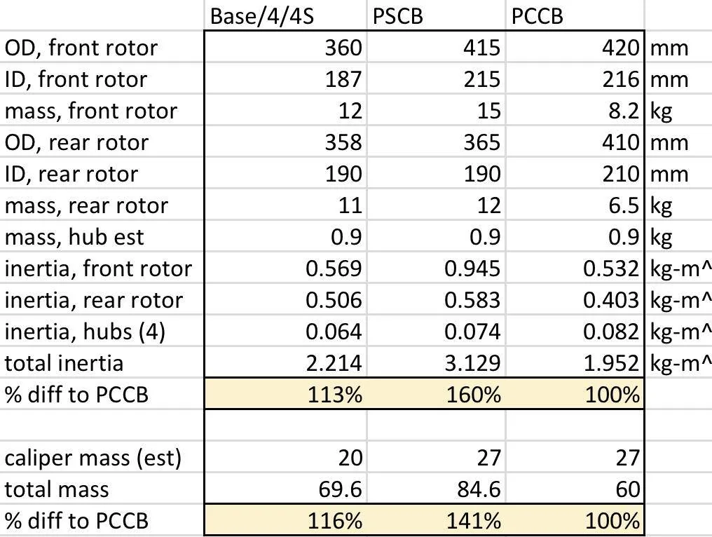

Weight: standard vs PCCB brakes

Nice analysis, Dave. Just to be clear, FWIW, I didn't specifically refer to PCCB's in my last post, or any brake type for that matter. My primary point was actually with regard to the 90% regenerative braking assumption relative to how I drive.
As you mention, it's true that braking is dependent on the grip level of your tires. That doesn't necessarily mean, however, that every brake system is able to take full advantage of the ultimate tire grip available.
Also, the rotor material itself isn't the only difference among the Porsche brake types. Rotor size, brake pad size and composition, caliper construction and number of brake pistons are part of the equation. There's a significant difference in brake swept area which may have an effect on the brakes being able to extract maximum stopping performance from the rubber under all conditions. While it's true that ABS cycling, reaction time, road conditions etc. are extremely important, it doesn't mean that, all else being equal, the inherent performance of the brakes themselves isn't a factor.
Bottom line, we can discuss this all day in a subjective vacuum. I've no doubt Porsche has done comparison tests of the different Taycan brake systems on equivalent vehicles on various surfaces. My guess is that there would be measurable differences but, as I said, I'd love to see the hard data to either confirm or disprove that assumption.
