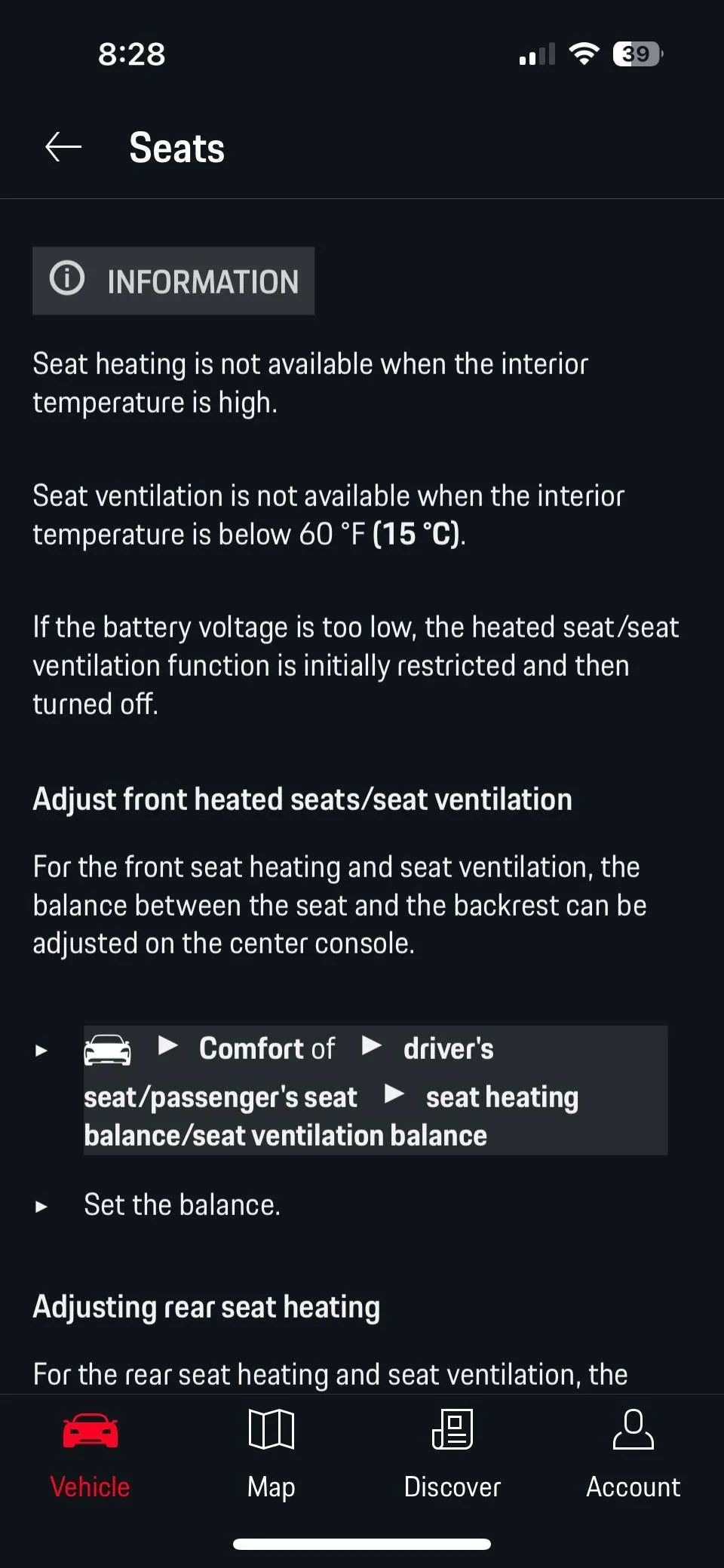

Went looking in the manual. Apparently it is based on interior temperature . Interesting it states temperature for ventilation but not for heated seats.
