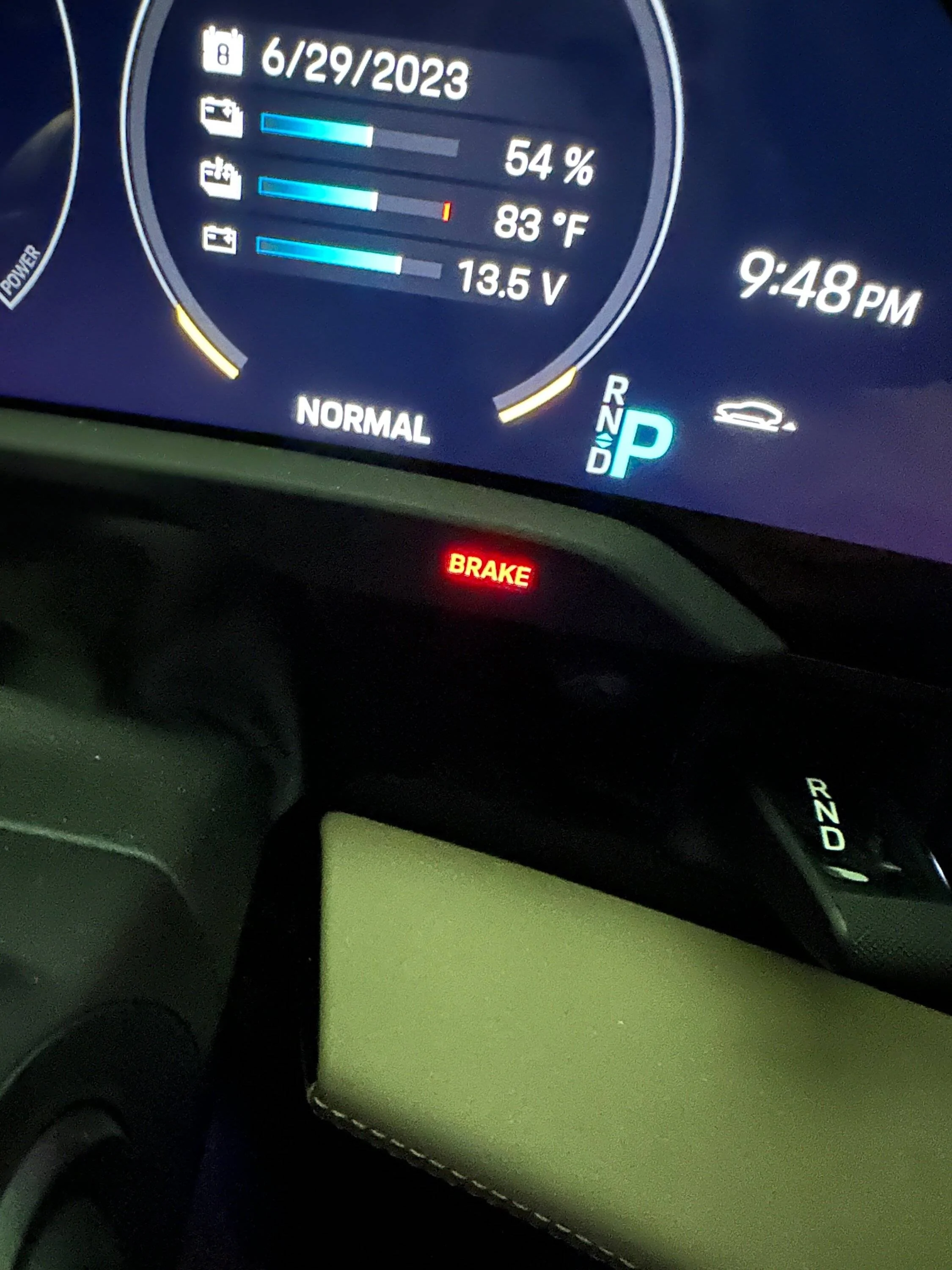

Just returned to my 22’ Taycan after an 8 week trip. HV lost 1% over the period. Checking the app, it stayed at 48% for the first 6 weeks and only in the 7th week saw the single percentage drop. 12V went from 13.5V to 13.2V. I had checked the app 1-2 times a week and in the last 2 weeks installed the iOS widget so the frequency may have been a bit higher. I was worried a bit because the app status would never connect and be either gray or red dot but the SOC still seemed to update fine.
Meanwhile, the Taycan’s gas guzzling garage mate’s 12V battery did not fair so well and needed a boost.

This is hard to reconcile with my experience.People theorized that checking the application might be responsible for the significant loss in my HV battery this obviously not the cause of the loss.So what is?I am stumped
