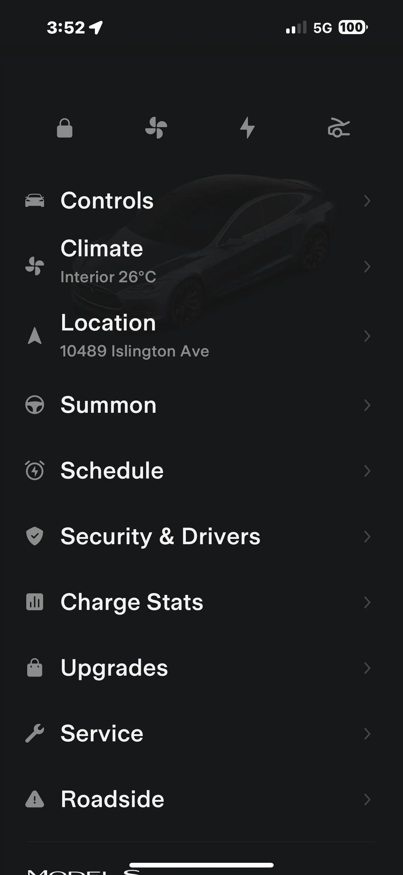

thanks that’s a good idea. I don’t see chargers listed in the app, maybe it’s different here in Canada?
Porsche Taycan (Super)Charging the Taycan IMG_6913
If you take the risk to dl the tesla app, you will find some super chargers that can be used with CCS ports. There are precious few in the eastern us.
