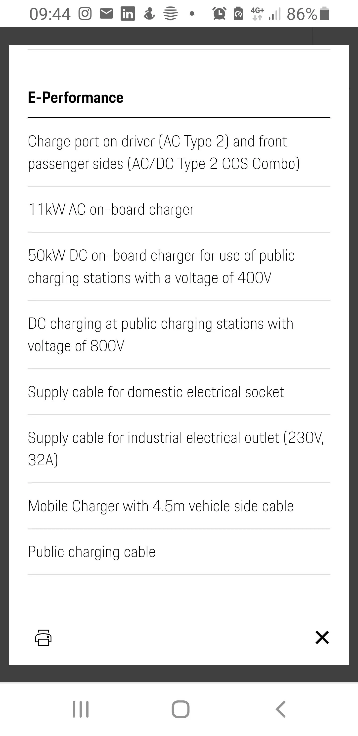

You should have received (as standard equipment)
- Porsche Mobile Charger Plus
- 2 supply cables
- 1 Porsche Mobile Charger Plus cable to connect to the car
- Potentially a public mode 3 cable for untethered AC public charging locations
To be precise go to the configurator and look at the standard specification / equipment tab at the bottom of the page and it will be detailed there under e-performance.
Screenshot is for UK but yours will be similar.

Where are you from? Profile says UK, but you installed a NEMA 14-50R?
It comes with Porsche Mobile Charge Plus as standard when new, but who knows if purchased used. I think of it kind of like a second key where it may or may not be included, depending on the previous owner.
There are a couple of threads on here about travel equipment you can search.
