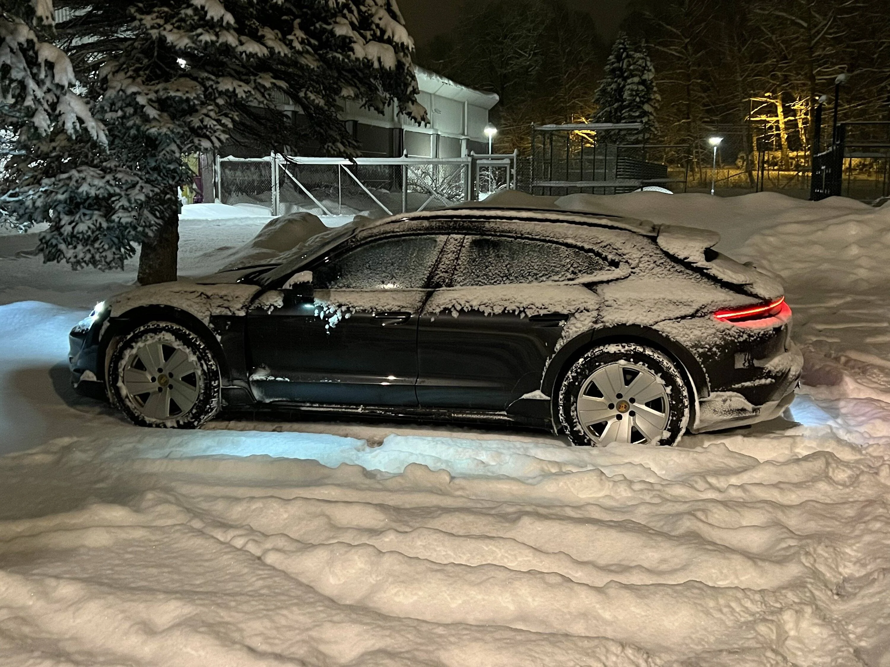

Looks like you have all the power you need for now!
