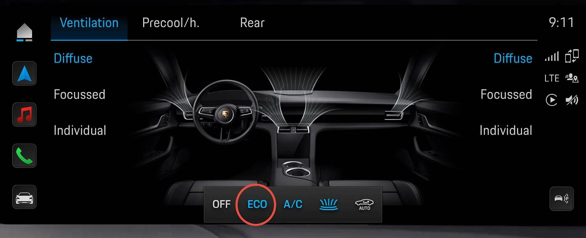

Are you driving in “Range” mode when this happens? The A/C defaults to “economy” in that mode and is poor at heating or cooling anything.
Porsche Taycan Taycan air conditioner blowing luke warm air IMG_1259
