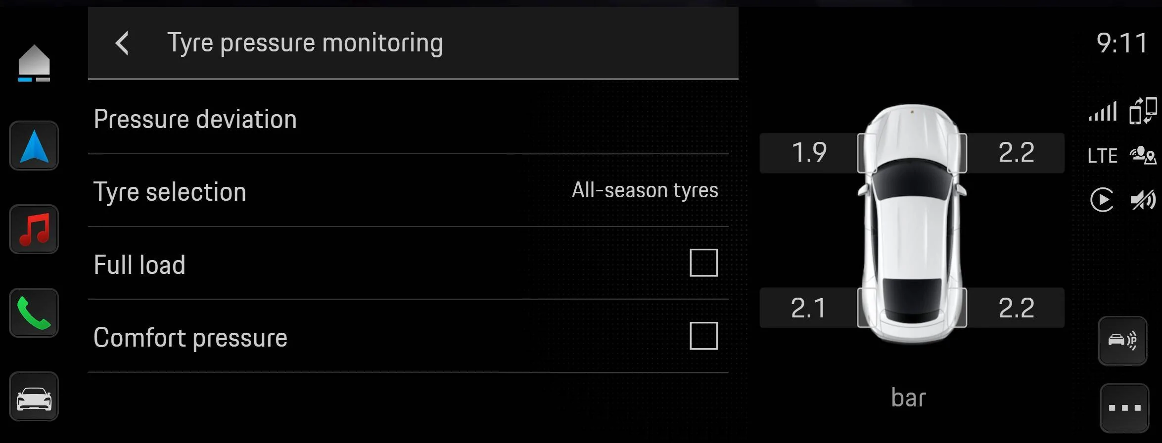

If you enter the fact that you are using winter tires in the PCM TPM settings, it will tell you the expected cold tire pressures, then continuously monitor the tire pressures to let you know if a particular tire needs more or less air. There is one option you have, "half load" vs. "full load", which changes expected tire pressures for your car.

In case you cannot find it, it's under Vehicle Settings -> Tire pressure monitoring (screenshot from the PCM emulator)
