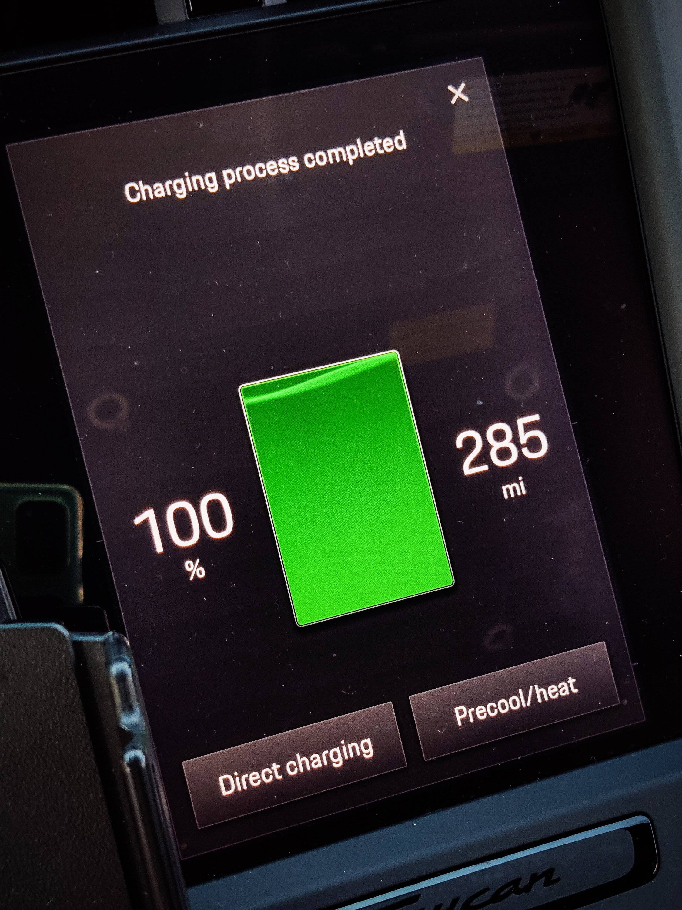

Pre update I got a max estimated range 278 miles, post update latest max range estimate 285 mi. Minor improvement:
2021 Cross Turismo 4S with 20" Turbo Aero wheels.
I have to ask but was your AC on normal, eco or Eco Plus and was it on the same setting when you did the comparison?
All same settings for direct comparison, I know how changing AC or drive mode settings will change range estimates
