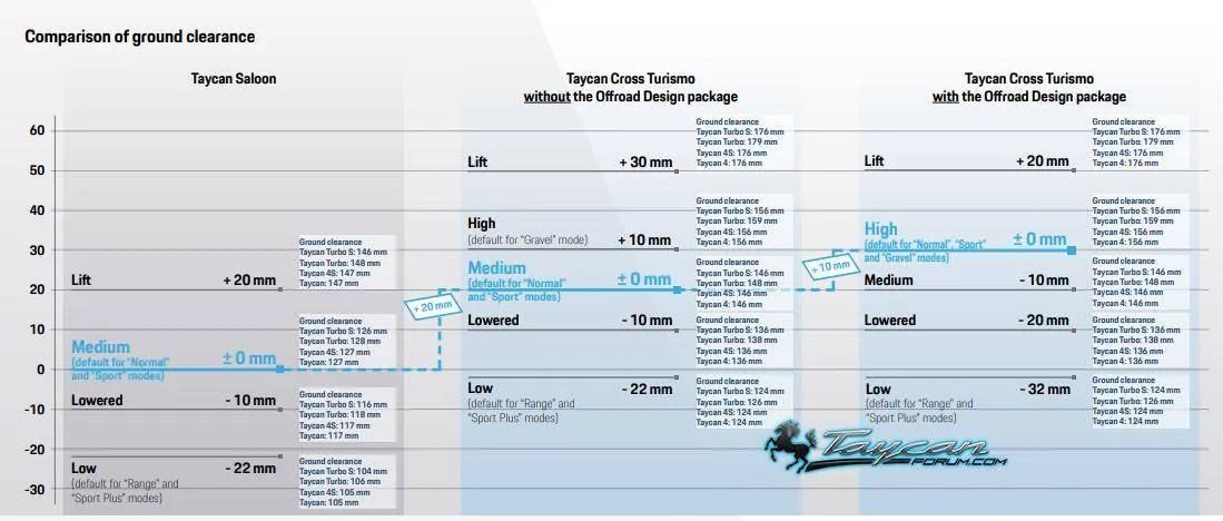

Actually, it is 19mm between Sedan 4S and CT4S w/o Offroad Design, but my CT has the Offroad Design package so the difference is 29mm so not small at all, at least according to this:
Porsche Taycan Taycan Sedan vs CT (4S) Taycan Cross Turismo ground clearance heights with without Offroad Design Packag
Taycan Cross Turismo ground clearance heights with without Offroad Design Package.jpg
I lowered my CT for a while with about 19mm, so Normal becomes low and low becomes deep, deep well... deeper :). But in the end i removed it again because i do like the comfort of the bit more higher stance. I constantly switched to higher mode anyway. The looks of the lowest mode with the lowering set looks great though ! much more sedan
