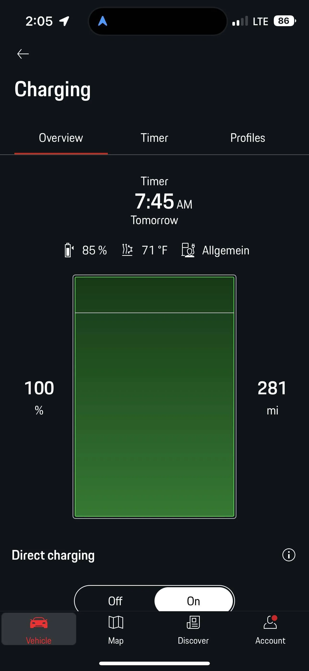

We left at 2 pm, with the car freshly-charged at home to 100%.

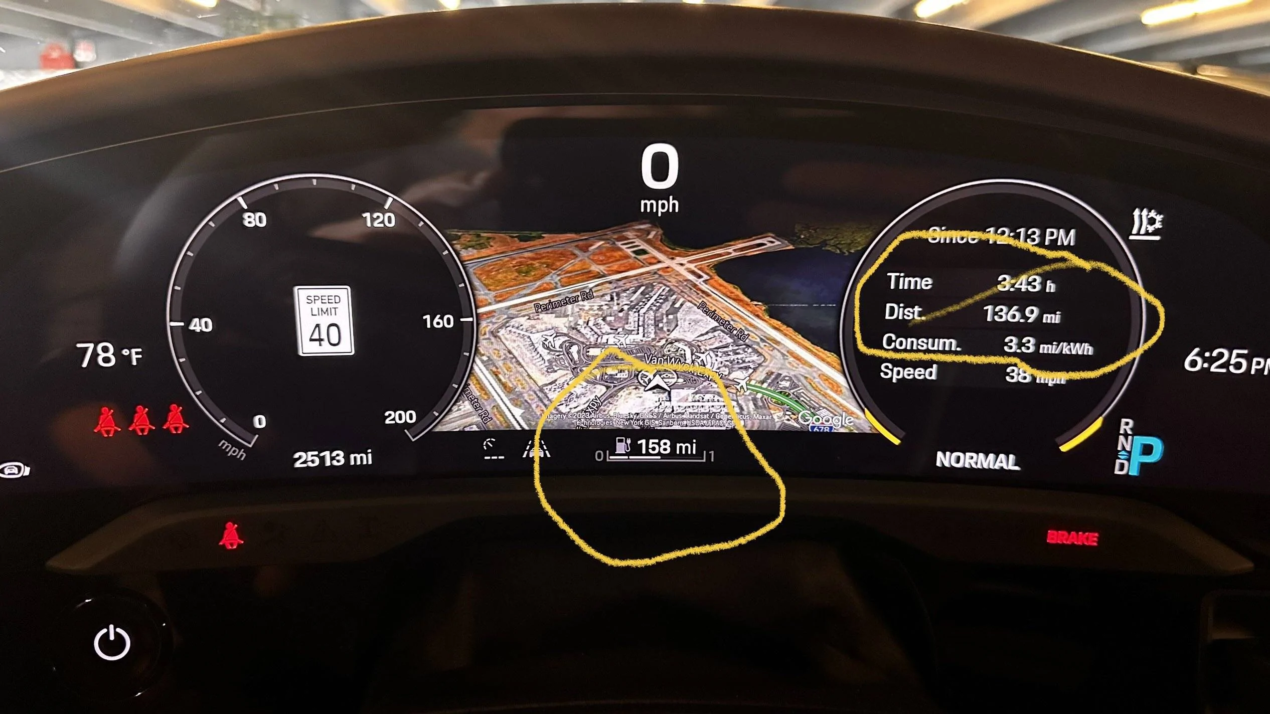

^^^ That's the status upon arrival at JFK (photo taken just prior to departure). The trip timer seems to have started when I powered up in the garage to verify the Individual Mode settings were saved correctly. Miles traveled plus projected range indicates about 295 miles available in ideal conditions, with a fully-loaded car.

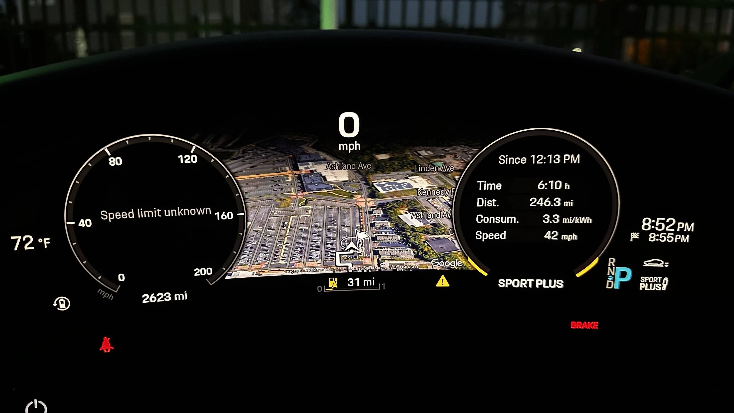

Actual + projected range dropped to 277 miles by the time I got to the charging station. This includes about 50 miles of 85 m.p.h. driving. I arrived at 13% SOC, plug & charge worked flawlessly, but it seems EA was throttling output at the 350KW dispenser to half rate, because the Taycan never got more than 175 KW, despite entering the charger as the destination to pre-condition the battery, and even selecting Sport Plus mode with the car powered on while charging.
Even at the reduced charge rate, by the time I finished using the restroom at the co-located Wal-Mart, and unsuccessfully looking for my preferred soft drink they can't seem to stock anymore, I returned to the car to find it was at 71% SOC in 21 minutes...not even enough time to sit down at a nearby restaurant to eat dinner.

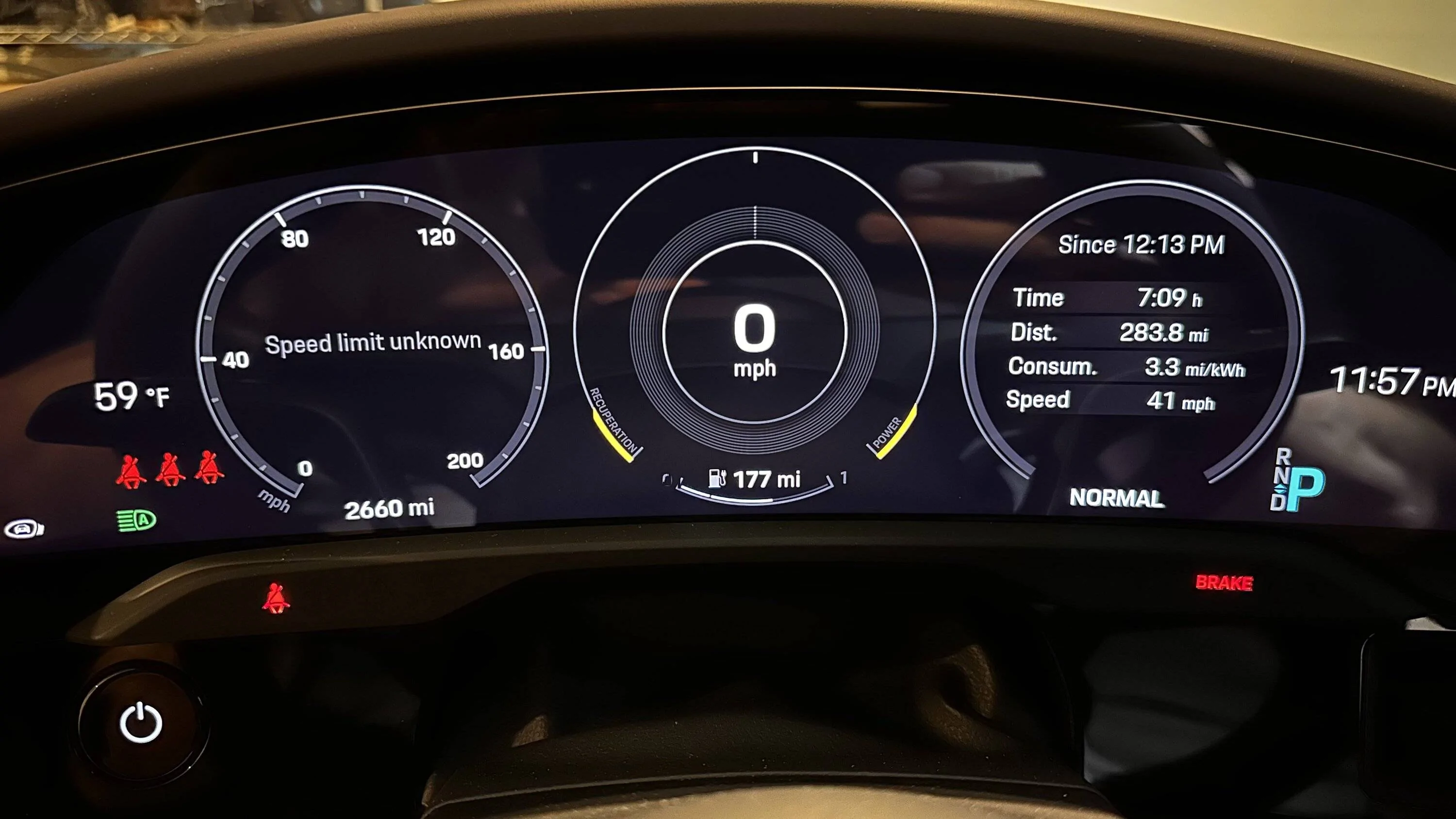

Anyhow, after stopping for dinner, and sending back the undercooked chicken for remediation, I arrived home at 11:15 p.m. with the following round trip numbers:
I wasn't expecting the Taycan to perform this well on a 6 hour drive. I thought we'd have to take our e-tron to fit all the luggage, but we had no issues with the Taycan utility for this mission. I've read reports the Taycan tends to exceed EPA-rated range, but it's nice to experience it first hand...without having to resort to excessive efforts to extract range from the vehicle. I'm aware it will not perform this well in less optimal conditions.
