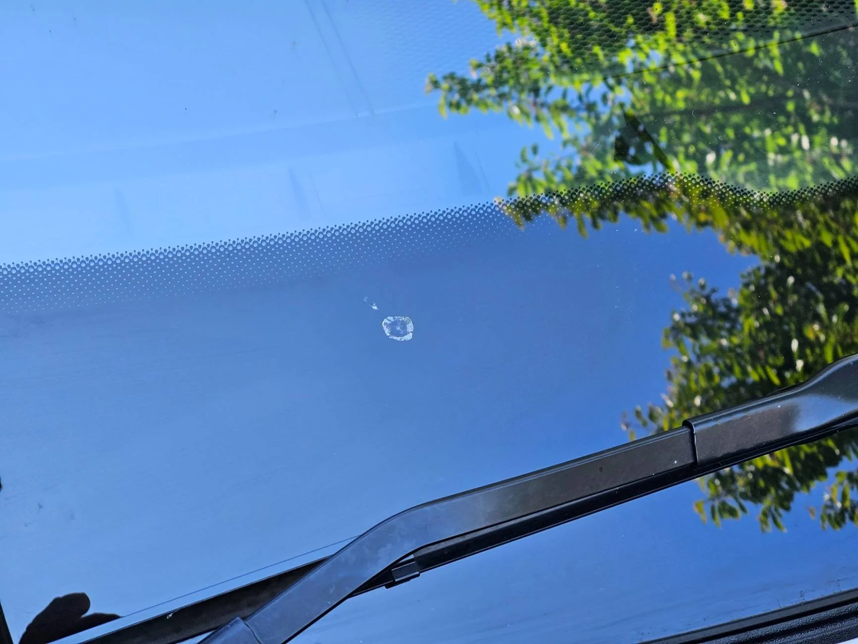

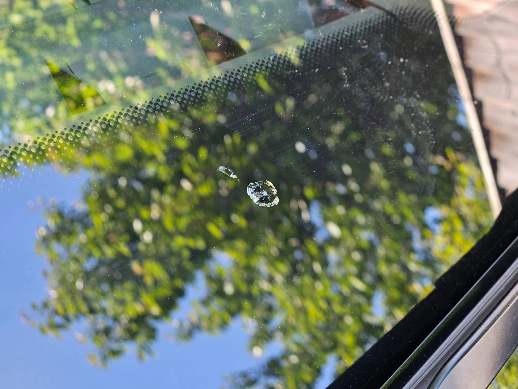

I’ve recently had a stone hit on the lower part of my windscreen.
There is no detectable surface damage but the hit must have affected an inside glass layer and caused some visible ‘discolouration’ (loss of vacuum?) – see pics
The damage is out of sight from the cabin and can only be seen from outside.
I have "Option VW6: Thermally and acoustically insulated laminated glass, top-tinted windscreen, privacy glass at the rear", on the vehicle.
  • Can this ‘damage’ be repaired without replacing the screen? – i.e. a smart repair?
  • My motor insurance species windscreen repairs by Autoglass – could they technically handle such a repair?
  • Would it be better to get my local Porsche dealership to carry out a repair?
  • I’m aware that a new screen is pretty expensive (£2000+?) given its specialist design and construction.
  • Im reluctant to let anyone loose on this until I've researched or taken advice.
I’d appreciate any advice, experience or feedback from anyone who’s been through this process.
Thanks in advance.

My suggestion is to take it to the nearest glass specialist as soon as possible, because I believe this can be cured just by applying some glue. I have had similar cases fixed with good results, I mean so that you can barely see the damaged spot afterwards.
And why asap, this kind of damage will very easily extend to a proper crack

Good advice, get it looked at asap.
However, i think if it's in the black border (or whatever it's called) then repairs become more problematic. I had another car's done last week and the auto glass website asks for chip locations etc to work out if its fix or replace and one of the zones is the black edging.

If the chip is less than a 5 pence piece in diameter, then it could be repairable, however as @BigBob says, as its in the black border area this may be a problem - it certainly would be visible after repair. Thinking about it, then need to get a piece of equiment on the inside of the glass to inject the glue, so I dont think they could repair it.
I had a (much bigger) stone chip in the exact same area. I had the exact same concerns about getting the right glass, as I have the same option as you.
I did eventually go through AutoGlass and insurers and everything was absolutly fine. The replacement was identical Saint Gobain class, with the same part codes (I checked before install).
All went well.
The only compaint I have is that on the new glass they didnt properly get the air out from around the rain sensor (top middle, behind rear-view mirror) and it doesnt look neat - I should have spotted before collecting it - so just double check that!

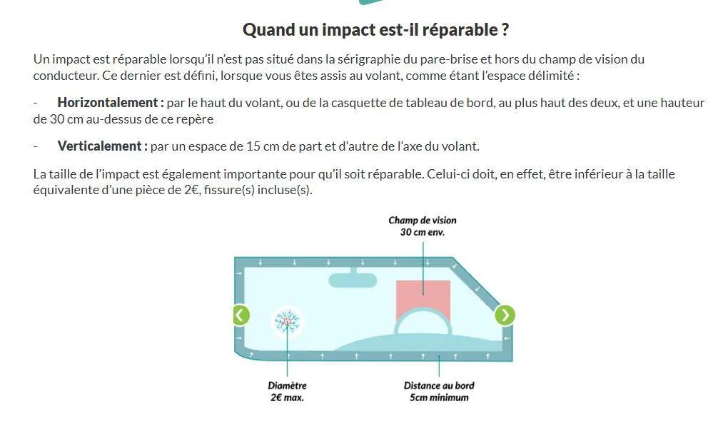

En France, on ne peut pas réparer si le coup est dans la zone sérigraphiée, car il se trouve dans la zone collée, moins flexible. J'en ai un plus petit, mais plus profond, et je n'ai rien fait, par exemple.
Donc la première solution est de changer votre pare-brise et la deuxième est de contrôler tout début de fissuration
Peut-être qu'au Royaume-Uni, les réparateurs de pare-brise sont autorisés à injecter de la résine, je testerais donc la réparation pour stabiliser le coup car il semble être au-dessus de la zone de colle du pare-brise, mais la pression pour injecter de la résine pourrait entraîner une fissure.
Le mien n'a pas bougé depuis 1 an et demi, mais à Bordeaux il ne fait pas trop froid et mon Tacan dort dans mon garage.
