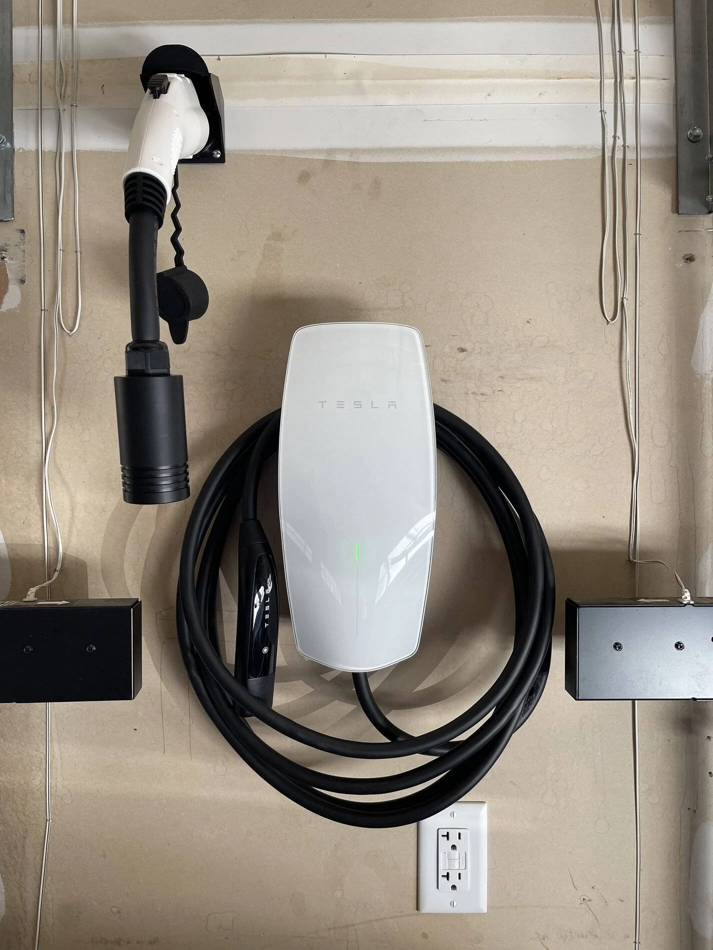

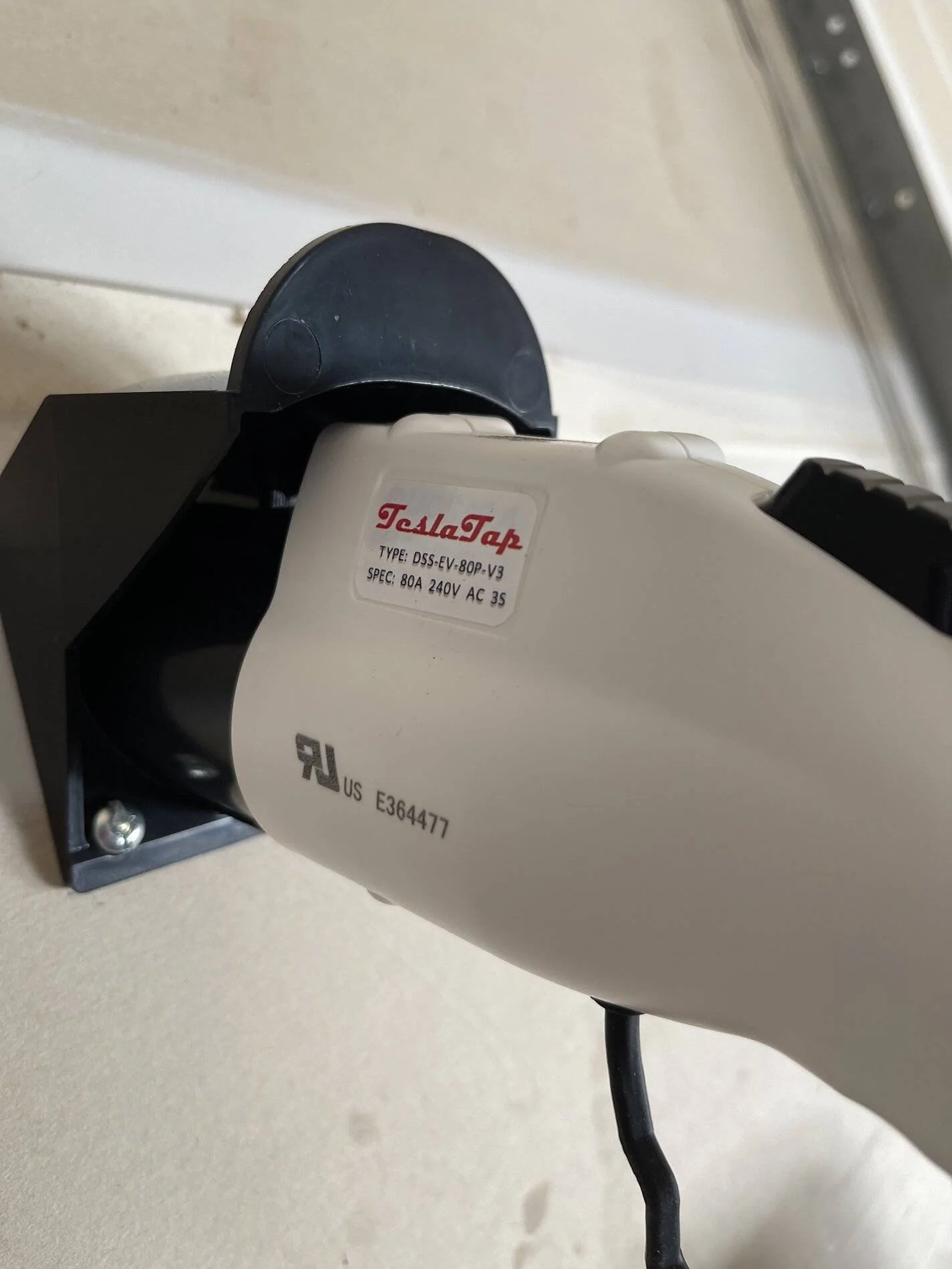

I currently use a Tesla Wall Connect Version 3. I also have purchased a Tesla Tap (80amp version). I have no issues charging. I prefer my Tesla Wall Connect over the Porsche option. I prefer the size/form factor of the Tesla, the ease of use, and the reliability of their charging system.
Porsche Taycan Tesla chargers 6D53F39C-30EE-425D-8B6F-351BE8600320
Porsche Taycan Tesla chargers AA5C3993-1F24-4389-96D5-7D1A03D73B36

^This^
Its different in the UK than the US, so suggest OP read these only.... to avoid confusion.
I agree. I didn't realize OP was in London. Definitely get the Tesla Tap appropriate for your power schedule in your country of origin.
