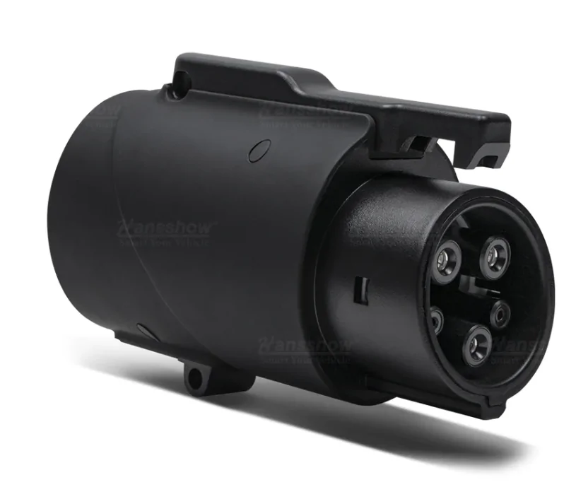

Updating this thread. I picked up this adapter on Amazon to test it.

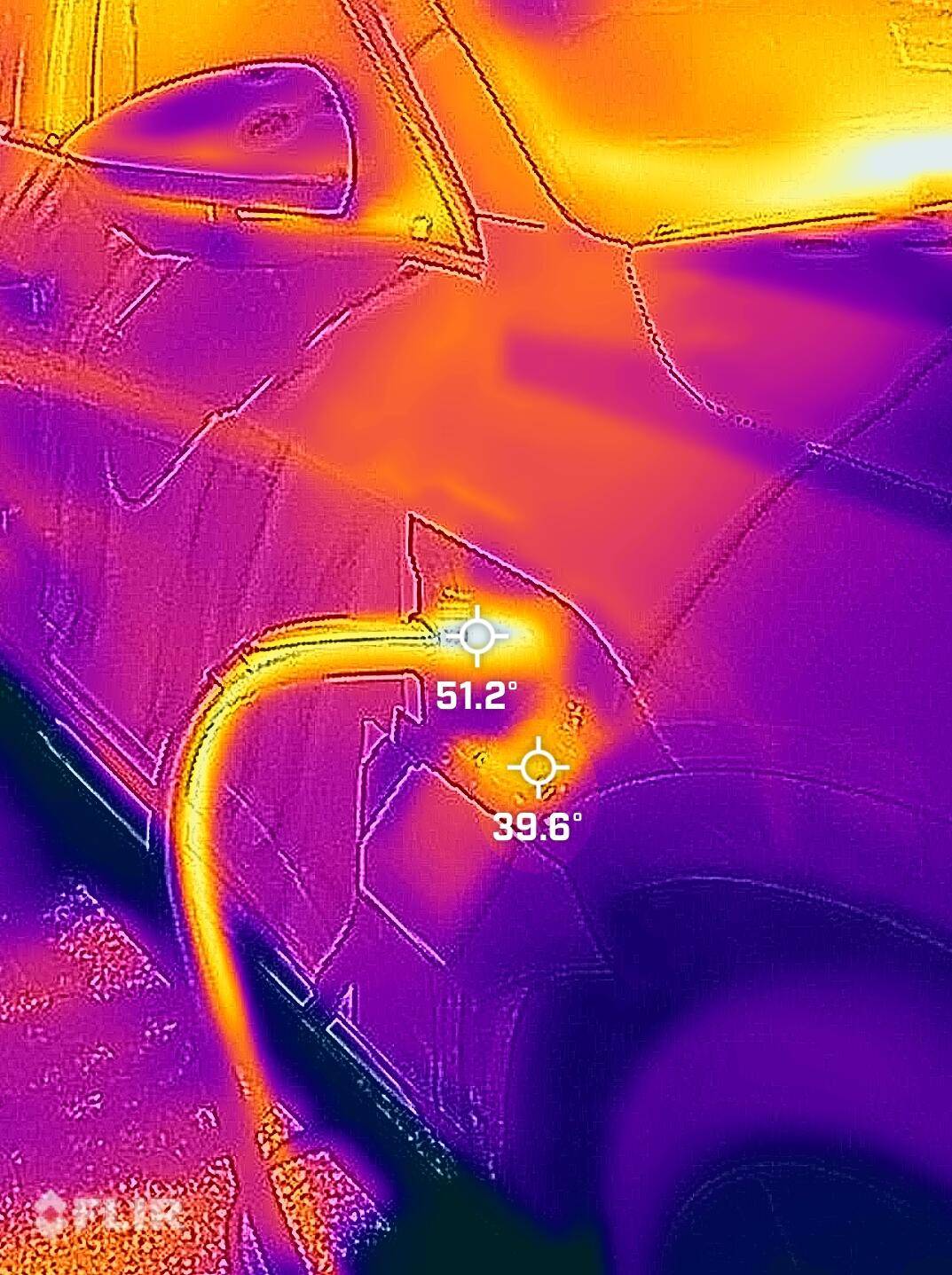

It works just fine, I tried it out at 80A for a couple of hours on a Q8 eTron (which has the exact same onboard charger as my Taycan). Audi reported 17.2KW which is about the same as my Taycan reports on a native J1772 at 80A. It was 21C outside (70F), the adapter didn't get warmer than the Tesla handle (it actually seemed a little cooler). Confirming with the FLIR after 2 hrs at 80A or so.

I used it few times by now. This is by no means a thorough test, nor a teardown, but just using it a few times right now, not bad at all for $61. I plan to keep it for travel charging with the eTron.
PS> Didn't try on the Taycan as my Taycan didn't need long charging sessions recently.

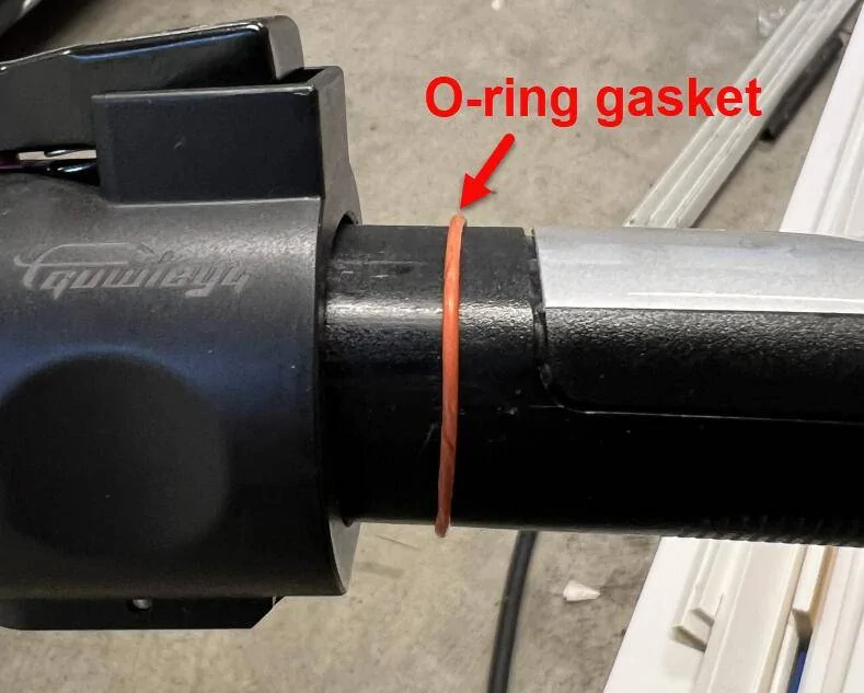

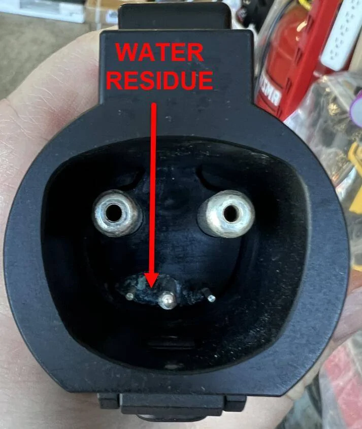

Quick update on this. I have been using this adapter for a year and half now, charging an eTron with 19.2KW charger daily at 80A. No problems. A while back (Feb 23) I realized after inspecting it few months in, that there was some water incursion due to sometimes charging outside in a rain.
Porsche Taycan TeslaTap alternatives? 1731217940949-lh
There was no gasket there, like there is on the J1772 side. TeslaTap doesn't have one on the J1772 side either. So, I added one, by simply putting an o-ring gasket around the NACS handle like this (shown before I pushed it into the socket).
Porsche Taycan TeslaTap alternatives? 1731218087209-kk
Working well to-date, I inspected it recently (so 9 months later) and it worked well, no signs water incursion even after many rainy charging sessions. Still charging daily at 80A (19.2KW) without any issues.
Happy to day, inspected it recently (so 9 months later) and it worked well, no signs water incursion even after many rainy charging sessions. Still charging daily at 80A (19.2KW) without any issues.
