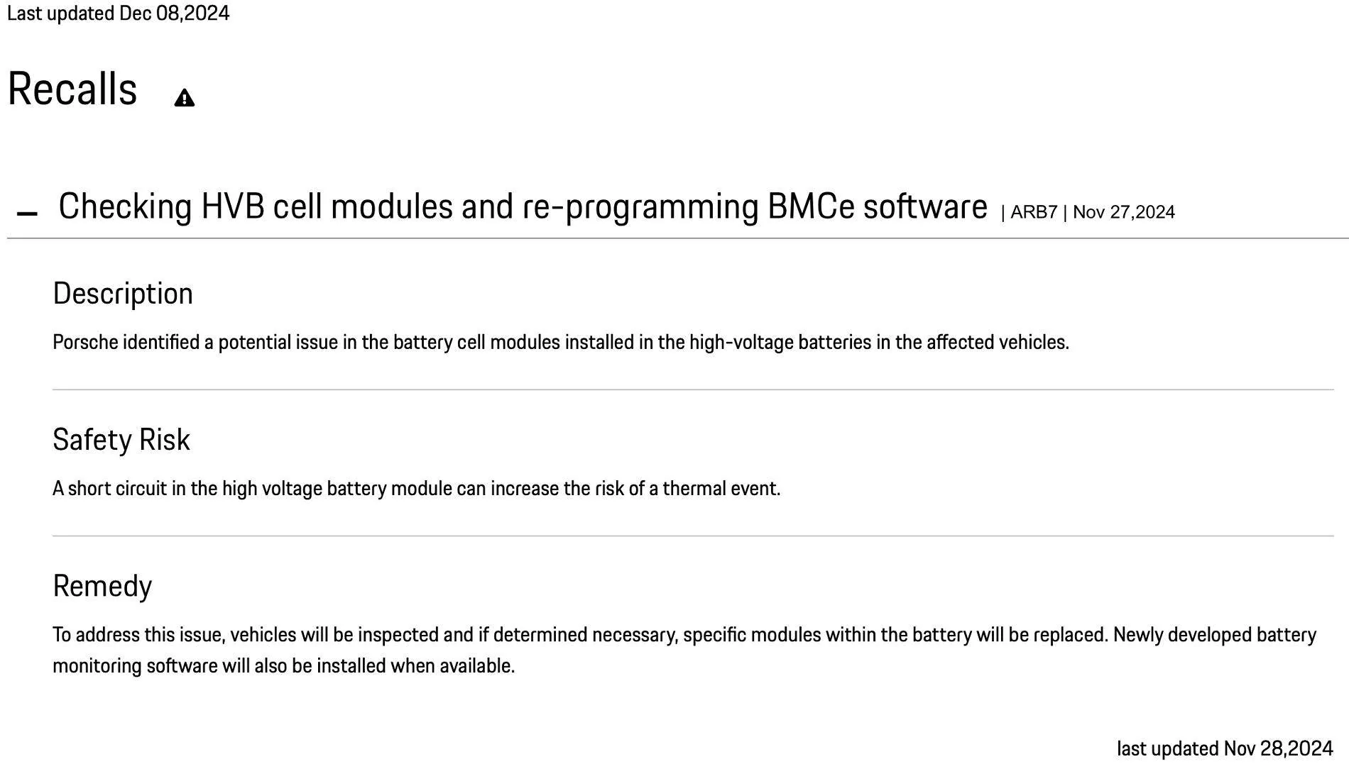

The (expected) ARB7 recall letter comes (my THIRD open recall...)

We are all screwed. I'm not sure even Porsche Germany knows what is going on with their batteries. I Received ARB7 notice in the mail a couple of days ago. Seemed to make sense as I have data sharing enabled. Dropped my car at the dealer today for A/C and suspension issues (battery seems fine and was not why I was taking it in). SA checks his system and ARB6 is open for my car. This is also the recall shown on the NHTSA website. Curious why the notification letter would show ARB7 when Porsche and NHTSA think it's ARB6. Also new, and not shown anywhere that I can find, is WRS1. It could have been WRS0 mentioned by @rs38 but I'm reasonably sure it was WRS1 (two different WRS recalls depending on the market?). Some kind of testing of the battery and producing a VAL. According to the SA I either get demoted to ARB5 if there is a problem detected or upgraded to ARB7 for the software update some time in the future. The testing, according to the SA, involves telling the mother ship the car is at the dealer and then a remote diagnosis is done. He was pretty sure the techs didn't do anything for this recall except park the car where a satellite could see it. So, at least in my case, Porsche seems to have sent out the wrong recall notice. Got ARB7, should have been ARB6. Is any ARB7 recall notice valid? Does data sharing really do nothing? Why does my car have to be at the dealership for Porsche to check remotely? When did the WRS recall come out. When will the pain end?
"So what happens if there is a problem found when running WRS1?" I asked. "Uh, hope that doesn't happen because you will be without the car for a long time. It's a mess."
So comforting. Wrong, or at least inapplicable, recall notices being sent out. New recalls on a weekly basis and apparently no way to deal with whatever batteries have a problem on a timely basis.
Just posted on NHTSA: WRS1 is the workshop campaign for VAL check for battery state of health for vehicles assigned to ARB6 Recall.
https://www.taycanforum.com/forum/t...for-arb6-recall-dec-5-2024.23476/#post-358189
