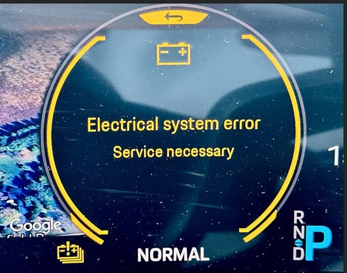

ARB6 Software update installed last month. Initial evaluation after install was "all looks good". Two weeks later, I got a Yellow Electrical Warning and I am now waiting for two cells (9&13)(backordered). It looks like the software is doing its job. Such a shame, my range on my '22 CT4 is 235 miles at 80%.

Could you cover steps taken since you got the Yellow Electrical warning?
Did that warning state "inspection required"?​
Did dealer have to look at your car to determine which modules needed replacement?​
Is the module replacement going to be done at your dealer, or will your HV battery be sent to another facility for repair?​
Did you have the option of keeping your Taycan until the parts arrive, or is it waiting at the dealer?​
How long has it been since the dealer visit? When is expected resolution?​

I took it to the dealer. The lead tech ran diagnostics. It showed problems with Module 9 (I didn't ask what issues it showed). He sent the data to Germany for a readout and Porsche came back and confirmed Module 9 and told him he would need to replace Module 13 also.
The repair will be done at the dealer facility. The modules are on back order it could be end of Sept before they get to the dealer.
They are keeping the car. While it is not a RED warning, it could turn into one (Murphy's law). Once they diagnose, they accept liabilty for the car and keep it. I don't need to be driving back and forth across the Chesapeake Bay Bridge and have it fail on the bridge.
Dealer dropoff and diagnosis was 10 days ago. Possible resolution by end of September.
I really like my CT4. It is a very good spec and not like anything I have not seen elsewhere CPO'd.
I'm in it for the long haul. Hopefully these cells are the only bad ones.

Was there any unusual charging event you can recall that may have triggered the error?
E.g. high speed charging to 100%; low state of charge; or some other unusual charging event?

Nothing unusual.
95% max charge twice on Level 2 charger at home. CCS charging settings in PCM were set to optimize and never exceeded 124 KW/H and only to 80% max.. 95% of charging was on level 2 to max and normally set to 80% max with the exception of the two times to 95%.
Prior to software install, no electrical errors ever.
