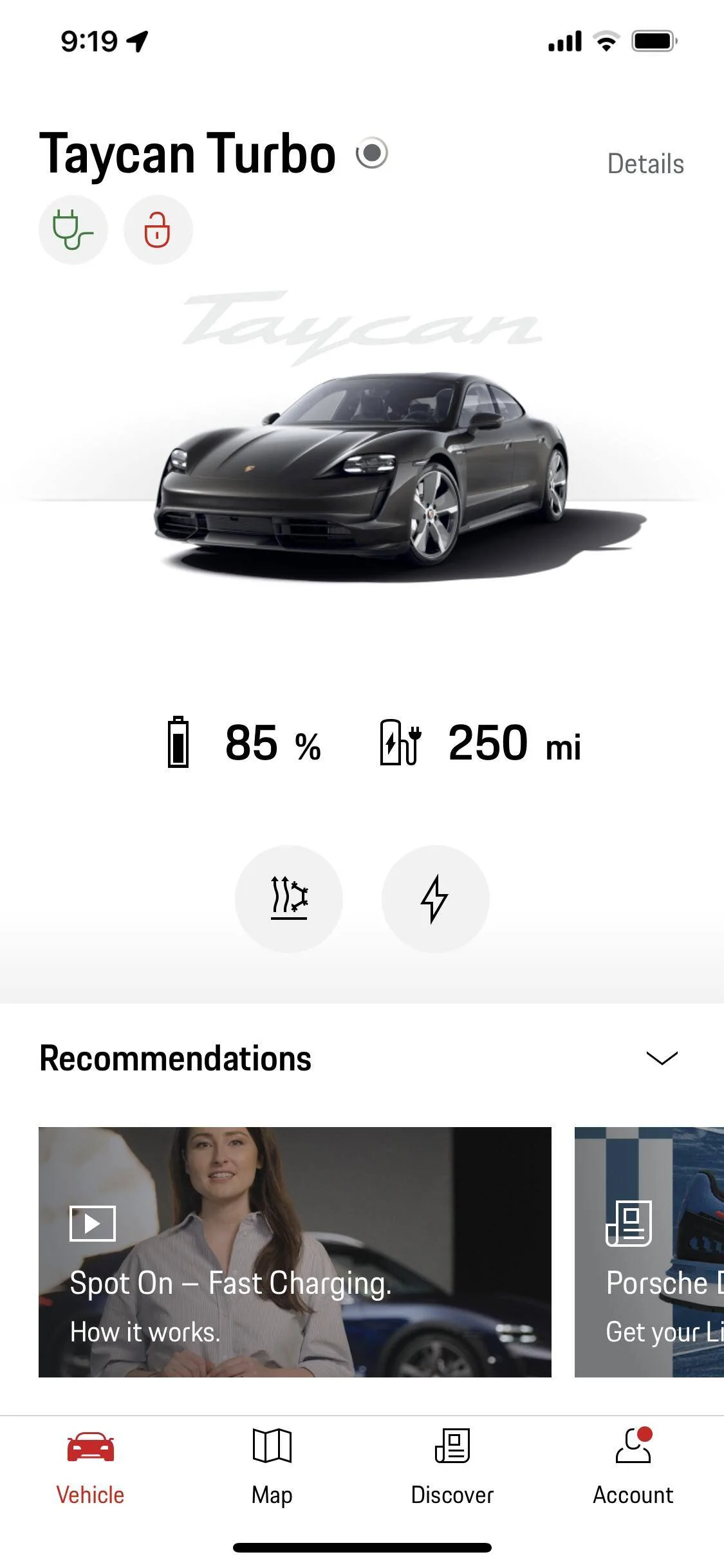

Unbelievable!! How on earth you get 258miles on 85percent charge? Mine is Turbo S and the maximum I get on 100percent charge is 208miles!

Those high temps also cause HV SoH to decline faster than Taycans locatedin more moderate climates, per @ciaranob .

Hot weather indeed not a friend of EV’s but differences in SoH with cooler climates usually a matter of a few percentage points.
That said I still consistently get 250-255 guessometer ranges at 100% SoC in summer months and my SoH currently averages between 88-89.5% after 2.5 years. Of course all it takes to take 20-30+ miles off that guessometer range is to do a few back to back high speed highway road trips! :)
