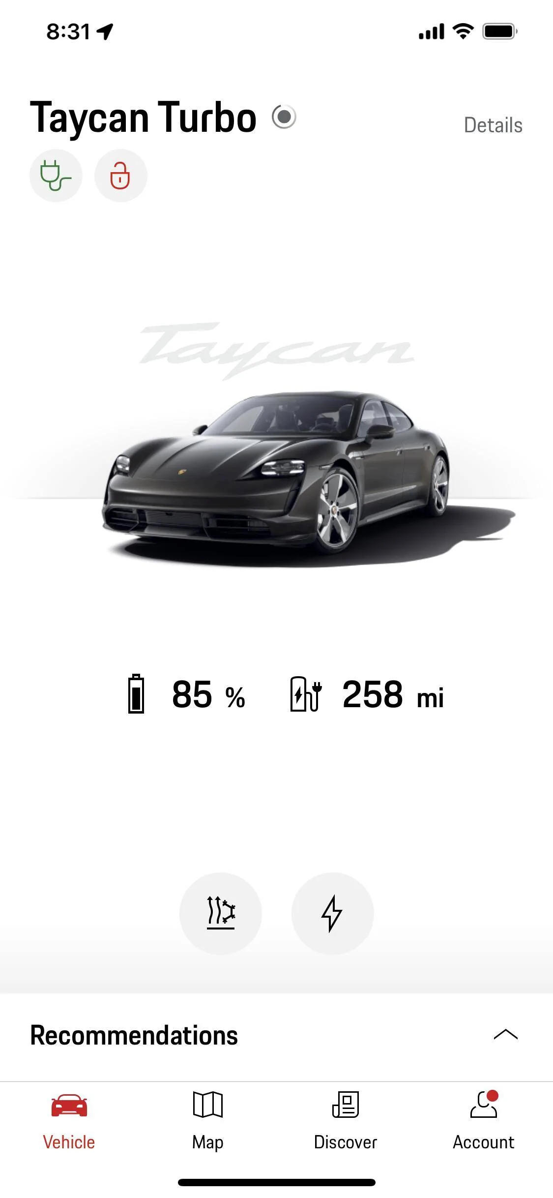

The entire battery was replaced, obviously under warranty. US cost at dealership $53,000….
update: I’m very happy with the new range which is consistently about 300 miles! Below is a screen shot of current range; it’s about 85f in Houston today. Observed range is very close to the forecast.

This is some good range. I just charged to 85% and I am new at 1000 miles and I am showing 237 mi at that level. I understand that this reported range improves with more miles.

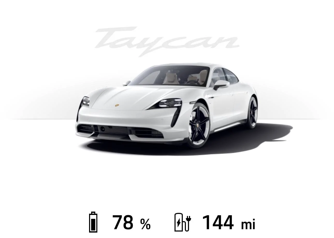

wow nice range I only get about 165 at 85% wondering if my battery is shot too

Unbelievable!! How on earth you get 258miles on 85percent charge? Mine is Turbo S and the maximum I get on 100percent charge is 208miles!
